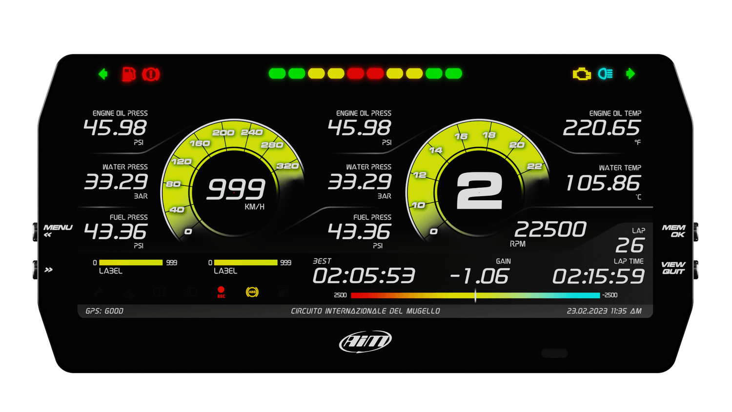

AiM MXT 1.3 10" TFT IVA Compliant Digital Display
The MXT 1.3 IVA Compiant (Individual Vehicle Approval) Dash features a 10" wide colour dash display offering great visual impact and is configurable to show data coming from your vehicle's ECU.
10" TFT display 6 alarm RGB LEDs
CAN output Configure data
AiM MXT 1.3 10" TFT IVA Compliant Dash Display
The MXT 1.3 has an integrated shift array, configurable multicolour alarms, drag and drop multi-page configuration, Wi-Fi and USB connectivity, GPS09 Module (optional), analogue and digital inputs, digital outputs, motorsport connectors, 4GB of internal memory, 1000Hz per channel sampling and support for over 1000 ECU connections.
The MXT 1.3 IVA Dash samples data coming from your ECU, the GPS09 Module, 8 fully configurable analogue inputs, 6 digital inputs, predefined math channels and a second CAN. Performance and data acquired can also be incremented adding up to eight expansion modules.

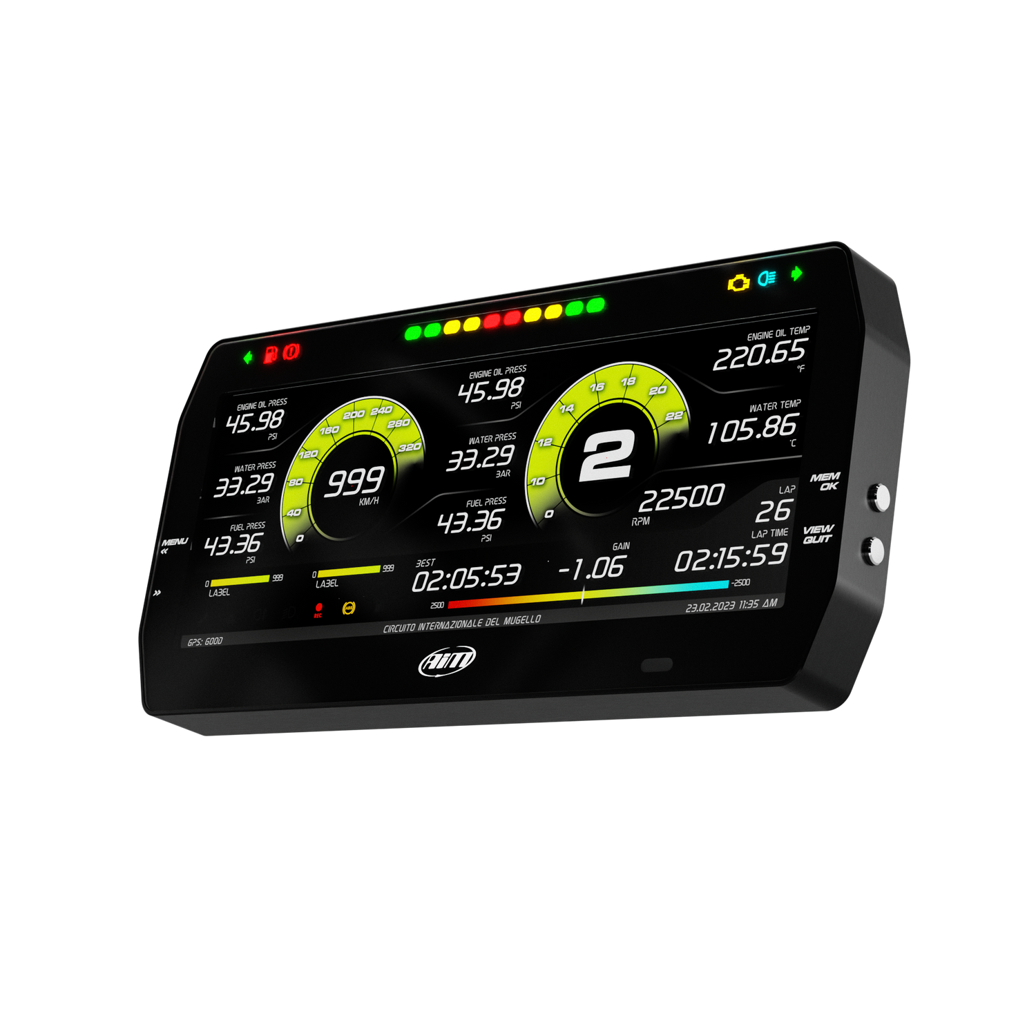

    • Display: 10" TFT
    • Contrast: 1,100:1
    • Brightness: 800cd/m
    • Shift Lights: 10 configurable RGB LEDs
    • CAN Connections: 3
    • Analogue Inputs: 8 fully configurable, max 500 Hz each
    • Digital Inputs: 4-speed input, lap signal, coil RPM input
    • Digital Outputs: 2 (1 A max)
    • Second CAN: Yes
    • Internal memory: 4GB
    • Body: Anodised Aluminium
    • Pushbuttons: Metallic
    • Connectors: 2  AMP connectors + 1 Binder connector
    • Power Consumption: 450 mA
    • Dimensions: 278 X 135 X 43.2mm
    • Weight: 1,200g
    • Waterproof: IP65
