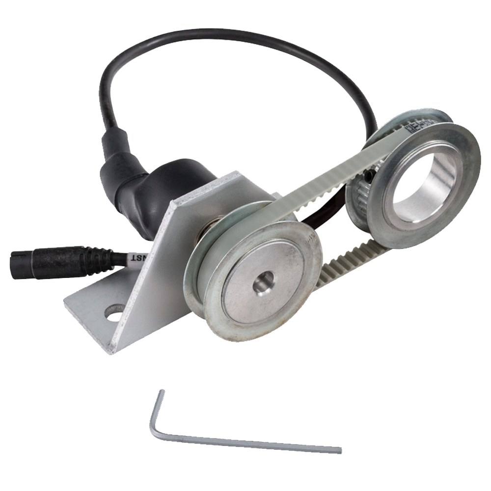

AiM Steering Angle (Rotary Potentiometer/Belt Type) 1 Rev Kart Sensor
The AiM steering angle sensor and bracket are suitable for use with all AIM MyChron kart dash/data loggers (this includes MyChron 5 S, MyChron 5 and MyChron 4, both single and two temp versions).
Measures & records driver steering inputs Compatible with MyChron 4 & MyChron 5 s
4 pin 719 male binder connector Optional patch lead
The sensor supplied with or without the patch lead required to connect the sensor to the MyChron expansion box, the standard method of connecting additional sensors to your system.
Measures and records the driver steering input using a sensor (rotating potentiometer) to measure the displacement between two points
You can see where then the driver is losing time due to steering angle, too much or too little at every corner.
Compatible with the MyChron4, MyChron5 and MyChron5 S
Connections
An optional patch lead is available to purchase with this sensor. The extension cable is for connection to the MyChron Expansion Box.
The patch lead needed for this sensor is the 712-719 male to female 4 pins and is available in different lengths from 50cm to 400cm. In the Accessories Tab.

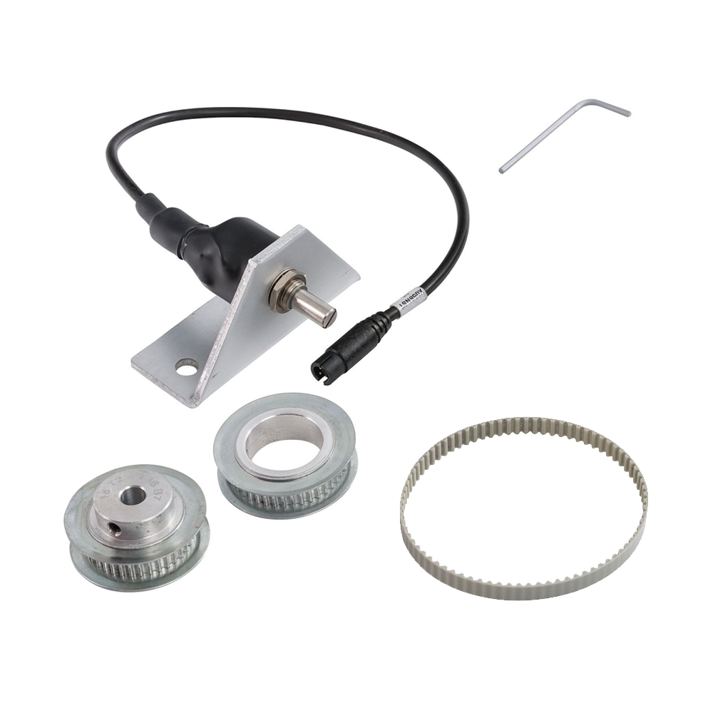

  • 1 1G Kart Steering Rotary Potentiometer
  • 1 Toothed Belt
  • 1 Allen Key
  • 2 Toothed Pulley
  • 1 Bracket

The AiM steering angle sensor and bracket are suitable for use with all AIM MyChron kart dash/data loggers (this includes MyChron 5 S, MyChron 5 and MyChron 4, both single and two temp versions). The sensor supplied with or without the patch lead required to connect the sensor to the MyChron expansion box, the standard method of connecting additional sensors to your system. Measures and records the driver steering input using a sensor (rotating potentiometer) to measure the displacement between two points
Connections
An optional patch lead is available to purchase with this sensor. The extension cable is for connection to the MyChron Expansion Box. The patch lead needed for this sensor is the 712-719 male to female 4 pins and is available in different lengths from 50cm to 400cm. In the Accessories Tab.
  • 1 Toothed Belt
  • 1 Allen Key
  • 2 Toothed Pulley
  • 1 Bracket
