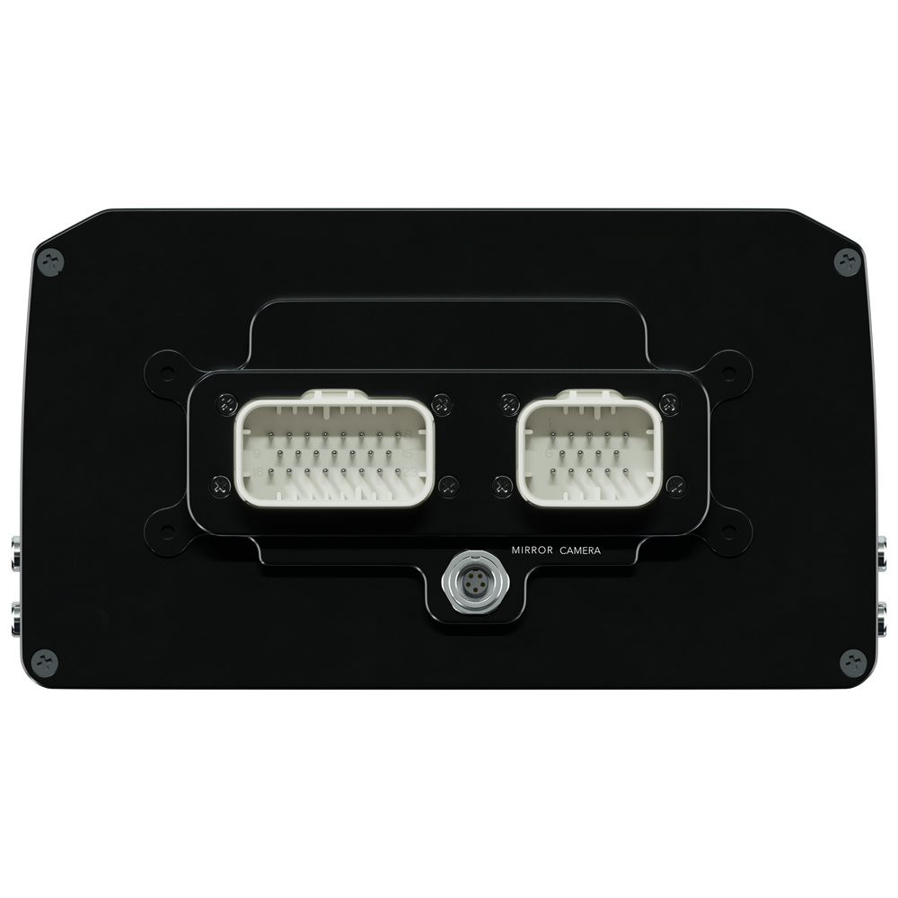

The MXP Strada features a 6" wide colour TFT display, offering a great visual impact. It is configurable to show data coming from the ECU, 9 axes inertial platform (accelerometer, GYRO and magnetometer). Eight analogue inputs, 6 digital inputs, pre-defined math channels, a second CAN and an optional GPS Module.
The MXP Strada is available with a choice of connection. Choose either the OBDII or K-Line CAN, depending on whether you want to connect to the vehicle ECU or OBDII port or directly to the ECU through the CAN channel.
Connecting the MXP Strada dash to your ECU is simple. You can sample and display dozens of channels straight from the vehicle ECU. This is usually the quickest and easiest setup, needing only 2 cable connections to the ECU instead of multiple connections to analogue sensors.
As well as the standard 14 pin wiring loom included in the kit with a choice of CAN or OBDII, K-Line the kit also comes with an additional 23 pin loom which has pre-configured connections for all the relevant electrical items in your vehicle such as oil. temperature, engine temperature, fuel level, sidelights, hazards, front and rear fog, handbrake, main beam, dipped beam and left and right-hand indicator. A speed sensor is also included in the kit to connect to this additional loom.

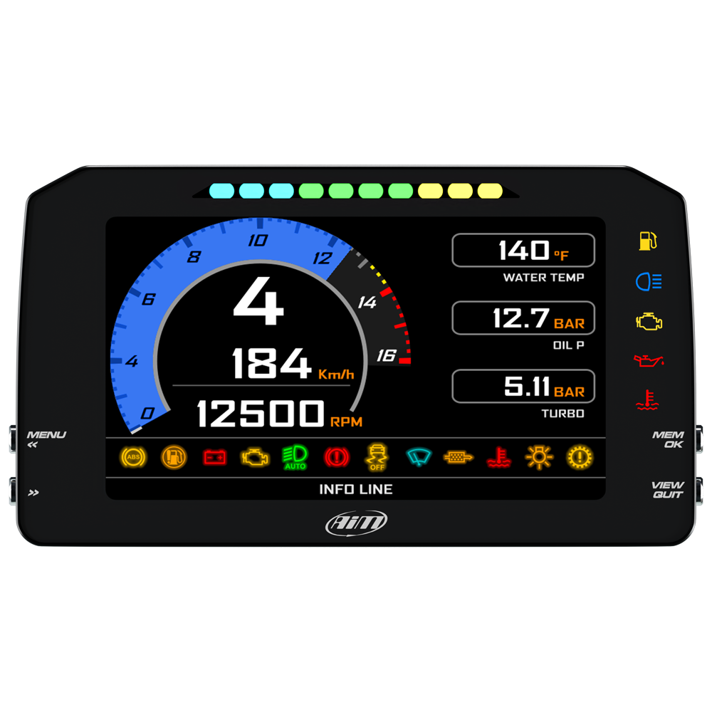

The MXP has a 6" high contrast TFT display. The visual quality is kept optimised by the ambient light sensor which keeps the backlight to its best brightness levels, so as to avoid the screen dazzling you while driving in the dark.
Pre-configured Pages
The MXP Strada shows the RPM scale and all the data you need, like speed, water temperature and oil pressure, lap times and much more. You can custom pages to suit your requirements, including up to four additional fields. Define what data is shown with the end of scale and measure units. Swapping between the pages is easy just use the pushbuttons.
