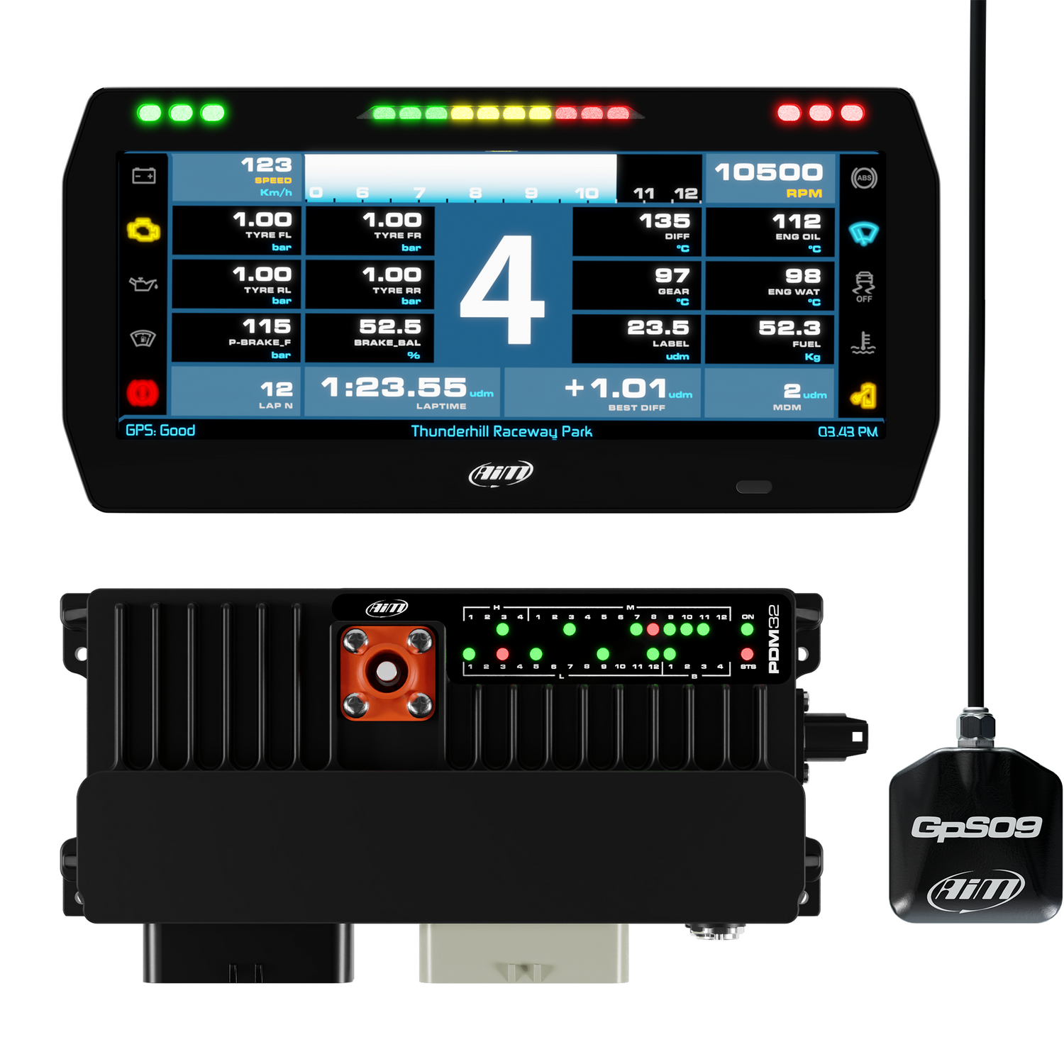

Upgrade Your Racing Setup
The Aim PDM32, 10" Display With Race Icons & GPS Data Logging Kit is an advanced power distribution and data management system designed for professional and amateur motorsport applications. The powerful 32-channel PDM with a fully configurable 10" TFT display and GPS tracking streamlines vehicle electronics, reduces wiring complexity and enhances real time data analysis. It is ideal for providing improved control, reliability and insight to optimise your racing experience.
Power Distribution Module
The Aim PDM32 is an advanced 32-channel power distribution module designed to power a multitude of vehicle circuits, removing the need for traditional fuse boxes and relays. It allows for a simplified wiring harness with increased reliability and control functions.
The PDM32 can receive data from the vehicle ECU and even includes a data logger and GPS Module for lap timing and track mapping.
PDM32 Key Features
32 RGB LEDs
8 Analogue Digital Inputs
GPS Lap Timing (Optional)
4 Digital Inputs
Data Logging Facility
Two-Speed Inputs
28 High Side Outputs
4 Half-Bridge Outputs
PDM32 Power Outputs
The PDM32 is equipped with 28 high-side outputs and 4 half-bridge outputs:
  • 4 x high-power outputs (up to 20A)
  • 12 x mid-power outputs (up to 15A)
  • 12 x low-power outputs (up to 10A)
  • 4 x half-bridge outputs (up to 35A)
  • Total continuous maximum current: 120A
Each output provides feedback to the data logger to provide vital information such as open circuits, short circuits, high/low voltage, the number of fault retires and the time between the reties is user-definable.
All outputs can be configured as PWM for soft start/stop functionality. Configuration and monitoring of the PDM circuits can be managed via Race Studio 3 software.
PDM32 Inputs
The PDM32 features:
  • 8 x Analogue/Digital inputs
  • 2 x Speed inputs
  • 4 x Digital-only inputs
PDM32 Data Management
The PDM32 can receive and log data from multiple sources:
  • ECU - Over 1000 supported protocols
  • Digital/Analogue inputs
  • Internal nine-axis EMU
  • GPS - Lap timing and position tracking
  • Expansion modules
  • Push buttons - From Remote Input/Output Module or any commercial CAN keypad
  • PDM outputs - Current and status monitoring
  • User-defined mathematical channels
Dash Display 10" Race Icons
With fully configurable displays and a range of layouts, the TFT dash display provides a large 10” screen with Race Icons. This makes it the ideal option for drivers who want important data clearly displayed on their screen during competitive motorsport environments.
The display can function as a reversing mirror with an optional camera, perfect for vehicles with restricted rear visibility. Up to 2 cameras can be connected for front and rear views.
PDM Display Key Features
10" TFT Display
Race Icons
6 Status LEDs
10 Shift Light LEDs
Configurable Display
Range Of Layouts
GPS Module Options
The GPS09 Module offers highly accurate lap timing and position tracking for circuit racing. With access to over 4,000 pre-loaded tracks, it automatically detects timing points upon arrival at the track, eliminating setup time.
The GPS Module is available with cables from 50cm up to 4m. There is also a GPS Roof-Mounted version available in 2m or 4m.
Compatible Expansions
The PDM32 Kit is compatible with various additional expansions and modules to enhance performance and expand on data collection. Compatible expansions include:
With Race Studio 3, you can analyse all data recorded by the PDM Kit and download it to your PC: graphs, histograms and tables will help you study your performance, providing objective support to avoid mistakes and improve performance.
Aim PDM32 With 10" Race Icons Display GPS Data Logging Kit
  • Inputs:
  • 14 Fully Configurable, max 500 Hz each:
  • 8 analogue/digital
  • 4 digital inputs
  • 2-speed input
  • Power Outputs:
  • 4 rated up to 20 A (high power)
  • 12 rated up to 15 A (mild power)
  • 12 rated up to 10 A (low bridge)
  • 4 rated up to 35 A (half-bridge)
  • Protected for: over voltage, under voltage, over current, over temperature
  • Total max current: 120 A
  • LEDs: 32 RGB LEDs + 1 PDM ON + 1 PDM STS (Status)
  • Lin Bus: 1
  • CAN Connections: 3
  • Internal platform: 3 axis ±5G accelerometer + 3 axis gyro + 3 axis magnetometer
  • Remote Display Connection: 1 Aim stream output
  • Connectors: 2 AMP connectors + 2 Binder connectors + 1 Amphenol Surlok connector + 1 Rosenberger connector
  • Internal memory: 4 GB
  • External modules: GPS Module, Channel Expansion, TC Hub, Lambda Controller, SmartyCam HD, Formula Steering Wheel, Remote I/O Pushbutton Module
  • External Analogue Camera input: 2
  • Body: Anodised Aluminium
  • Waterproof: IP65
  • Dimensions: 234.5 x 94.6 x 49.5mm
  • Weight: 761g

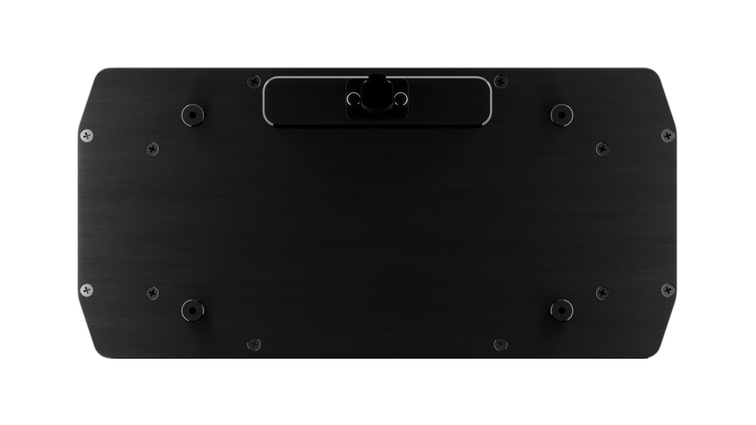

  • PDM Dash 10" TFT Display:
  • Display: 10" TFT
  • Contrast: 1,100:1
  • Brightness: 800cd/m2
  • Ambient Light Sensor: Yes
  • Status information LEDs: 6
  • Shift Light LEDs: 10
  • Body: Anodized Aluminium
  • Pushbutons: Metallic
  • Connectors: LVDS Link 4 pins Rosenberger male connector
  • Dimensions: 278.0 x 135.0 x 26.2mm
  • Weight: 1000 g
  • Power Consumption: 250 mA
  • Waterproof: IP65
  • GPS Module:
  • 5 Pin Binder connection
  • Weight: 60.5g
  • Power Distribution Module PDM32
  • TFT Screen 10" Race Icons
  • GPS Module
  • x 2 35 pins AMP Connector
  • Surlock Connector
  • Rosenberger LVDS Connector
  • CAN EXP Cable
  • Download Cable
