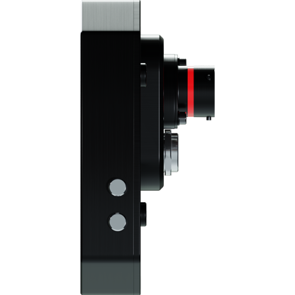

AiM MXG 1.3 7" TFT Dash Display Logger
The MXG 1.3 7" TFT Dash Display Logger has a fully configurable display and designed to acquire data coming from the ECU.
7" TFT high contrast display GPS Module
CAN output 10 configurable RGB LEDs
AiM MXG 1.3 TFT Dash Logger
The MXG 1.3 Dash Logger is our biggest dash display, with a 7" TFT display making it a great fit for wide cockpit installations. The display is fully configurable and suitable for an array of Motorsports.
Designed to acquire and display data coming from your ECU, the internal accelerometer and GYRO, the GPS module (included in the kit) analogue inputs/digital inputs and predefined math channels. The performance and data acquired can also be incremented by adding up to eight expansion modules.
Connecting the MXG 1.3 dash to your ECU is simple. You can sample dozens of channels straight from the vehicles ECU. This is usually the quickest and easiest setup, needing only one cable connection to the ECU instead of multiple connections to analogue sensors. The sampled data will depend on your actual ECU but typically includes RPM, the engine load, throttle position (TPS), oil, air, water temperature, oil pressure, battery voltage, speed, gear, lambda value (air, fuel ratio). The list of ECUs is constantly being updated and upgraded, it has over 1000+ of either stock or racing.
Two Digital Outputs
MXG 1.3 also features two digital outputs. Each of them can give an output of 1 amp at 12 volts. They can be configured in order to be turned on/off depending on the value of the analogue or digital inputs. They permit to automatically run external systems, such as: to switch on/off additional lights, to activate/deactivate a cooling fan or circulation pumps when a certain event happens.
With a high contrast 7" TFT display which is fully configurable. You can create and customise pages/displays to suit your requirements using different fonts and dimensions for all the information received by the dash logger. Swapping through the pages is managed by pushing one or two pushbuttons. An ambient light sensor keeps the backlight at optimum brightness levels.

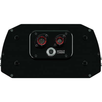

Two analogue camera inputs are available, to switch your display into a mirror camera, through a pushbutton command or event management. The camera sold separately.
Flexible Alarms
The MXG has eight configurable RGB LEDs. You can choose the conditions and colours. Select a solid alarm or flashing one and the flashing frequency, you can choose to have an accompanying text message and set the alarm priorities.
CAN output
With the CAN Output, you can send messages directly to an existing CAN network in order to improve the range of vehicle control possibilities.
GPS Module
The GPS Module connected via CAN to the MXG makes lap time calculation and track position analysis easy. With 4000+ worldwide tracks already stored with the start and finish line coordinates you will have no problem when you're on the track. As soon as the MXG is turned on the GPS Module will locate its position, identify track line coordinates and start immediately sampling lap and split time. If the track is not on the database, you can easily add the start/finish line coordinates to the MXG via a PC before you go to the track using our Race Studio 3 software.
Pin Harness
These are only some of the items that can be added to our MXG 1.3 for incrementing the performance and the data acquired.
With Race Studio 3 you can also analyse all data recorded by MXG 1.3 and downloaded to your PC: graphs, histograms and tables will help you study your performance, providing objective support to avoid mistakes and improve performances.
  • Display: 7" Display
  • Contrast: 1,000:1
  •  Brightness700cd/m2 - 1,100 Lumen
  • Alarm LEDs: 8 RGB freely configurable
  • CAN connections: 3
  • ECU connections: CAN, RS232 or K-LIne
  • Second CAN: Yes
  • Wi-Fi connection: Yes
  • Accelerometer: Internal Three-axial ± 5G + Three-axial Gyroscope
    + 3 axis magnetometer
  • Internal Memory: 4 GB
  • Body: Anodized Aluminium
  • Pushbuttons: Metallic
  • Power Consumption: 400 mA
  • Dimensions: 237 x 127.6 x 26mm
  • Weight: 950g
  • Waterproof: IP65
