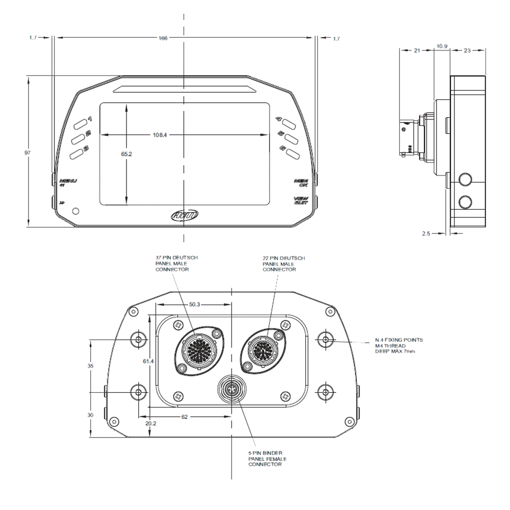

The MXS 1.3 1.2 Aprilia dash logger has a 5" TFT display which has been designed to acquire and display data coming from the ECU.
5" compact TFT display GPS Module
CAN output 6 configurable RGB LEDs
Aim MXS 1.3 Aprilia Logger with CAN Connection
The MXS 1.3 5" TFT compact Dash Logger is fully configurable and suitable for many different motorsports. It has been designed to acquire and display data coming from the ECU. Analogue/digital inputs and predefined math channels. Performance and data acquired can also be incremented by adding up to eight expansion modules. The MXS 1.3 is a great choice for compact cockpit installations where space is at a premium.
Connecting the MXS 1.3 dash to your ECU is simple. You can sample dozens of channels straight from the vehicles ECU. This is usually the quickest and easiest setup, needing only a cable connection to the ECU instead of multiple connections and analogue sensors. The sampled data will depend on your actual ECU but typically includes RPM, engine load, throttle position (TPS), oil, air, water temperature, oil pressure, battery voltage, speed, gear, lambda value (air/fuel ratio). The list of available ECU drivers is constantly updated and upgraded and includes approximately 1000+ different  ECUs.
  • Display: 5" Display
  • Brightness700cd/m2 - 1,100 Lumen
  • CAN connections: 3
  • ECU connections: CAN, RS232 or K-Line
  • Analogue Inputs: 8 fully configurable, max 1,000Hz each
  • Second CAN: Yes
  • Wi-Fi connection: Yes
  • Internal Memory: 4GB
  • Body: Anodised Aluminium
  • Power Consumption: 400mA
  • Dimensions: 169.4 X 97 X 23mm
  • Weight: 530g
  • Waterproof: IP65
