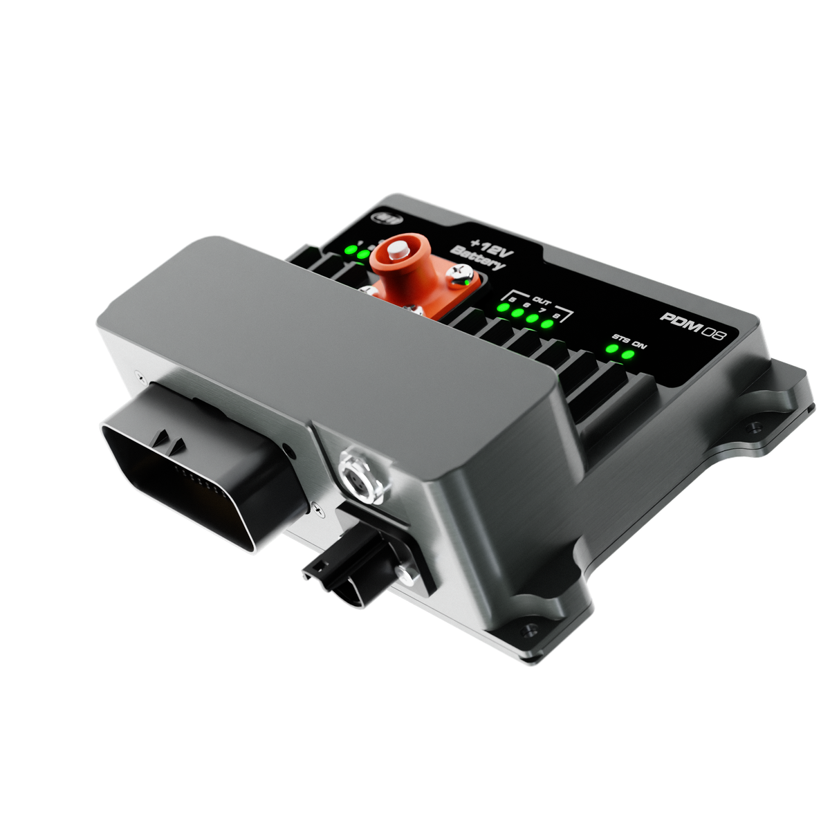

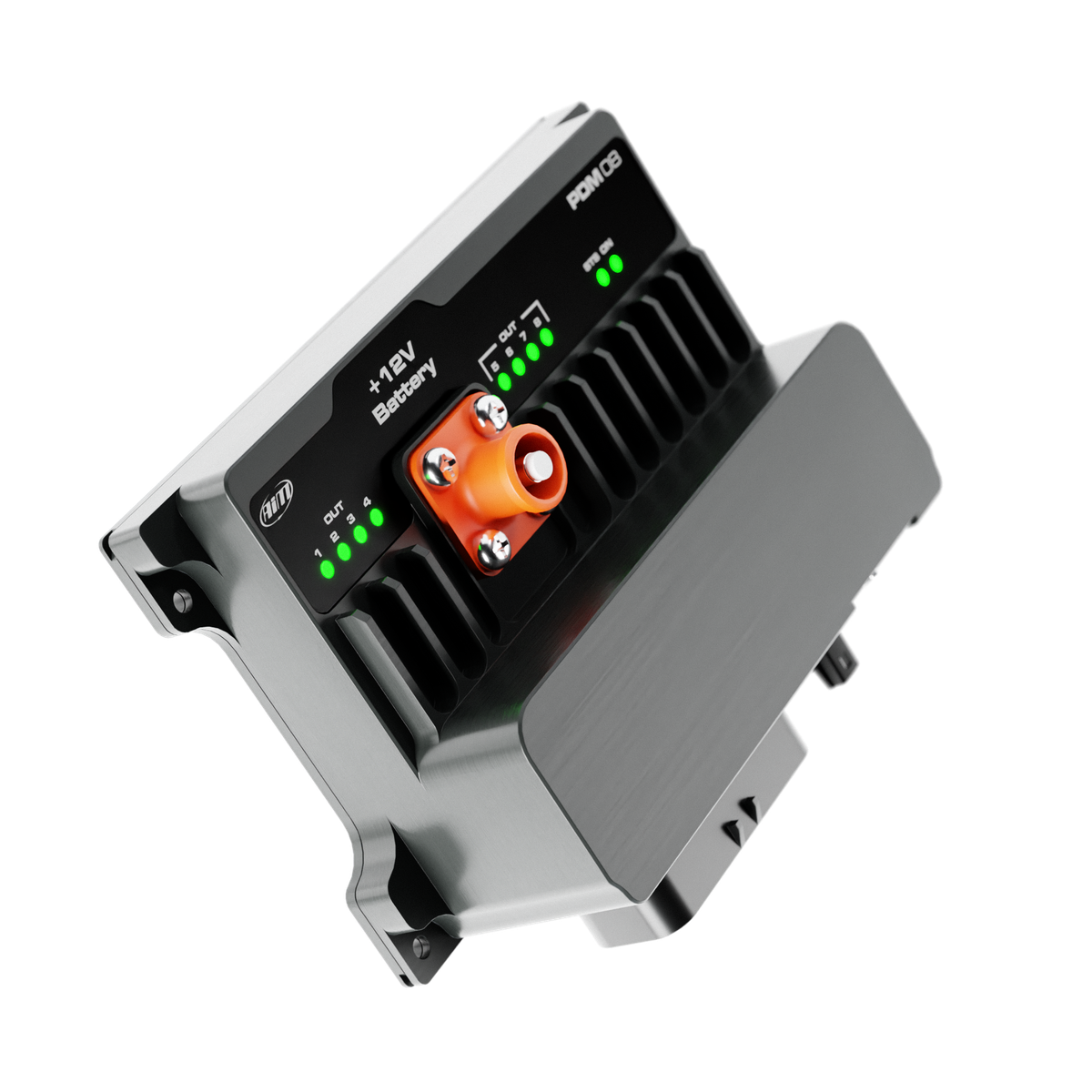

The AiM PDM08 is a 8 channel advanced power distribution module designed to power a multitude of vehicle circuits, removing the need for traditional fuse boxes and relays.
8 RGB LEDs Six analogue digital inputs
GPS lap timing (optional) Power outputs
Data logging facility Two-speed inputs
Power Distribution Module
The AiM PDM08 is a 8 channel advanced power distribution module designed to power a multitude of vehicle circuits, removing the need for traditional fuse boxes and relays. It allows for a simplified wiring harness with increased reliability and control functions.
The PDM08 is available on its own or with a choice of 6" or 10" dash displays. It can receive data from the vehicle ECU and even includes a data logger and optional GPS module for lap timing and track mapping.
PDM08 Power Outputs
The PDM8 features eight high sided outputs: 1 x with series diode rated up to 20A, 1 x rated up to 25A, 6 x rated up to 15A. Total continuous max current 100A.
Each of the outputs provides feedback to the data logger to provide vital information such as open circuits, short circuits, high/low voltage, the number of fault retires, and the time between the reties is user-definable.

  • LEDs: 8 RGB LEDs + 1 PDM ON + 1 PDM STS (Status)
  • Inputs:
  • Six fully configurable, max 500 Hz each
  • Pullup + 12V, + 5V, analog/digital
  • Pulldown
  • Speed In: 2
  • Power Outputs:
  • 1 with serie diode rated up to 20 A
  • 1 rated up to 25 A
  • 6 rated up to 15 A
  • Protected for:
  • Over Voltage, Under Voltage, Over Current, Over Temperature
  • All inputs have an internal freewheeling diode
  • Total max current: 100 A
  • Lin Bus: 1
  • CAN Connections: 3
  • Internal Platform: 3 axis ±5G accelerometer + 3axis gyro + 3 axis magnetometer
  • Internal Moemery: 4 GB
  • External Modules: GPS Module, Channel Expansion, TC Hub, Lambda Controller, SmartyCam HD, Formula Steering Wheel, Remote I/O pushbutton module
  • External Analog Camera input: NO

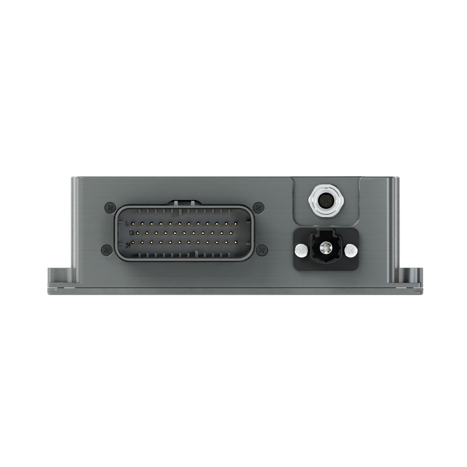

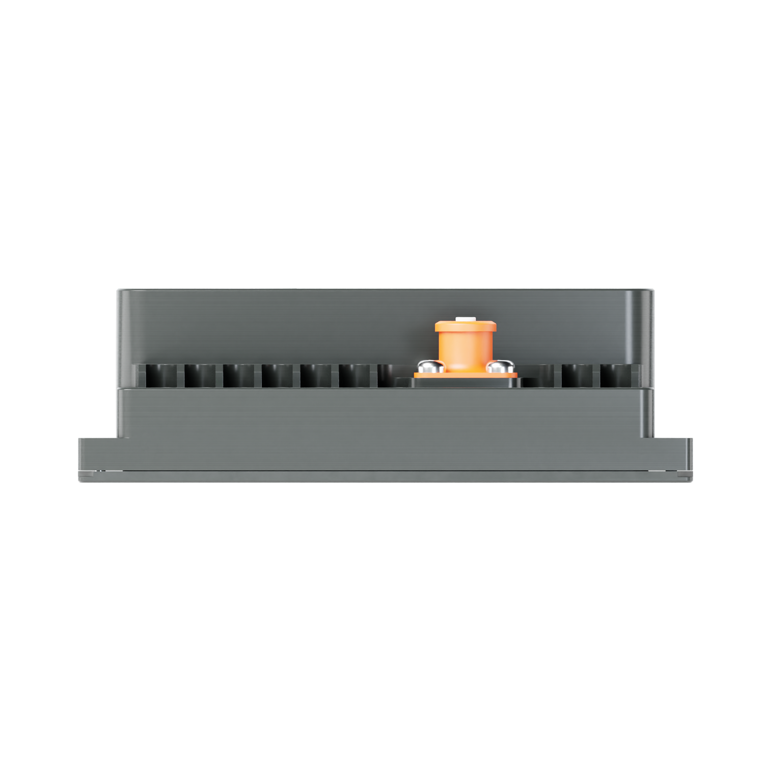

  • Connectors: 1 AMP connector + 1 Amphenol Surlok connector + 1 Rosenberger connector
  • Remote display connection: 1 AiM stream output
  • Body: Anodized Aluminium
  • Dimensions: 161 x 100.6 x 50.6mm
  • Weight: 500 g
  • Waterproof: IP65
