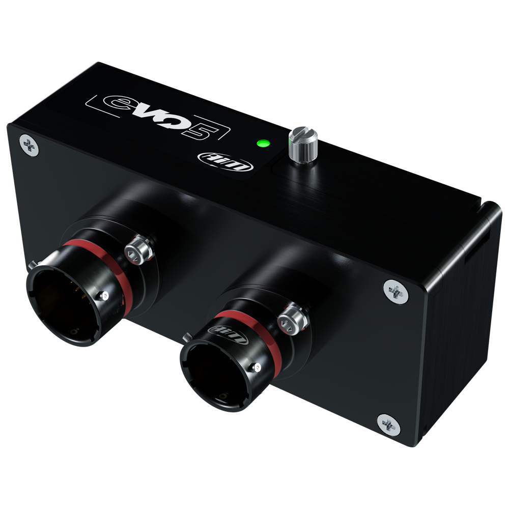

The AiM EVO5 Motorcycle Racing Data Logger with two multi-channel Motorsport connectors. Connects to your vehicle's ECU via CAN, RS232 or K-Line, also includes GPS Module.
Two multi-channel connectors GPS Module included
ECU connection to over 1000+ ECUs CAN output
AiM EVO5 Data Logger
The AiM EVO5 Motorcycle Racing Data Logger features two multi-channel Motorsport connectors. It connects to the vehicle's ECU via CAN, RS232 or K-Line. The GPS09 Module is also included with this kit. With a range of cable lengths available to suit your requirements.
EVO5 is the evolution of the traditional Data Logger, with its compact aluminium body, EVO5 can be easily placed in any vehicle. Its configuration with Race Studio 3 software is simple and immediate.
The incoming data from your ECU via CAN, RS232 or K-Line, the internal accelerometer and gyro, and the GPS Module are all recorded by the EVO5. The unit can also accept digital or analogue inputs. Sensors can be connected to 8 configurable analogue channels, to the RPM input and up to 4 wheel speed inputs.
Two Digital Outputs
EVO5 features two digital outputs. The built-in digital outputs can be configured to automatically run external systems when an event happens. A good example would be the activation/deactivation of a cooling fan when a certain temperature is met.
CAN output

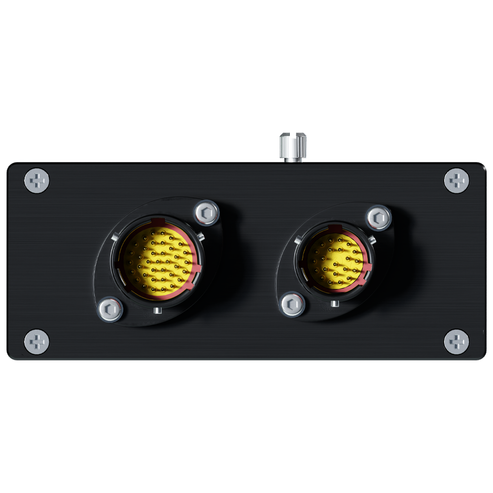

Two Multi-Channel Motorsport Connectors
Straightforward, the 37 pins connector harness supplied with the kit offers your main applications such as power, CAN, etc
A second 22 pin connector harness is available for functions like CAN2 and digital outputs. This harness is (Sold Separately) See Accessories Tab
Endless Expansion Possibilities
Add expansion modules via the built-in CAN Bus: Channel Expansion
It permits you to add 4 0.5 Volt analogue channels for pressure, Temperature Sensors and potentiometers. Two of these channels can be configured to receive digital inputs like wheel speed.
LCU-One CAN
Wideband Lambda controller LCU-One, with Bosch LSU 4.9 probe, providing all Air/Fuel data and lambda value, allows to perfectly tune the carburetion.
SmartyCam HD Cameras
The onboard cameras overlay on videos the data sampled by your logger.
Displays
To make sense of all the incoming data, the EVO5 can be connected to the GS Dash.
Memory Module
The Memory Module is a small SD Card holder that can be connected via CAN-Bus to your AiM logger to record the data during your tests.
These are only some of the items that can be added to our EVO5 for incrementing the performance and the data acquired.
With Race Studio 3 you can also analyse all data recorded by EVO5 and downloaded to your PC: graphs, histograms and tables will help you study your performance, providing an objective support to avoid mistakes and improve performance.
  • ECU Connection: CAN, RS232 or K-Line to 1000+ industry-leading ECUs
  • External Modules: GPS Module, Channel Expansion, TC Hub, Lambda Controller, SmartyCam HD
  • Analogue Inputs: 8 fully configurable - 0-5V, 0-12V, K thermocouples. Max freq 1 kHz each
  • Digital Inputs: Coil RPM and 4-speed inputs
  • Intertial Platform: Internal 3 axis ±5G accelerometer + 3 axis gyro
  • Digital Outputs: 2, up to 1 Amp each
  • Second CAN: Yes
  • WiFi Connection: Yes
  • Internal Memory: 4 GB
  • SD Card: Internal - up to 128 GB (Sold Separately)
  • Connectors: 2 Motorsport connectors
  • Body: Anodized Aluminium
  • Dimensions: 114.4 x 47.2 x 58.8mm
  • Weight: 300g
  • Waterproof: IP65
    Installation
    For a correct EVO5 installation it is important to follow some simple points.
    Carry out CAN, serial or K-Line connection only after performing the logger configuration with Race Studio 3.
    For the correct working of the integrated three-axial accelerometer and gyroscope, EVO5 should be placed in a central position.
    The GPS Module should not be positioned under metal or carbon fibre objects, which would greatly reduce the satellite quality.
    Also avoid positioning close to antennas, digital cameras or TFT displays.
