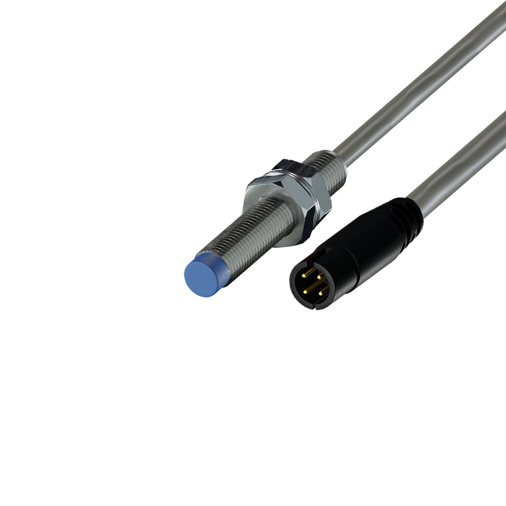

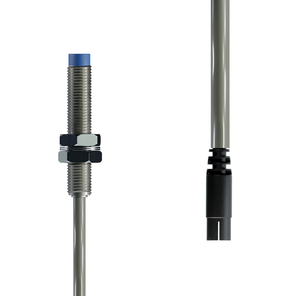

AiM Hall Speed Pick Up Sensor
The AiM non-contact sensor needs a metallic trigger to pass in front of it. It comes with a magnet and locknuts.
Hall effect wheel speed sensor 719 plastic connector
2m cable M8 thread
AiM 712 Hall Speed Pick Up Sensor (2m cable). The output varies when it meets a magnetic field. The three-wire sensor produces a digital signal.
The sensor consists of a thin piece of metal that passes a continuous current through it. When the sensor is placed in a magnetic field the electrons move to one side of the metal and protons move to the other side of the plate. You will then be able to get a voltage.
The Hall Effect Sensor is a non-contact device that needs a metallic trigger to pass in front of it. Again, a bracket will usually need to be fabricated to mount the sensor in a suitable position. Please ensure that the distance between the sensor and trigger is in a 0.5 – 2.0 mm (0.007-0.07 inches) range.
The sensor only produces around Severn volts. When the electrons move to one side a potential difference is produced between the two sides of metal.
Connections
719 Connection to suit MXL (Strada and Pista), MXG/MXS/MXP (inc Strada), MXL2. Use a 719-719 Patch Lead to extend to the required length.
  • 719 plug Binder Connector
  • Power Supply: 10-30 VDC
  • Sensibility Distance: From 0.5 to 2,5mm
  • Sensor Thread: M8
  • Operating Temperature Range: -25 to 70°C
  • Waterproof: IP67
