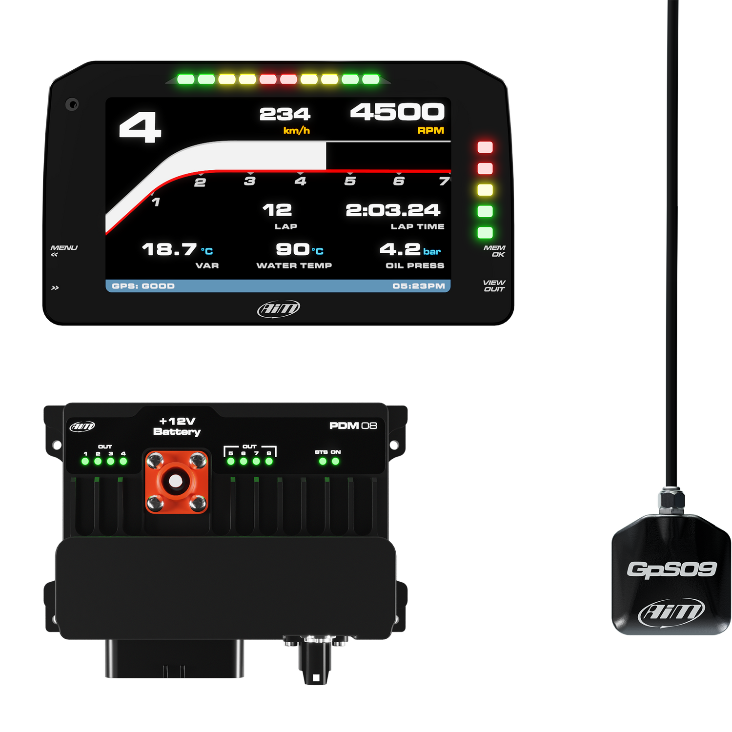

The AiM PDM08 is an eight-channel advanced power distribution module designed to power a multitude of vehicle circuits, removing the need for traditional fuse boxes and relays. The 6" TFT display with race icons features a fully configurable display with a range of layouts to choose from and a GPS Module providing easy lap timing and lap position for track mapping.
8 RGB LEDs Six analogue digital inputs
GPS lap timing  Power outputs
Data logging facility Two-speed inputs
Power Distribution Module
The AiM PDM08 is an eight-channel advanced power distribution module designed to power many vehicle circuits, removing the need for traditional fuse boxes and relays. It allows for a simplified wiring harness with increased reliability and control functions.
The PDM08 can receive data from the vehicle ECU and even includes a data logger and GPS Module for lap timing and track mapping. The GPS Module is available with cables from 50cm up to 4m. There is also a GPS roof version available in 2m or 4m.

  • LEDs: 8 RGB LEDs + 1 PDM ON + 1 PDM STS (Status)
  • Inputs:
  • Six fully configurable, max 500 Hz each
  • Pullup + 12V, + 5V, analogue/digital
  • Pull down
  • Speed IN: 2
  • Power Outputs:
  • 1 with serie diode rated up to 20 A
  • 1 rated up to 25 A
  • 6 rated up to 15 A
  • Protected for: over-voltage, under-voltage, undercurrent, over temperature
  • Total max current: 100 A
  • Lin Bus: 1
  • CAN connections: 3
  • Internal platform: 3 axis ±5G accelerometer + 3axis gyro + 3 axis magnetometer
  • Internal memory: 4 GB
  • External modules: GPS Module, Channel Expansion, TC Hub, Lambda Controller, SmartyCam HD, Formula Steering Wheel, Remote I/O pushbutton module
  • External Analog Camera input: NO
  • Connectors: 1 AMP connector + 1 Amphenol Surlok connector + 1 Rosenberger connector
  • Remote display connection: 1 AiM stream output
  • Body: Anodized Aluminium
  • Dimensions: 161 x 100.6 x 50.6mm
  • Weight: 500g
  • Waterproof: IP65
  • AiM PDM Dash 6"
  • Display: 6" TFT
  • Contrast: 600:1
  • Brightness: 700cd/m2 - 1,1000 Lumen
  • Ambient light sensor: Yes
  • Status information LEDs: 5
  • Shift light LEDs: 10
  • Pushbuttons: Metallic
  • Connectors: LVDS Link 4 pins Rosenberger male connector
  • Weight: 640g
  • Power consumption: 150 mA
  • Waterproof: IP65
  • GPS Module
  • 5 Pin Binder connection
  • Weight: 60.5g
AiM PDM08 With 6" Race Icons Display GPS Data Logging Kit
  • Power Distribution Module PDM08
  • TFT Screen 6" Race Icons
  • GPS Module
  • x 2 35 pins AMP connector
  • Surlock connector
  • Rosenberger LVDS connector
  • Download lead
