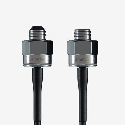

    The Aim 0-160 bar pressure sensor is suitable for oil and fuel pressure readings and can read pressures up to 160 bars. This sensor will monitor brake pressure levels for optimum performance accurately.
     0-160 Bar 4 pins 719 male binder
    Aim Brake Pressure Sensor 0-160 Bar
    The Aim 0-160 Bar brake pressure sensors are fitted with male four pins black 719 binder plug connections to suit all Aim loggers and dash display/loggers.
    Whether your car is equipped with single, dual, fixed or adjustable master cylinders, adding brake pressure sensors allow you to monitor brake performance, make real changes and identify issues quickly and precisely.
    The sensors can be easily installed in a -3 brake line using a three-way T-piece. It can also use them for measuring other pressures too high for the 0-10 Bar sensor. Available with an M10 or -3 JIC (3/8-24 UNF) thread.
    Connections
    • Supply: 8-16V
    • Output signal: From 0.5V to 4.5V
    • Characterisation: 500 mV/ 0 bar 4500 mV/ 100 bar
    • Consumption: < 10 mA
    • Sealing: IP66
    • Weight: 30g
    • Cable Length: 400mm
