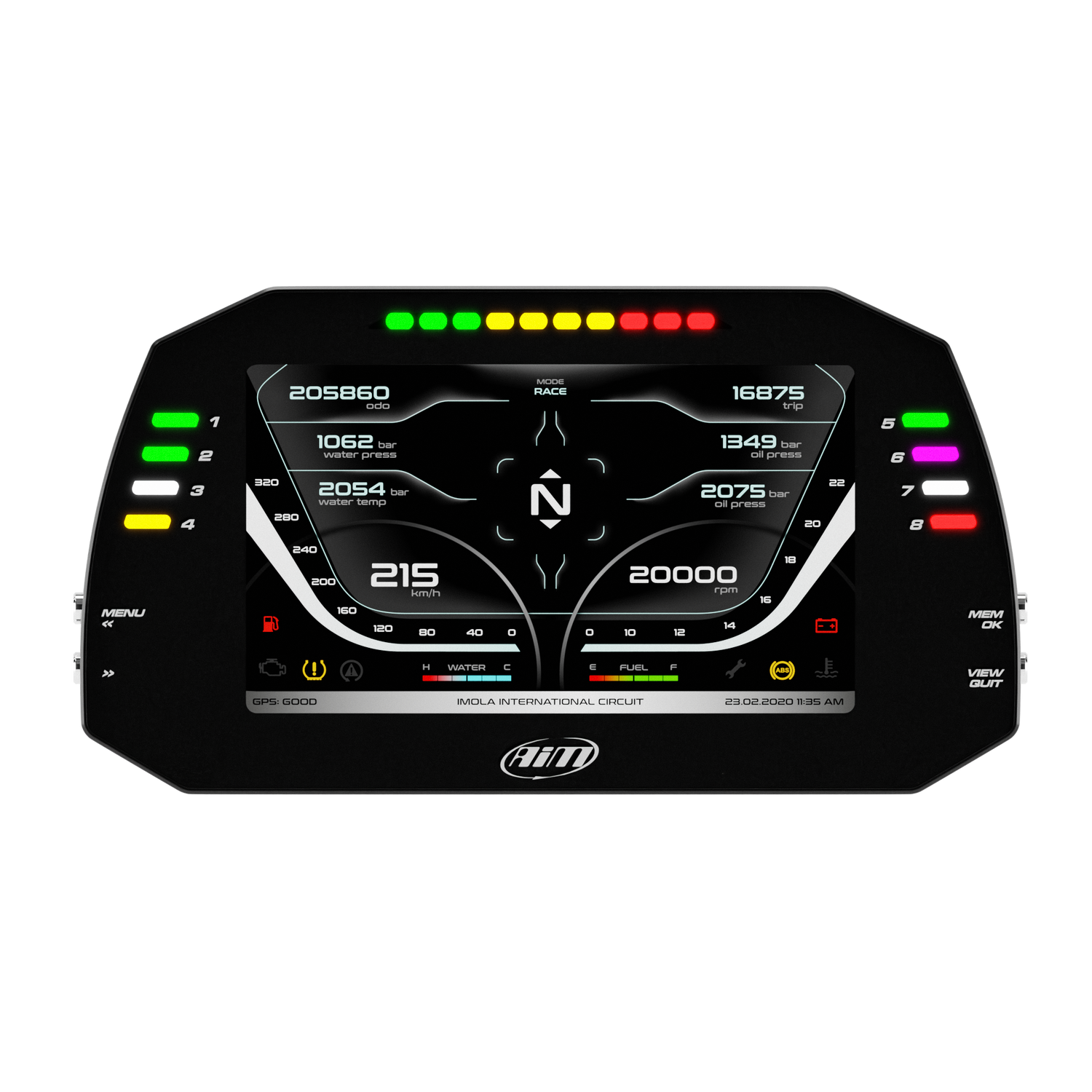

The MXG 1.2 Dash Logger is our biggest dash display, with a 7" TFT display making it a great fit for wide cockpit installations. The display is fully configurable and suitable for an array of Motorsports.
Designed to acquire and display data coming from your ECU, the internal accelerometer and GYRO, the GPS module (included in the kit) analogue inputs/digital inputs and predefined math channels. The performance and data acquired can also be incremented by adding up to eight expansion modules.

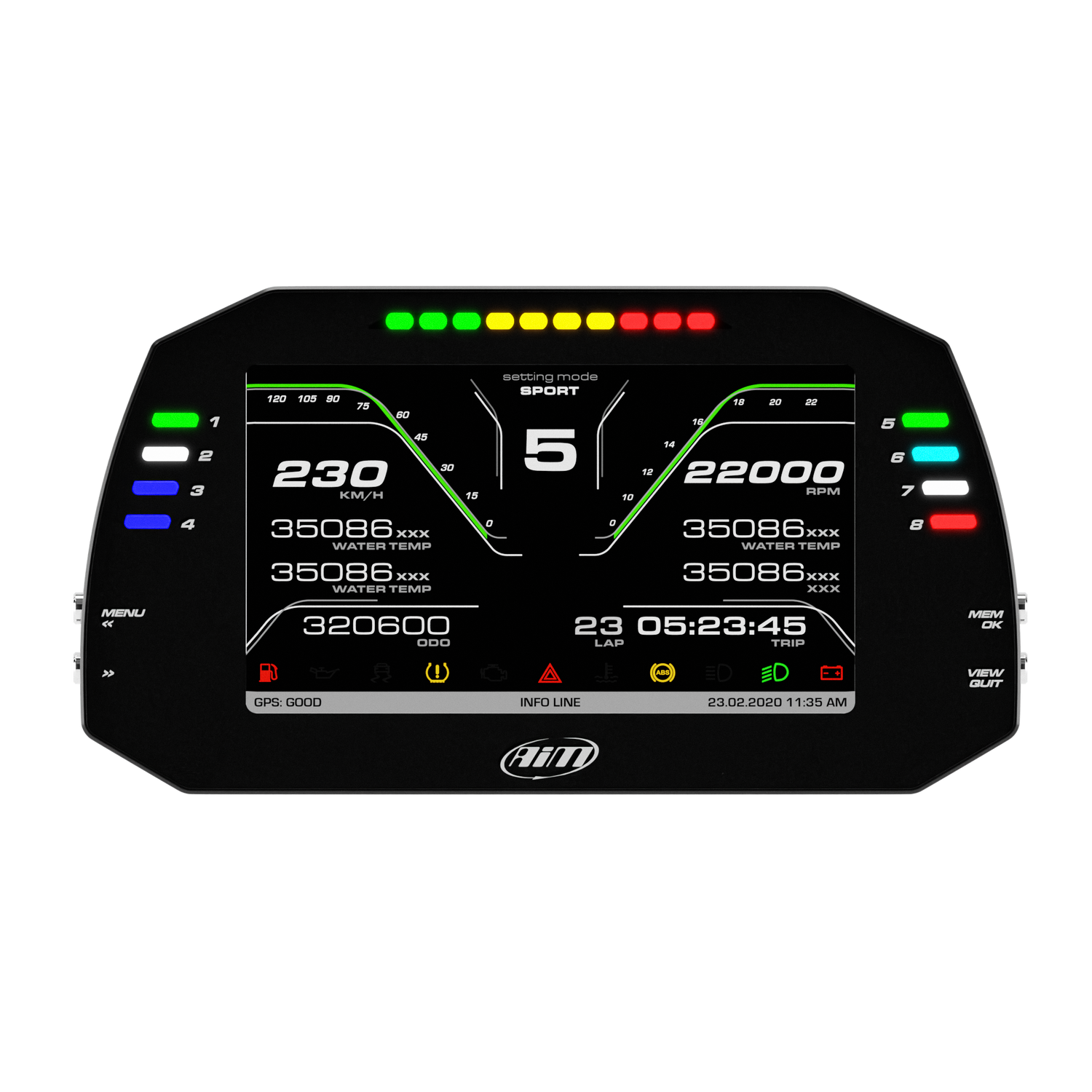

With a high contrast 7" TFT display which is fully configurable. You can create and customise pages/displays to suit your requirements using different fonts and dimensions for all the information received by the dash logger. Swapping through the pages is managed by pushing one or two pushbuttons. An ambient light sensor keeps the backlight at optimum brightness levels.

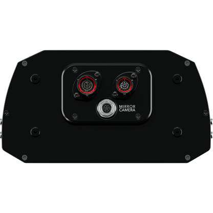

Two analogue camera inputs are available, to switch your display into a mirror camera, through a pushbutton command or event management. The camera sold separately.
