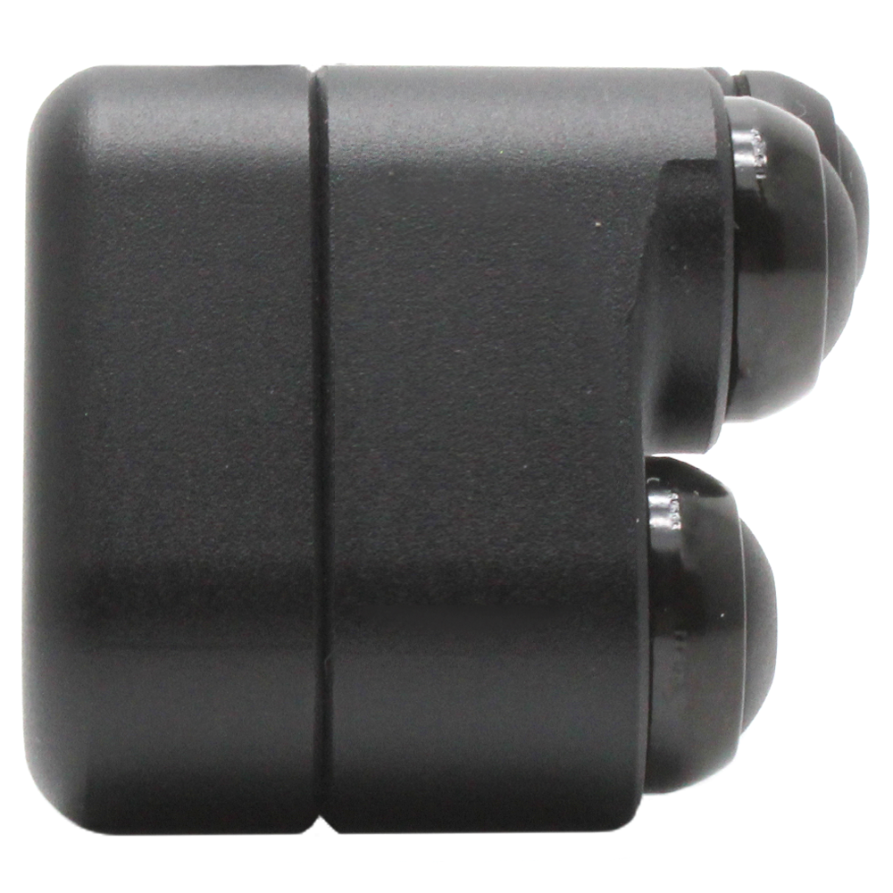

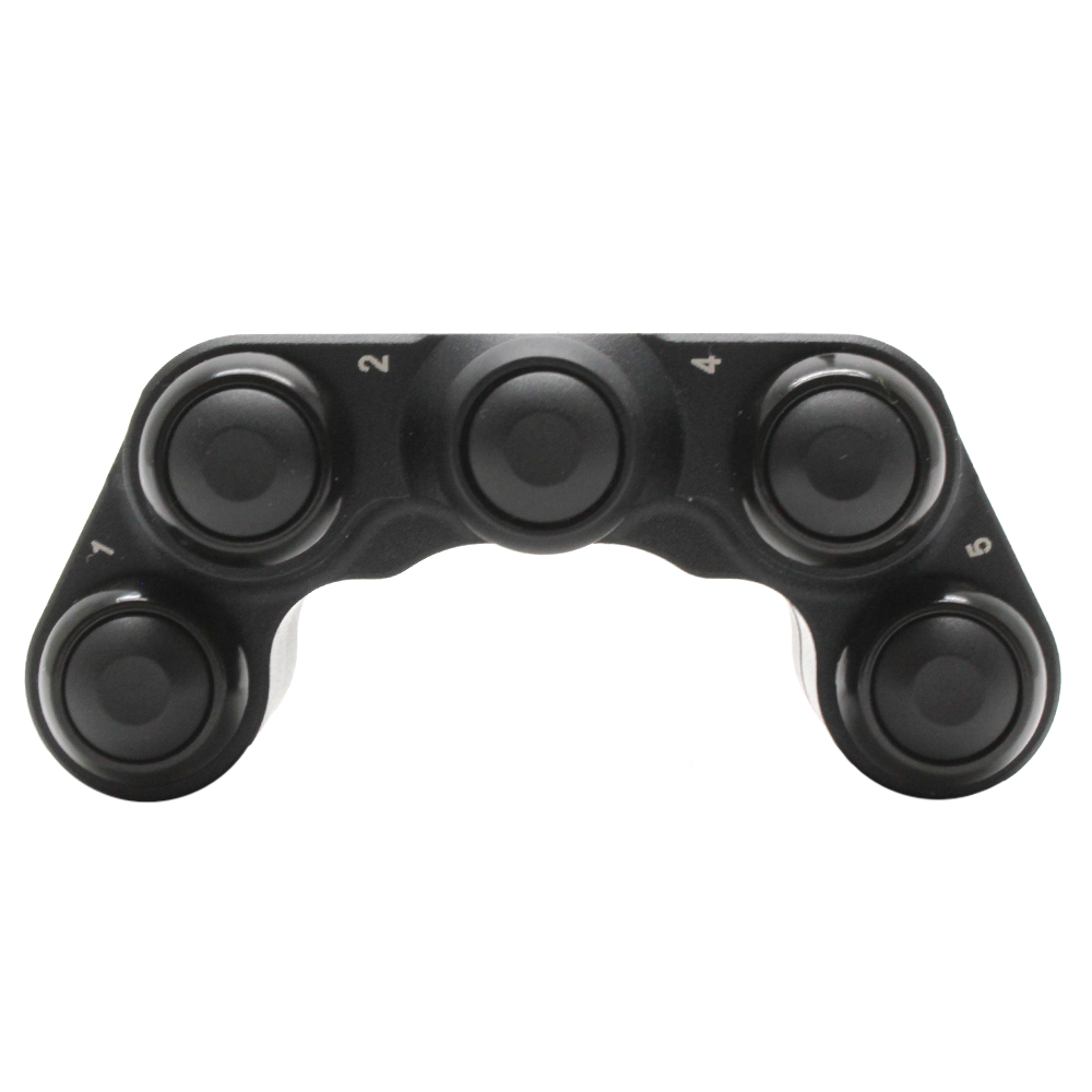

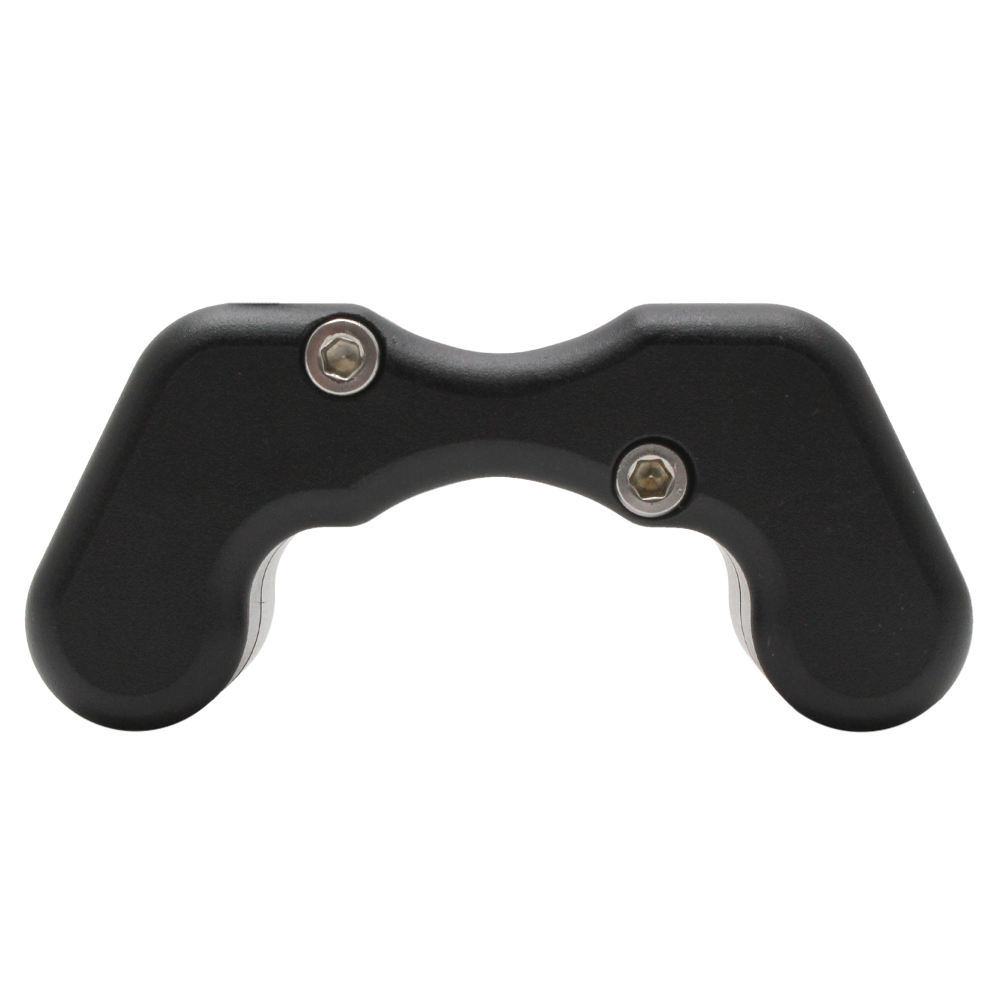

5 Button Handlebar Control Switches for Motorcycle
The aluminium assembly has been ergonomically designed for easy use and encompasses five sealed momentary switches, black in colour and a metal bezel.
With rugged machine aluminium construction and fully waterproof switches to provide greater crash protection and electrical integrity.
As an example for your switches, you could set the following controls,
Map Switch (latching on/off)
UP function
Select (mode function)
DOWN function
Pit speed limit ( push & hold)
Five-way left
All buttons are black & metal bezel
Common Ground
400mm DR25
All Momentary Ground N/O
- 5-way button
- Width at the centre: 13.5mm
- Colour: Black
- Metal Bezel
- Common Ground
- 400mm DR25
- All switches are momentary N/O
- Black: Common Ground
- Switch Sealing: IP67
- Laser Engraved: 1 - 5
- Wire colours are 1 - Red, 2 - Green, 3 - White, (no stripe) 4 - Blue, 5 - Yellow
- SP230 - BD-SW-5B
