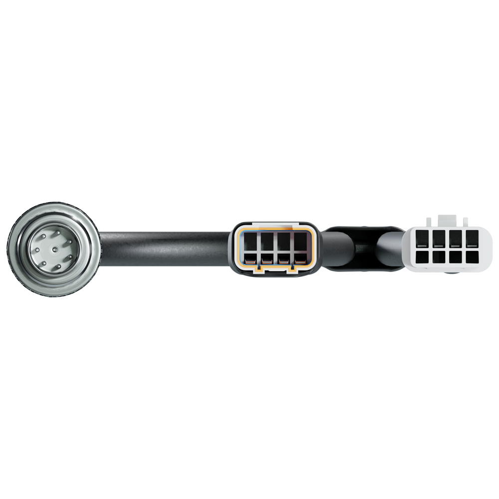

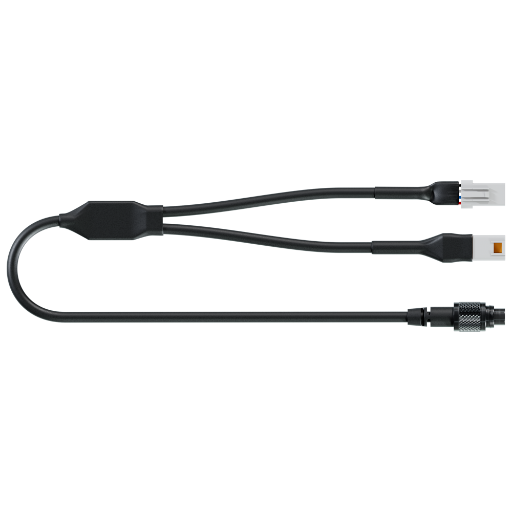

The AiM Taipan Solo 2 DL extension cable has been specifically designed to connect the Taipan ECU and the Solo 2 DL.
Solo 2 DL extension cable 50cm length cable
AiM Taipan Accessories
The AiM CAN Solo 2 DL extension cable has been manufactured to connect the Solo 2 DL to the AiM Taipan ECU.
The patch lead has a 7 pin male binder connector that connects to the Solo 2 DL and the JST connector connects to the Taipan ECU and is available in a 50cm long cable.

AiM Taipan Solo 2 DL Extension Cable
  • Solo 2 DL Extension Cable
  • Length: 50cm
  • 712 male binder connector - Cable 150mm
  • 4P Male JST Connector
  • 04T-JWPF-VSLE-S
  • PIN SWPT-001T-P025 - Cable 350mm
  • 4P Female JST connector
  • 04R-JWPF-VSLE-S
  • PIN-SWPR-001T-P025
  • Black - GND
  • White - CAN EXP H
  • Blue - CAN EXP L
  • Red - 12V
