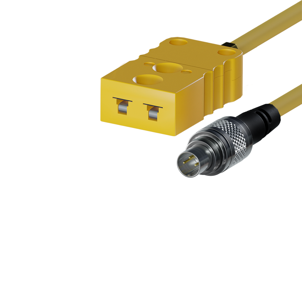

The AiM exhaust gas temperature (EGT) kart sensor accurately measures exhaust gas using a thermocouple placed in the exhaust header pipe for faster data reading and designed to operate with all MyChron kart dash/data loggers.
EGT Sensor T12 Yellow mignon plug 2 pins
Suitable for all Mychrons 4 & 5 S 2T 3 pin patch lead included
AiM T12 Exhaust Gas Temperature Sensor (EGT) for Kart
The AiM exhaust gas temperature (EGT) kart sensor accurately measures exhaust gas using a thermocouple placed in the exhaust header pipe for faster data reading and designed to operate with all MyChron kart dash/data loggers (including the new MyChron5 S and the older generation MyChron4).
When running the thermocouple cable through the chassis, ensure to keep it as far as possible from other cables, such as RPM cables or receivers, to minimise interference.
This EGT Sensor also comes with a TC Yellow to 712 3 pin patch lead with metal Binder.
The exhaust gas temperature sensor uses a two-pin mignon plug
Different fitments available, including KZ /KF kart engines (T12 Rotax, X30, OK)
