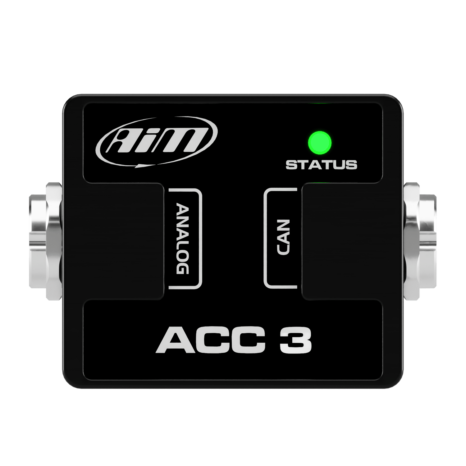

ENHANCE YOUR LOGGER PERFORMANCE ACC 3 is the new compact and powerful Analogue CAN Converter that manages up to four channels at 200 Hz each. Now compatible also with the AiM Solo 2 DL.
With Race Studio 3, you can also analyse all data recorded and downloaded to your PC: graphs, histograms and tables will help you study your performance, providing objective support to avoid mistakes and improve performances.
ACC 3 - Analogue CAN Converter
  • Analogue channels: 4 fully configurable channels, 24 bit, A/D, 200 Hz each: TC (with dedicated cable), TR, 0÷5 V, 0÷12 V
  • Speed Inputs: 2 (AN3-AN4), max frequency 10 kHz, internal pull-up for open drain/collector input
  • External power:9÷15 V operational 12÷15 V fully operationa
  • Connection: CAN
  • Connectors: 2 Binder 712 fem connectors
  • Material: PA6 30% glass
  • Dimensions: 44.0 x 38.0 x 19.8 mm
  • Weight:50 g
  • Waterproof: IP65
Acc tech sheet

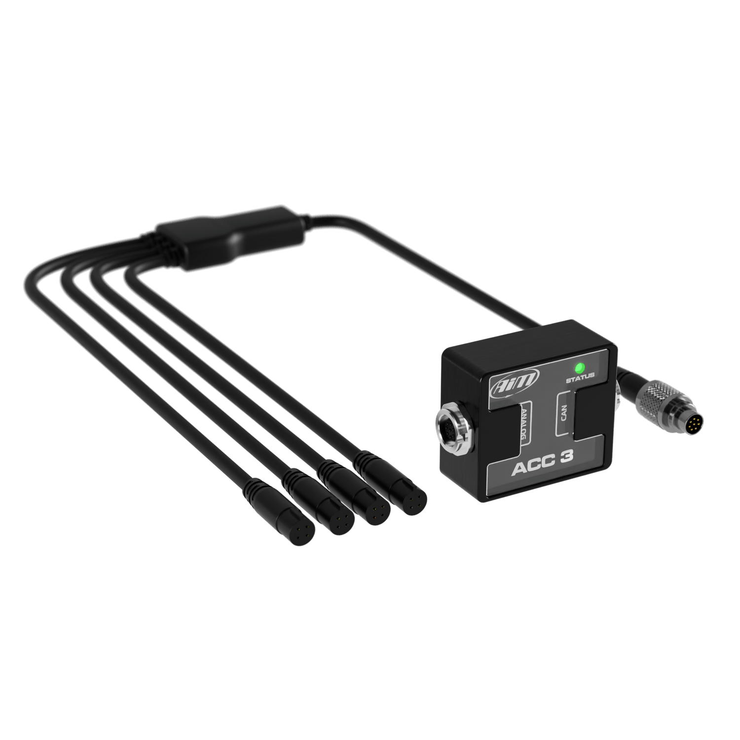

ACC3 Analogue CAN Converter
  • ACC3 Converter
  • CAN cable
  • 4 channels harness
