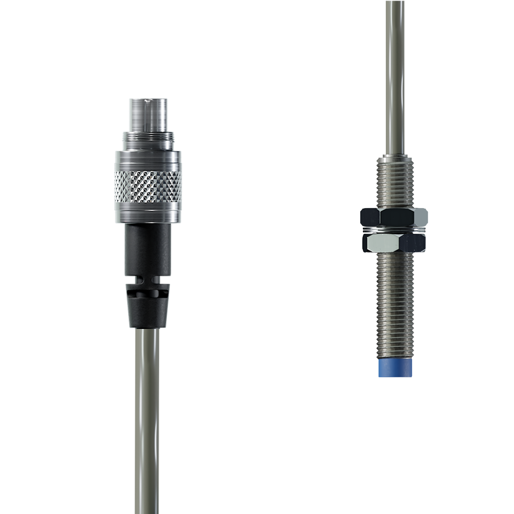

The AiM non-contact sensor needs a metallic trigger to pass in front of it. It comes with a magnet and locknuts.
Hall effect wheel speed sensor 712 metal connector
2m cable M8 thread
AiM Hall Speed Pick Up Sensor
AiM 712 Hall Speed Pick Up Sensor (2m cable). The output varies when it meets a magnetic field. The three-wire sensor produces a digital signal.
The sensor consists of a thin piece of metal that passes a continuous current through it. When the sensor is placed in a magnetic field the electrons move to one side of the metal and protons move to the other side of the plate. You will then be able to get a voltage.
The Hall Effect Sensor is a non-contact device that needs a metallic trigger to pass in front of it. Again, a bracket will usually need to be fabricated to mount the sensor in a suitable position. Please ensure that the distance between the sensor and trigger is in a 0.5 – 2.0 mm (0.007-0.07 inches) range.
The sensor only produces around Severn volts. When the electrons move to one side a potential difference is produced between the two sides of metal.
Connections
712 connection will suit EVO4 Data Loggers.
  • 712 Metal Binder Connector
  • Power Supply: 10-30 VDC
  • Sensibility Distance: From 0.5 to 2,5mm
  • Sensor Thread: M8
  • Operating Temperature Range: -25 to 70°C
  • Waterproof: IP67
  • 1 x Hall Effect Speed Sensor 712 Metal connector 2m Cable
