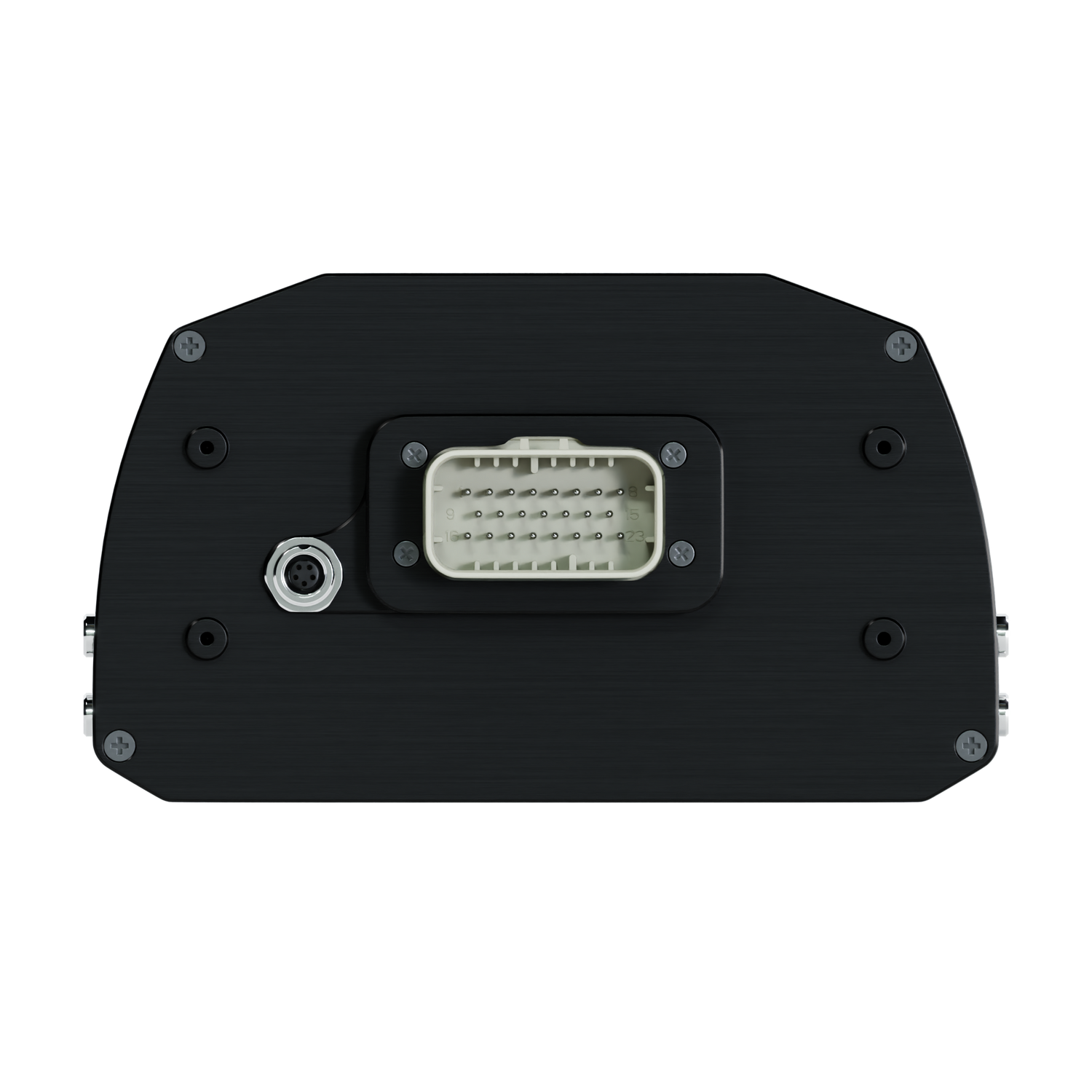

The MXS 1.3 Strada Light with Race Icons is a variant of one of the most widely used dash displays on tracks and roads around the world, the MXS 1.3.
Our brand new Light version has been created as a more accessible product for people who will use less analogue inputs, and just need a CAN connection for their ECU. Whilst being very similar to the MXS Strada, the MXS Strada Light gives 4 fully configurable analogue inputs (Max of 500 Hz each) instead of the 8 that is found on the standard MXS Strada (Max of 1000 Hz each). It also doesn’t have a digital output or a RPM connection which is found within the standard MXS Strada.
5" compact TFT display | 6 alarm RGB LEDs |
10 configurable shift light RGB LEDs | 4 analogue inputs |
CAN or K-Line input | Configure data |
AiM MXS 1.3 Strada Light 5" TFT Dash Display with Race Icons
The MXS 1.3 Strada Light is one of our most widely used dashes on tracks and roads all over the world. The MXS 1.3 Strada Light has a 5" colour TFT display that offers a great visual impact. You can configure the dash to show all the information coming from the ECU, analogue /digital inputs, predefined math channels and an optional GPS Module.
The MXS 1.3 Strada Light is available with a choice of connection. Choose either the OBDII or K-Line CAN, depending on whether you want to connect to the vehicles ECU or OBDII port or directly to the ECU through the CAN channel.
Connecting the MXS 1.3 Strada dash to your ECU is simple. You can sample and display dozens of channels straight from the vehicles ECU. This is usually the quickest and easiest setup, needing only 2 cable connections to the ECU instead of multiple connections to analogue sensors. The sampled data depends on the actual ECU, but will typically include RPM, throttle position, (TPS), oil, air, water temperature, oil pressure, battery voltage, speed, gear, lambda value (air/fuel ratio). The list of available ECU drivers is 1000+ and is constantly being updated and upgraded.

Display 5” TFT
Resolution 800x480 pixels
Contrast 600:1
Brightness 700 cd/m2 - 1,100 Lumen
Ambient light sensor Yes
Alarm LEDs 6 configurable RGB LEDs
Shift Lights 10 configurable RGB LEDs
CAN connections 2
ECU connection CAN or K-Line to 1,000+ industry leading ECUs
External modules GPS Module, Channel Expansion, TC Hub (necessary to connect K thermocouples), Lambda Controller, SmartyCam HD
Analog inputs 4 fully configurable, max 500 Hz each
EXT video inputs 1 PAL-NTSC
Second CAN Yes
Body Anodized Aluminum
Pushbuttons Metallic
Connectors 1 AMP connectors + 1 Binder connector
Dimensions 169.4x97x33,2 mm
Weight 460 g
Power consumption 400 mA
Waterproof IP65
