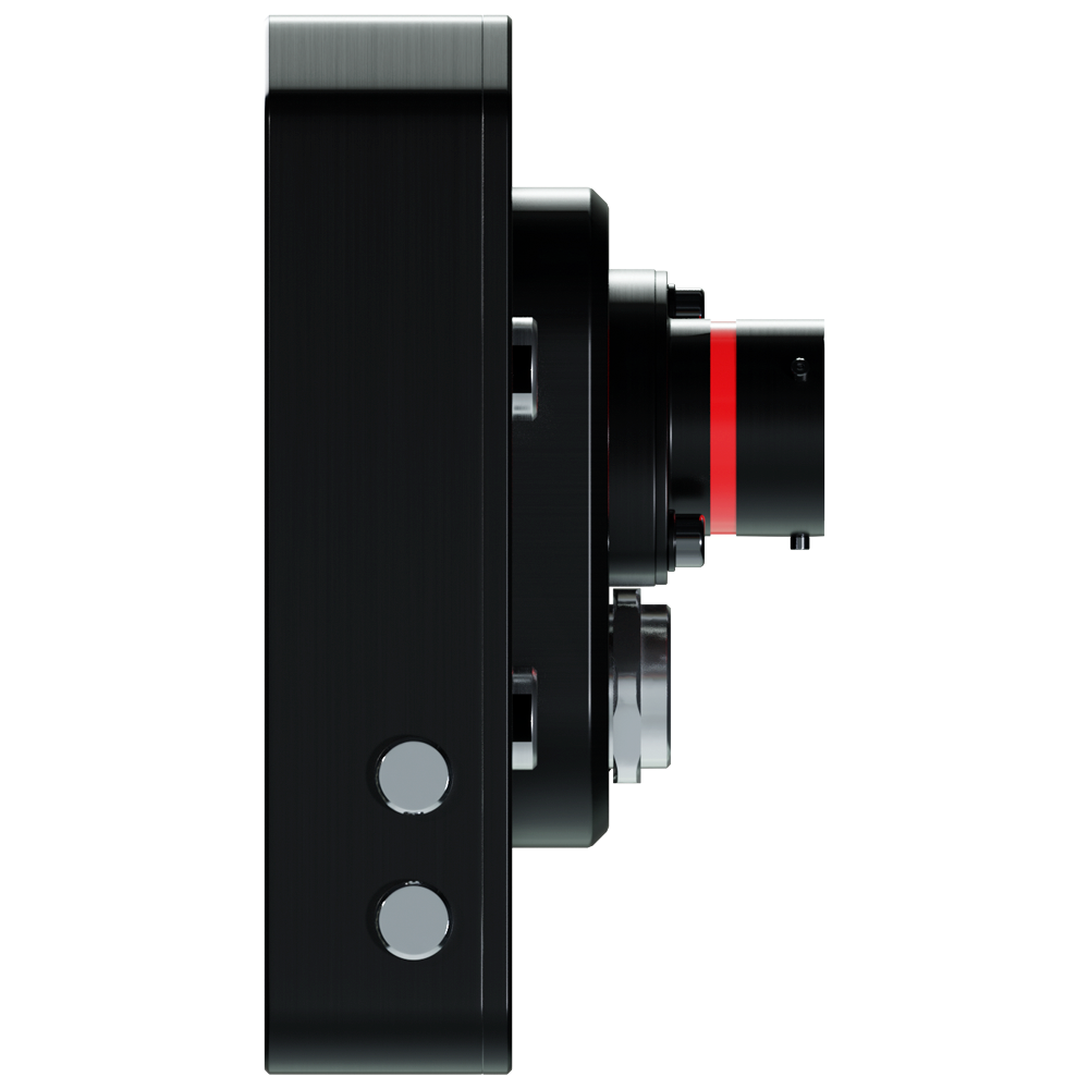

The MXP dash logger has a 6" TFT display which has been designed to acquire and display data coming from the ECU.
6" TFT display GPS Module included
CAN output 10 configurable RGB LEDs shift lights
Integrated shift array 37 pin harness
AiM MXP 6" TFT World SSP600 FIM Kit
AiM has designed a specific connection cable for the World SSP 600 bikes.
The 37 pins Deutsch harness can read transmitted data from the ECU via CAN and power up the system.
This kit is compatible with:
World SSP 600 Bikes (with MecTronic) - MKE7 ECU) 2019/2020
 Please see the technical sheet for the information on the Sumitomo connection kit, which also includes the information regarding the pinout and Race Studio 3 configuration.
It shows a vast amount of protocols, Channel Name & Function for Mectronik WSS 2019 V5.

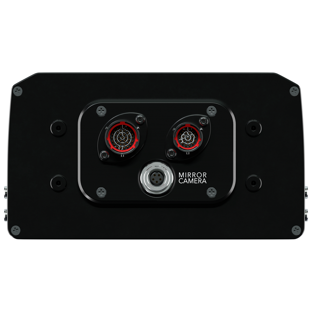

AiM MXP 6" TFT
The MXP TFT 6" comprehensive colour Dash Logger is fully configurable and suitable for many different Motorsports. It has been designed to acquire and display data coming from the ECU. The internal accelerometer and GYRO, GPS Module (included in the kit), analogue/digital inputs and predefined math channels. Performance and data acquired can also be incremented by adding up to eight expansion modules.
Connecting the MXP dash to your ECU is simple. You can sample dozens of channels straight from the vehicle ECU. This is usually the quickest and easiest setup, needing only a cable connection to the ECU instead of multiple connections and analogue sensors. The sampled data will depend on your actual ECU but typically includes RPM, engine load, throttle position (TPS), oil, air, water temperature, oil pressure, battery voltage, speed, gear, lambda value (air/fuel ratio). The list of available ECU drivers is constantly updated and upgraded and includes approximately 1000+ different ECUs.
Two Digital Outputs
MXP features two digital outputs. Each of them can give an output of 1 amp at 12 volts. They can be configured to be turned on/off depending on the value of the analogue or digital inputs. They permit automatically running external systems such as switching on/off additional lights to activate/deactivate a cooling fan or circulation pumps when a particular event happens.
The MXP has a high contrast 6" TFT display which is fully configurable. You can create and customise pages/displays to suit your requirements. You can manage to swap pages by pushing one or two pushbuttons.
Two analogue camera inputs are available to switch your display into a mirror camera through a pushbutton command or event management. The camera is sold separately.
  • Display: 6" TFT Display
  • Brightness700cd/m2 - 1,100 Lumen
  • CAN connections: 3
  • ECU connection: CAN, RS232 or K-Line to 1,000+ industry-leading ECUs
  • Second CAN: Yes
  • Wi-Fi connection: Yes
  • Accelerometer: Internal Three-axial ± 5G + Three-axial Gyroscope
    + 3 axis magnetometer
  • Internal Memory: 4 GB
  • Body: Anodized Aluminium
  • Pushbuttons: Metallic
  • Power Consumption: 400mA
  • Weight: 640g
  • Waterproof: IP65
  • MXP 1.2 Dash Logger
  • 37 pins harness
  • GPS Module
  • Connection Kit
  • 1 x 6 pins male Sumitomo connector
  • 4 x Sumitomo connector male pins
  • 4 x rubber wire seals
  • 2 x dummy plugs
