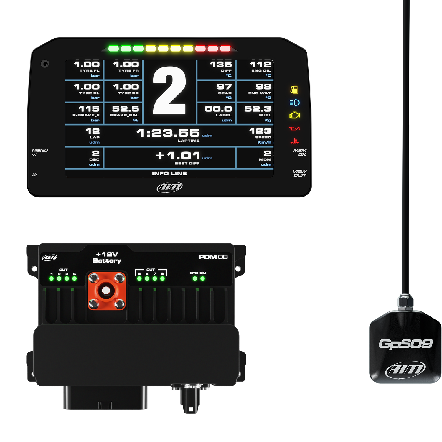

AiM PDM08 With 6" Road Icons Display GPS Data Logging Kit
The AiM PDM08 is an eight-channel advanced power distribution module designed to power a multitude of vehicle circuits, removing the need for traditional fuse boxes and relays. The 6" TFT display with road icons features a fully configurable display with a range of layouts to choose from and a GPS Module providing easy lap timing and lap position for track mapping.
8 RGB LEDs Six analogue digital inputs
GPS lap timing  Power outputs
Data logging facility Two-speed inputs
Power Distribution Module
The AiM PDM08 is an eight-channel advanced power distribution module designed to power a multitude of vehicle circuits, removing the need for traditional fuse boxes and relays. It allows for a simplified wiring harness with increased reliability and control functions.
The PDM08 can receive data from the vehicle ECU and even includes a data logger and GPS Module for lap timing and track mapping. The GPS Module is available with cables from 50cm up to 4m. There is also a GPS roof version available in 2m or 4m.
PDM08 Power Outputs
The PDM8 features eight high sided outputs: 1 x with series diode rated up to 20A, 1 x rated up to 25A, 6 x rated up to 15A. Total continuous max current 100A.
Each of the outputs provides feedback to the data logger to provide vital information such as open circuits, short circuits, high/low voltage, the number of fault retires, and the time between the reties is user-definable.
PDM08 Inputs
The PDM08 features 6 x analouge/digital inputs, and 2 x speed inputs.
PDM08 Data Management
The PDM08 can receive and record data from the following sources, ECU - Over 1000 protocols available. Digital/analogue inputs. Internal nine-axis EMU. GPS - Lap time and position.
Dash Display 6" Road Icons
6" TFT display Road Icons
Five - Status LEDs Ten - Shift light LEDs
Configurable display Range of layouts
Suitable for replacing all of the dashboard gauges and warning lamps, the TFT dash display is available in 6" or 10" versions and with "Race" or "Road" icons. Both versions have full user-configurable displays and offer a range of layouts.
GPS Options available with this kit
The GPS09 module is available with various lead lengths to suit different applications and with cable entry from underneath (roof version) or the side. With a 5 pin binder connection.

  • LEDs: 8 RGB LEDs + 1 PDM ON + 1 PDM STS (Status)
  • Inputs:
  • Six fully configurable, max 500 Hz each
  • Pullup + 12V, + 5V, analogue/digital
  • Pull down
  • Speed IN: 2
  • Power Outputs:
  • 1 with serie diode rated up to 20 A
  • 1 rated up to 25 A
  • 6 rated up to 15 A
  • Protected for: over-voltage, under-voltage, undercurrent, over temperature
  • Total max current: 100 A
  • Lin Bus: 1
  • CAN connections: 3
  • Internal platform: 3 axis ±5G accelerometer + 3axis gyro + 3 axis magnetometer
  • Internal memory: 4 GB
  • External modules: GPS Module, Channel Expansion, TC Hub, Lambda Controller, SmartyCam HD, Formula Steering Wheel, Remote I/O pushbutton module
  • External Analog Camera input: NO
  • Connectors: 1 AMP connector + 1 Amphenol Surlok connector + 1 Rosenberger connector
  • Remote display connection: 1 AiM stream output
  • Body: Anodized Aluminium
  • Dimensions: 161 x 100.6 x 50.6mm
  • Weight: 500g
  • Waterproof: IP65
  • AiM PDM Dash 6"
  • Display: 6" TFT
  • Contrast: 600:1
  • Brightness: 700cd/m2 - 1,1000 Lumen
  • Ambient light sensor: Yes
  • Status information LEDs: 5
  • Shift light LEDs: 10
  • Pushbuttons: Metallic
  • Connectors: LVDS Link 4 pins Rosenberger male connector
  • Weight: 640g
  • Power consumption: 150 mA
  • Waterproof: IP65
  • GPS Module
  • 5 Pin Binder connection
  • Weight: 60.5g
  • Power Distribution Module PDM08
  • TFT Screen 6" Road Icons
  • GPS Module
  • x 2 35 pins AMP connector
  • Surlock connector
  • Rosenberger LVDS connector
  • Download lead
