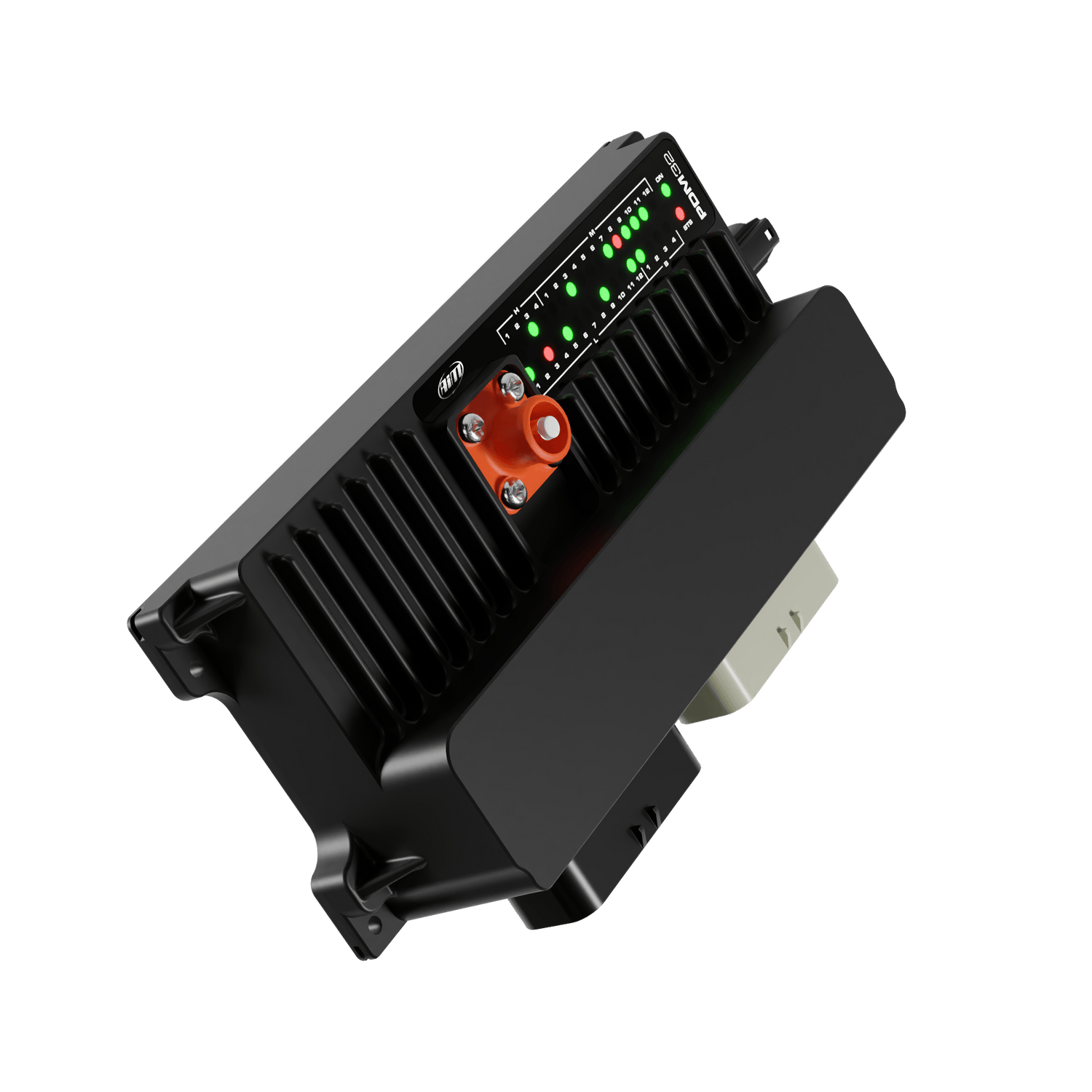

The AiM PDM32 is a 32 channel advanced power distribution module designed to power a multitude of vehicle circuits, removing the need for traditional fuse boxes and relays.
32 RGB LEDs Eight analogue digital inputs
GPS lap timing (optional) Four digital inputs
Data logging facility Two-speed inputs
28 High side outputs 4 Half-bridge outputs
Power Distribution Module
The AiM PDM32 is a 32 channel advanced power distribution module designed to power a multitude of vehicle circuits, removing the need for traditional fuse boxes and relays. It allows for a simplified wiring harness with increased reliability and control functions.
The PDM32 is available on its own or with a choice of 6" or 10" dash displays. It can receive data from the vehicles ECU and even includes a data logger and optional GPS module for lap timing and track mapping.

The PDM32 features 28 high sided outputs and four half-bridge outputs: 4 x rated up to 20A (high power), 12 x rated up to 15A (mid-power), 12 x rated up to 10A (low power), 4 x rated up to 35A (half-bridge). Total continuous max current 120A.
Each output provides feedback to the data logger to provide vital information such as open circuits, short circuits, high/low voltage, the number of fault retires, and the time between the reties is user-definable.

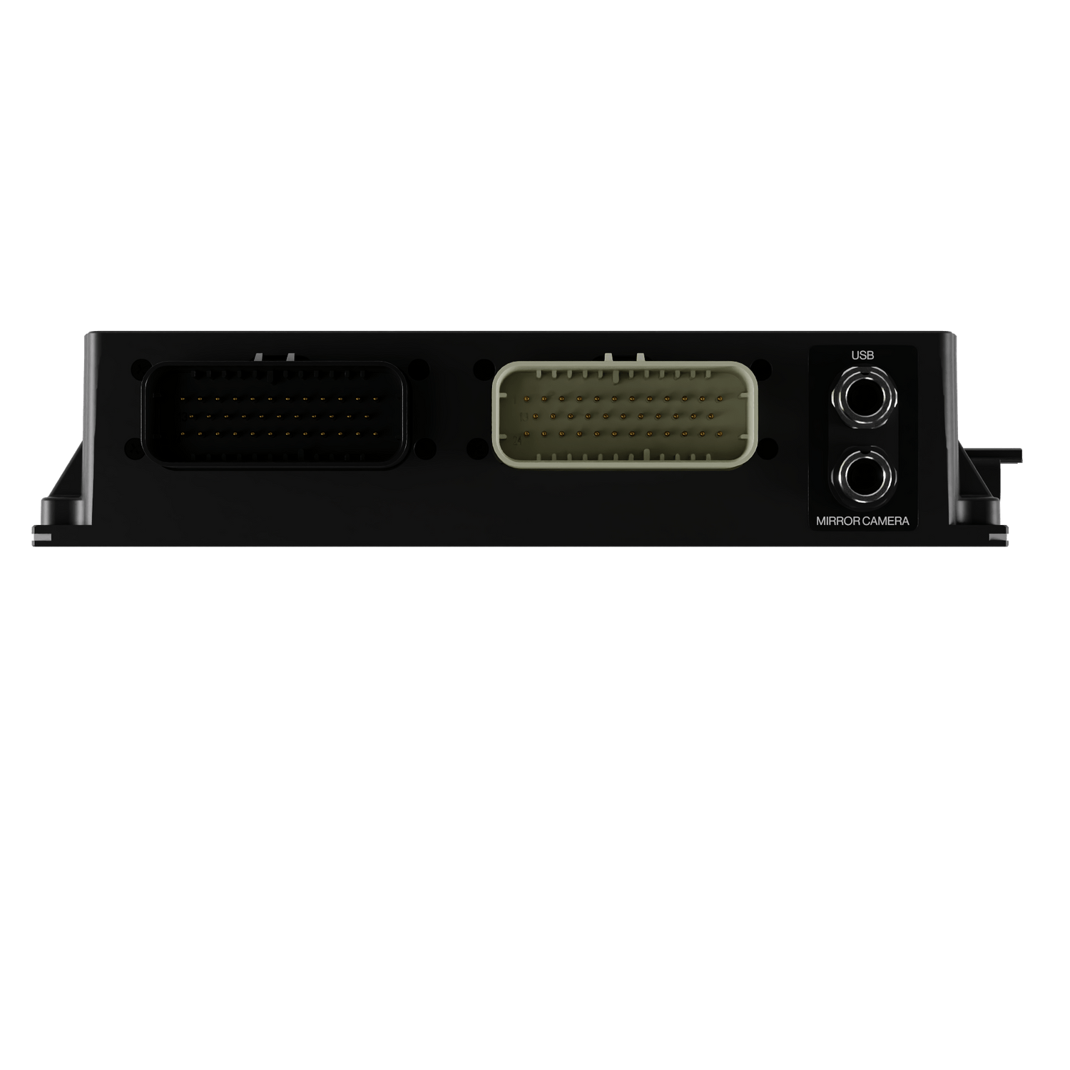

  • Connectors: 2 AMP connectors + 2 Binder connectors + 1 Amphenol Surlok connector + 1 Rosenberger connector
