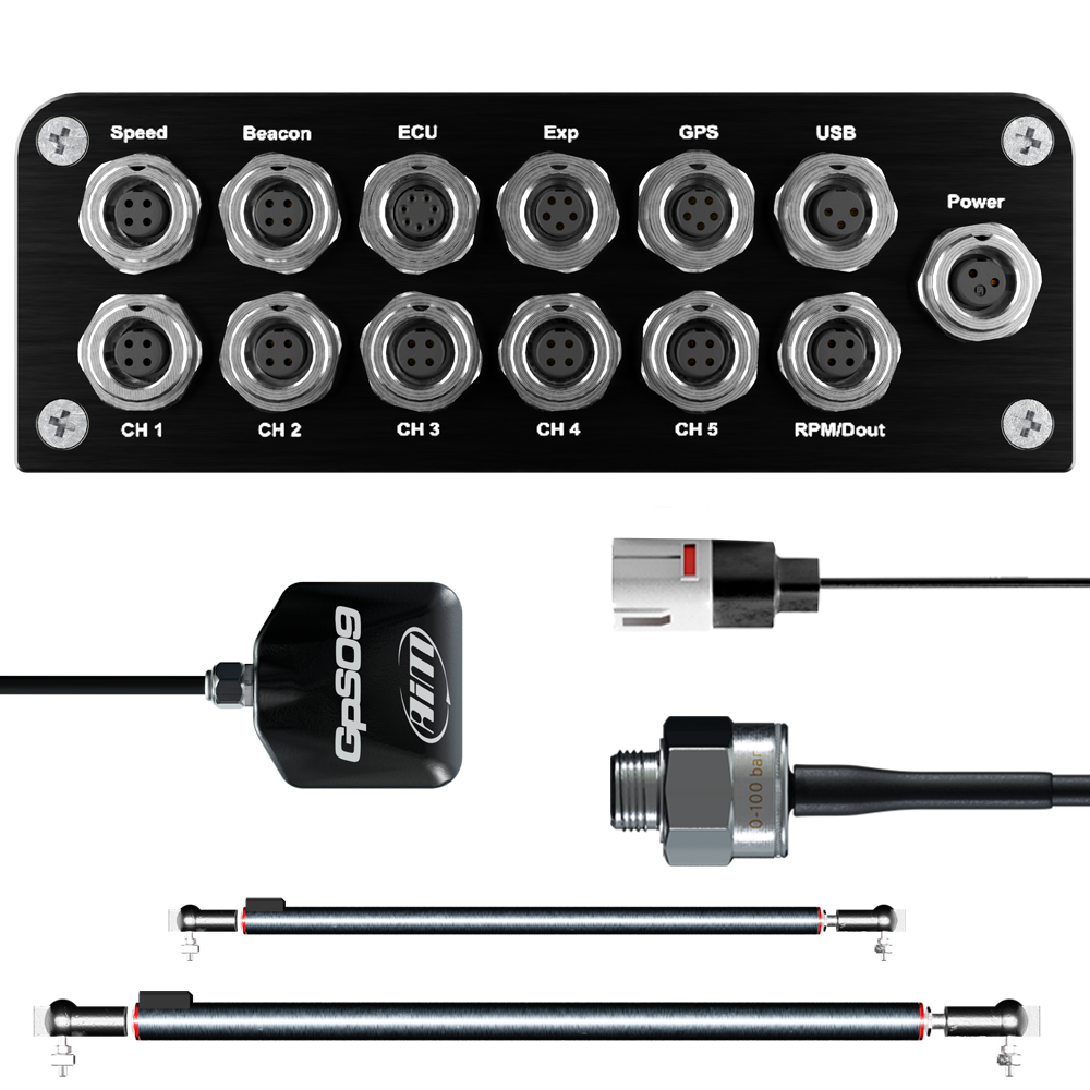

Combine the XLog, a small, waterproof, 25Hz GPS data logger; the ACC3, our unbeaten Analogue CAN Converter; Suspension Potentiometers; M10 0-100 Bar Brake Pressure Sensors, and you can even connect the ultimate motorcycle camera - the SmartyCam 3 GP, to become the best rider and beat your best lap times.
Why Choose the XLog Motorcycle Kit
It provides a powerful solution for anyone who wants to capture and analyse their performance data without needing an on-board display. Combined with the ACC3, Suspension Potentiometers and M10 0-100 Bar Brake Pressure Sensors, you will find the ultimate key to control, analysis and improvement.
Brake pressure sensor is available in PSI or Bar variants
0-100 Bar M10 Brake Pressure Sensor & Banjo Bolt Adaptor
The M10 0-100 Bar Brake Pressure Sensor allows you to detect fluid and air pressures. It offers a high level of reliability and endurance and is protected against the high vibration, shock and high temperatures found in motorsport.
The Brake Pressure Sensor comes with a Double Banjo Bolt M10 Adaptor which allows for easily installation. It fits neatly into existing hydraulic systems and has a high-quality construction for durability and leak-free performance.

XLog
  • USB Connection: Yes
  • GPS: 25Hz
  • Wi-Fi: Built in
  • Bluetooth: Built in
  • Expansions: ACC3, Lanbda Sensors, SmartyCam
  • RPM Input: 1
  • Push Button: 1
  • Status LED: 1
  • External Power: 9-15V
  • Weight: 150g approx.
  • Waterproof: IP65
