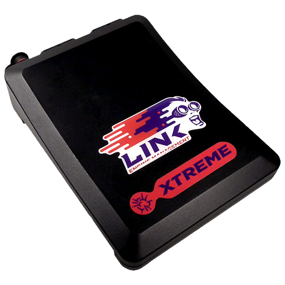

    Link G4+ Xtreme WireIn ECU
    The Xtreme is one of Link’s premium ECU’s with more inputs, outputs and features.
    The Xtreme has Peak and Hold Injection, built-in E-throttle and all the advanced features including Anti-lag, Cruise Control and Traction Control
    With 8 Peak and Hold Injector drives and 8 ignition drives the Xtreme can control up to 4 rotors or 8 cylinders with sequential injection and direct spark. The Xtreme is a great choice for professional-level motorsport or more demanding road car applications.
    Requires "A" & "B" Looms.
    If it is Onboard Digital Wideband Lambda Control you are after, consider the Fury.
    Inputs
    8/10* x Digital inputs
    4 x Temperature inputs
    11 x Analogue inputs
    2 x Trigger inputs
    2 x Knock inputs
    * 2 inputs required when using 2nd CAN Bus
    Outputs
    8 x Peak and Hold injection drives
    8 x Ignition drivers
    10 x Auxiliary outputs^
    +5V Sensor power supply
    +8V Sensor power supply
    ^unused fuel and ignition drives can be used as additional Aux outputs
    Communications
    2* x CAN bus
    1x Serial (RS232) connection
    1x USB tuning connection
    Physical
    Dimensions: 185mm(L) x 130mm(W) x 40mm(H) (without looms)
    Mass: 680g
    Advanced features not found on the Storm:
    8 Peak and Hold injection drives, user-definable current, 10 amp peak, 3 amp hold max.
    Fully programmable E-throttle control complete with the capability of gear shift throttle blip and anti-lag.
    Cruise control.
    Two independent CAN modules.
    30 general-purpose tables (up from 20)
    All Motorsport features including full gear shift control, cruise control, traction control, anti-lag and launch control.
    Advanced closed-loop lambda strategy and dual bank lambda control.
    * Requires "A" & "B" looms or "A" & "B" connector kits.
