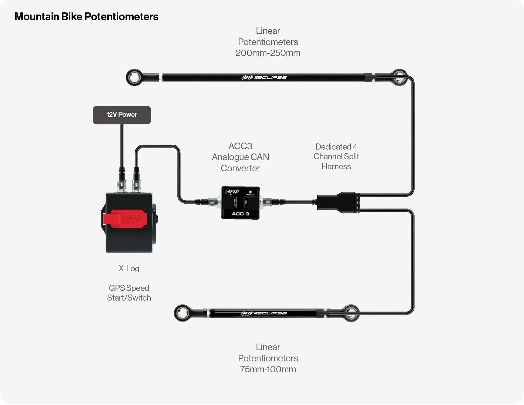

Mountain bike suspension potentiometers are available for the front 200mm and 250mm and the rear 75mm and 100mm. They are used to measure the displacement between two points using a sensor (linear potentiometer) directly connected to the points of measure. This potentiometer can measure linear displacements like dampers compression or extension and steering rotation measured through the rack displacement.
