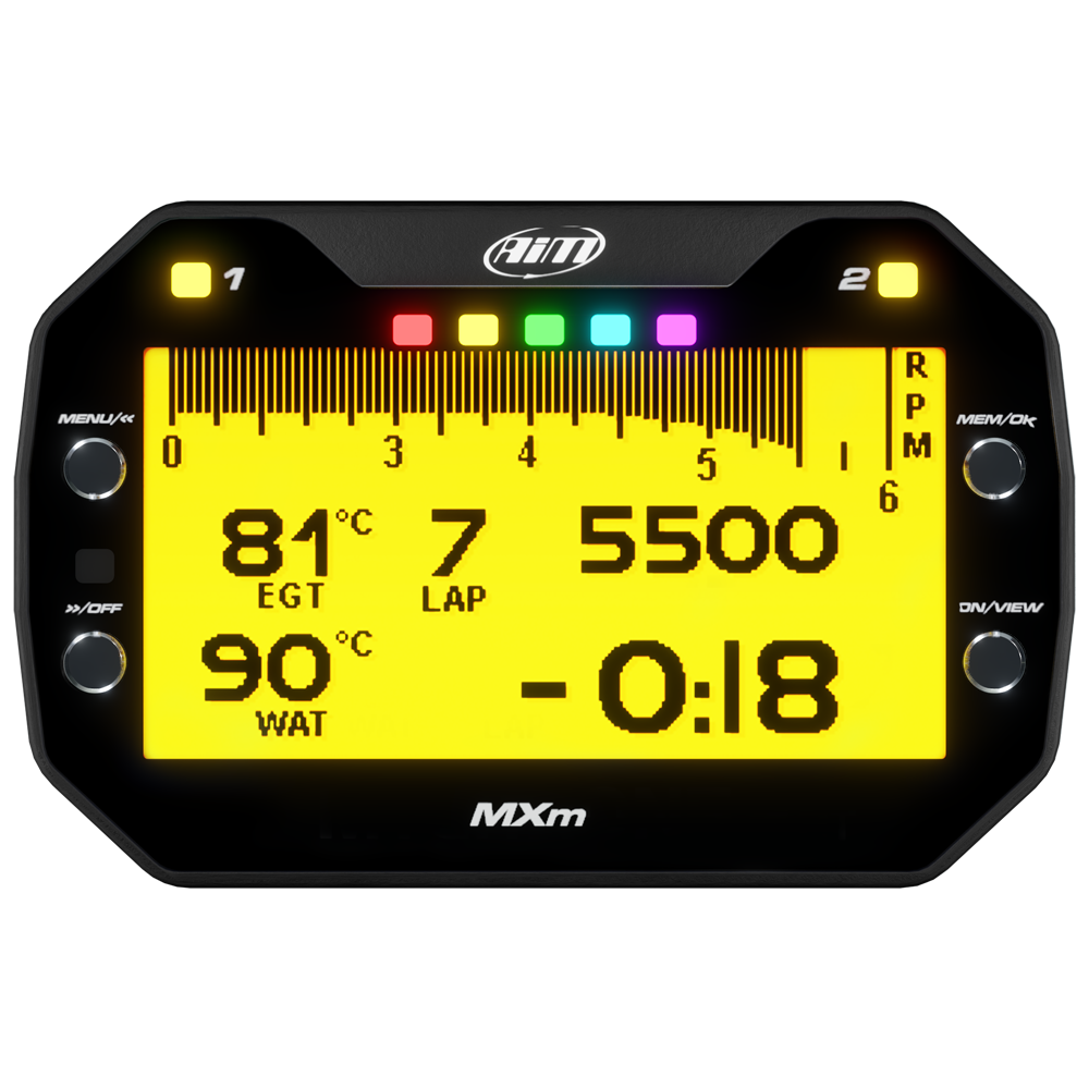

The display has an integrated shift light system that features 5 fully configurable LEDs which can be customised to your requirements and for each gear. Two further LEDs can be configured to operate as warning alarms. These warning lights can be customised, and whether you want a solid or a flashing style alarm, even the flashing frequency can be tailored to suit your requirements.
Sharp Liquid Crystal Display
Making use of a sharp liquid crystal screen, you can select which information you want displayed and the backlight can be switched between 7 available colours, all with high contrast and easy to read graphics. The information that is displayed on the screen can be fully configured by the user to prioritise the most important information for the driver. If there is simply too much information to be shown on the screen, the driver can scroll between multiple pages using the integrated buttons so that nothing is missed.
After the session has concluded, all of the data can be recalled on the screen including a summary of the driver's best laps along with max/min RPM, speed and temperatures. If you would prefer to go through the data in more detail, the MXm features a Wi-Fi function to enable fast and secure data transfer to a laptop or PC up to 50 metres away, so you no longer need to take the laptop to the car.

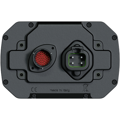

  • Connectors: 37 pins Motorsport connector + 4 pins power connector
