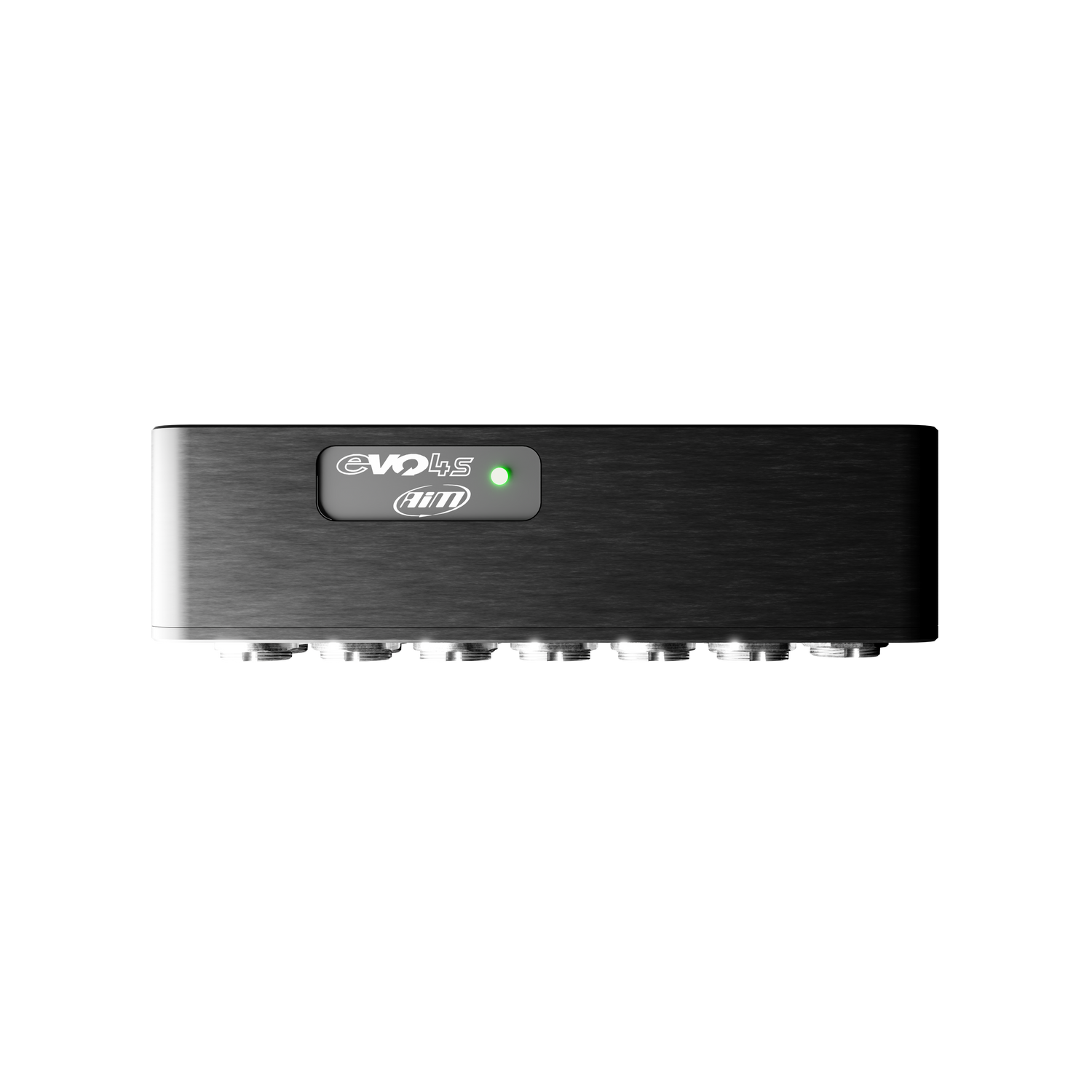

The AiM EVO4S is a powerful and flexible data logger and comes equipped with a GPS Module. Offering one connector per channel the EVO4S samples all the information you need, data coming from your vehicle's ECU via CAN, RS232 or K-Line, from the internal accelerometers and gyro and the GPS Module included in the kit.
From analogue/digital inputs, external expansions as well as predefined math channels. Sensors can be connected to 5 configurable analogue channels, to the RPM input and to 2 wheel speed inputs.
Select which harness you require CAN, RS232 or OBD11, and select which GPS Module best meets your requirements. You can also upgrade your kit with our GS -Dash display and Formula 3 steering wheel, allowing you to really improve your performance on track days.
Sensors
5 fully configurable analogue channels with configurable 12-bit o-5 Volt, 0-5000 mV inputs or thermocouple input, used to sample data coming from the temperature, pressure, suspension and other sensors.
2-speed inputs which will allow you to monitor different wheel behaviours.
Tri-axial accelerometer and gyro is a built-in inertial platform that allows you to understand oversteering, understeering and banking etc.
2 CAN Interface allows you to send messages directly to an existing CAN network to help improve the range of vehicle control possibilities.
4GB memory
ECU interface - CAN-Bus, RS232, K-Line and OBDII
RPM input manages square wave signals transmitted by the ECU, or pulse signals picked from the coil command (low voltage).
Add optional expansion modules
You can add optional expansion modules via the built-in CAN bus.
Channel Expansion: Permits to add 4 0-5volt analogue channels for pressure, temperature sensors and potentiometers (suspension, steering angle). Two of these channels can be configured to receive digital inputs like wheel speed.
TC Hub: Adds up to four "K" type thermocouple temperature sensors.
LCU-One Lambda Controller: Wideband Lambda controller LCU-one, with Bosch LSC 4.9 probe provides air/Fuel data, lambda value and exhaust gas temperature.
SmartyCam HD/GP HD Cameras: Onboard cameras that overlay onto all your videos all the data sampled by your logger.
These are only some of the items that can be added to our EVO4S for incrementing the performance and the data acquired.
With Race Studio 3 you can also analyse all data recorded by EVO4S and downloaded to your PC: graphs, histograms and tables will help you study your performance, providing an objective support to avoid mistakes and improve performance.

  • ECU Connection: CAN, RS232, K-Line
  • External Modules Connection: GPS Module, Channel Expansion, TC Hub, Lambda Controller, SmartyCam HD
  • Analog Inputs: 5 fully configurable, max 1,000 Hz each
  • Digital Inputs: 2-speed inputs, lap signal, coil RPM input
  • Inertial Platform: Internal 3 axis ±5G accelerometer + 3 axis gyro
  • Internal Memory: 4GB
  • Connectors: 13 Binder connectors
  • Body: Anodized Aluminium
  • LEDs: 1 system staus
  • Dimensions: 130 x 35 x 46.6mm
  • Weight: 330g
  • Waterproof: IP65
