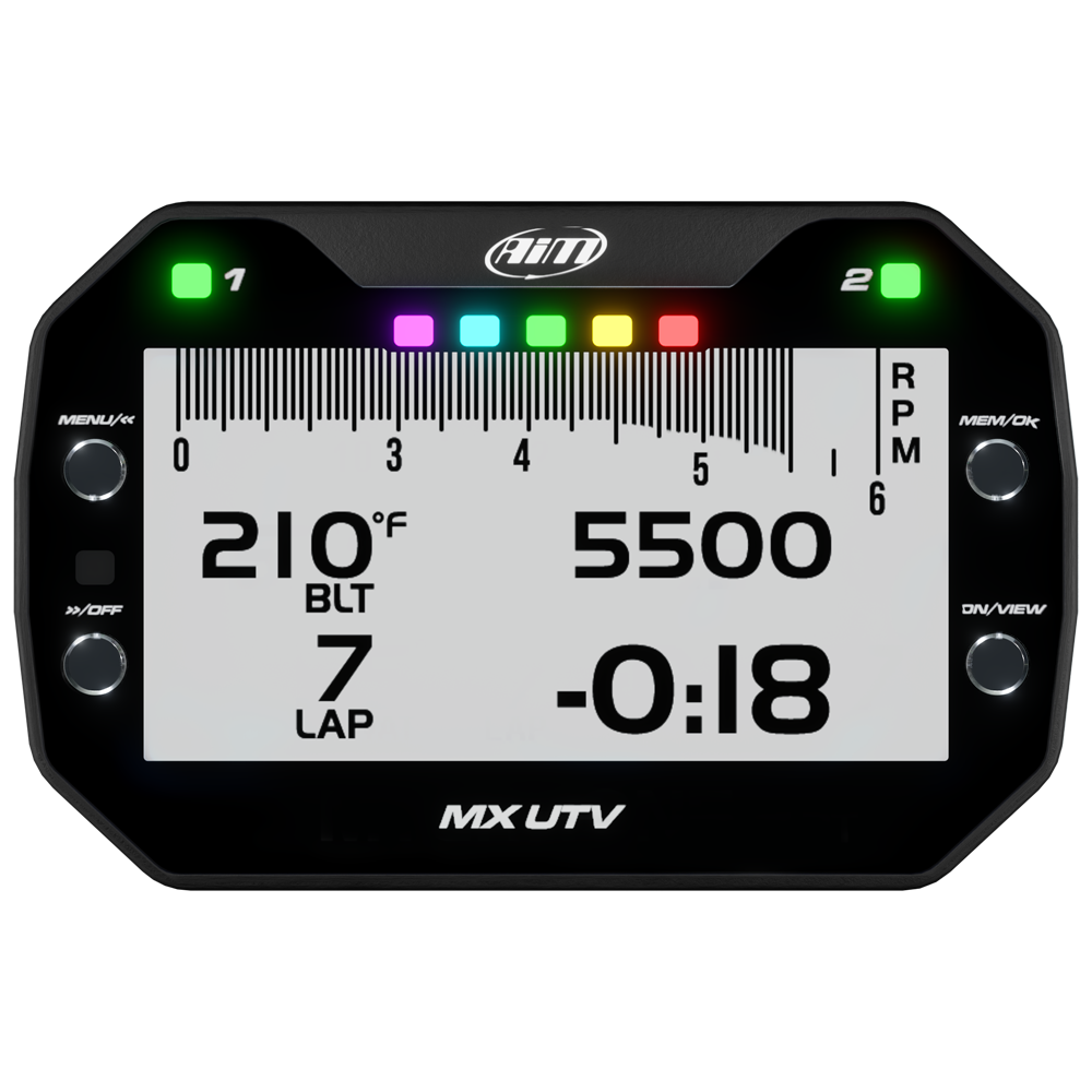

To compute lap times the MX UTV Dash Logger uses GPS and Glonass data to the precision of 1/100 second. If the track your at is not already on the database it will automatically recognise it and locate the start and finish line position.
The MX UTV acquires data coming from your vehicle's ECU. Also due to transmission belt temperature being one of the main concerns for UTV drivers the infrared temperature sensor included in this kit makes it possible to constantly check the temperature by reading it directly on the display screen.
The MX UTV Dash Logger features a wide LCD screen offering a choice of eight configurable RGB backlights. Also featured is an ambient light sensor that automatically switches the backlight on when encountering low light conditions. The 4.3" screen is wide enough and bright enough to see all the data you what to see while your racing.
Transmission Belt Temperature
Transmission belt temperature is one of the main concerns for UTV drivers. The infrared temperature sensor in this kit makes it possible to constantly check the temperature on your display screen while your racing.
Also, the configurable RGB LEDs at the top of the Dash Logger will turn on when the temperature gets to the critical level.
Configurable RGB LEDs
The top of the MV UTV features five LEDs. These can be configured to be used for two different functions, gear shift light or predictive lap time.
If you configure the LEDs for gear shift lights and this will help you choose the best instant to shift gear.
If you configure the LEDs as the predictive lap time, they will give you a constant idea of how you are improving your lap times.
While allowing RPM monitoring at a glance, the alarms are flexible too, you can configure the situation that generates the alarm, the LED behaviour (blinking frequency and colour) when the alarm appears and the conditions for its switch off.

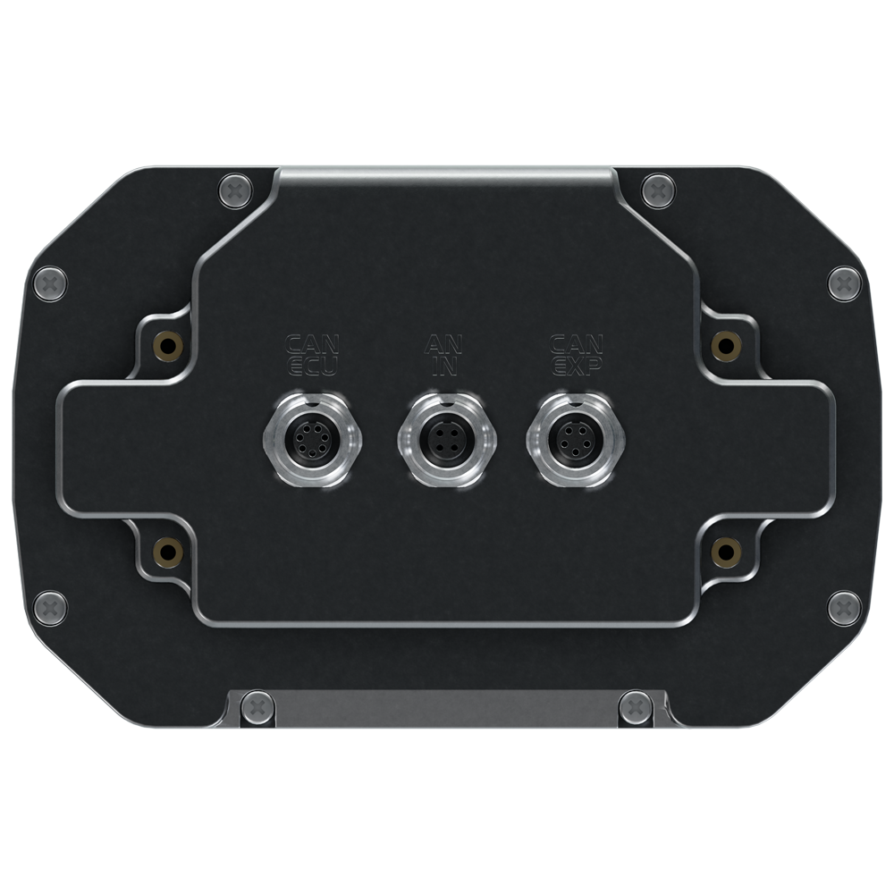

  • Connectors: 3 Binder Connectors
