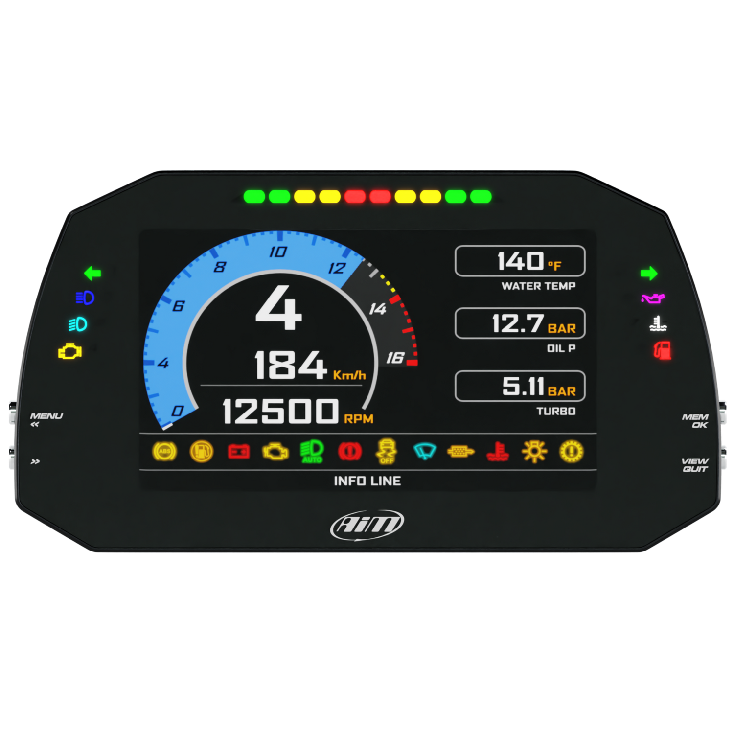

The MXG 1.3 Strada has a 7" high contrast TFT display. The visual quality is kept optimised by the ambient light sensor which keeps he backlight to its best brightness levels, so as to avoid the screen dazzling you while driving in the dark.
Pre-configured Pages
The MXG 1.3 Strada shows the RPM scale and all the data you need, like speed, water temperature and oil pressure, lap times and much more. You can custom pages to suit your requirements, including up to four additional fields. Define what data is shown with the end of scale and measure units. Swapping between the pages is easy just use the pushbuttons.

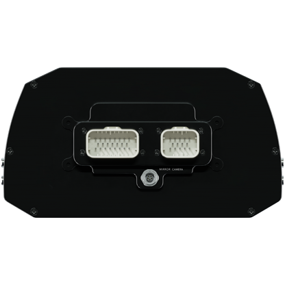

  • 14 Pin Standard Wiring
  • IVA Loom
