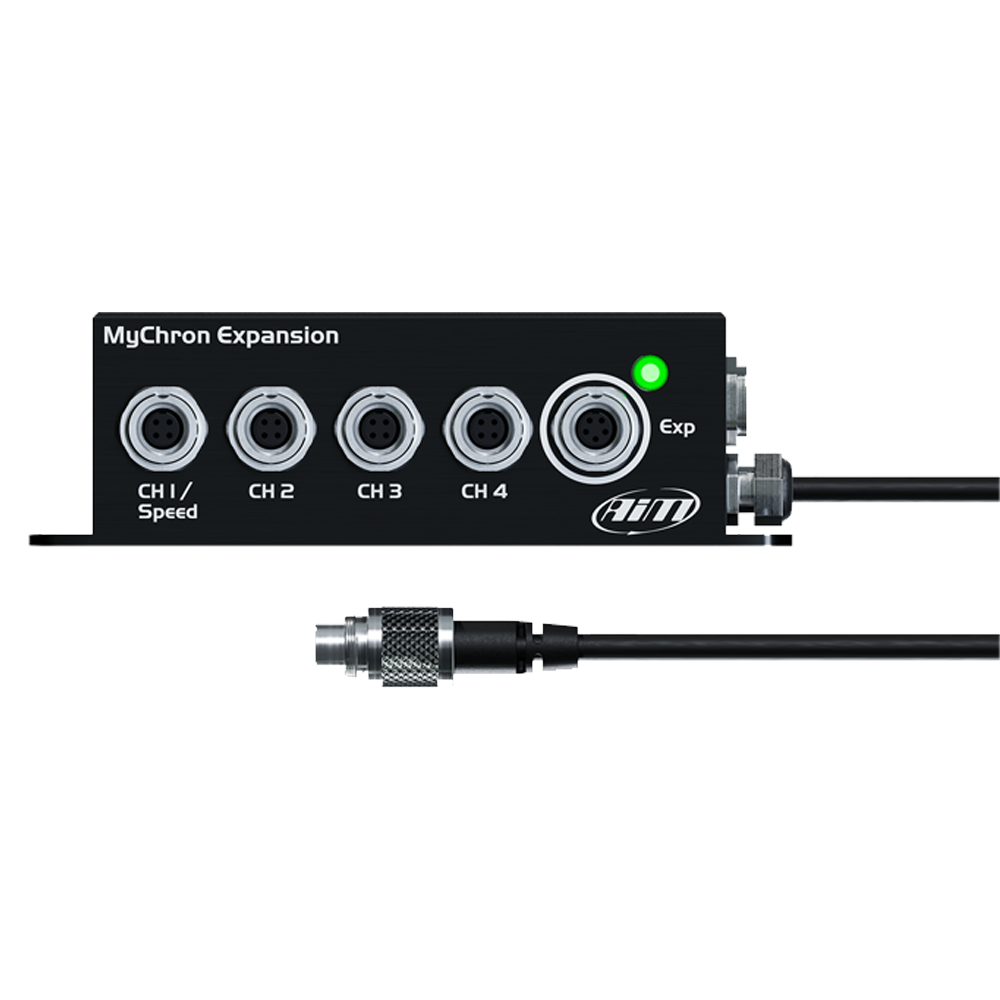

AiM Mychron Expansion
The AiM Mychron Expansion is a channel multiplier used for improving the Mychron5 S & Mychron5 S 2T performances.
10Hz sampling frequency Four additional analogue inputs
CAN connection Connection for further expansion
Mychron Expansion
The AiM MyChron Expansion is an add-on for the MyChron4, MyChron5, Mychron5 S and Mychron5 S T2 Kart Racing Data Logging Dash.

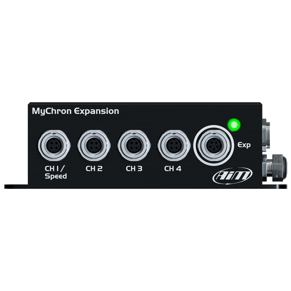

It plugs into the CAN expansion port on your MyChron dash to expand its capabilities. The Expansion has a single CAN expansion port plus four additional sensor inputs.
All four inputs can accept our karting sensors (brake/throttle pedal position, temperature, steering angle, etc.). One of the four inputs can accept a speed sensor.
The Mychron requires an external 12-volt power source such as your kart's battery.

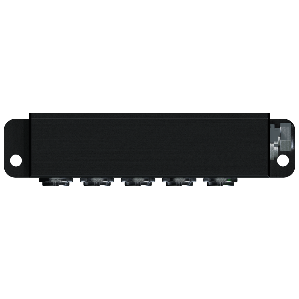

  • Dimensions: 127 x 24 x 33mm
  • Weight: 194g
  • Sampling Frequency: 10Hz
  • Waterproof: IP65
  • Power: 2 pin Binder 712 Female connector

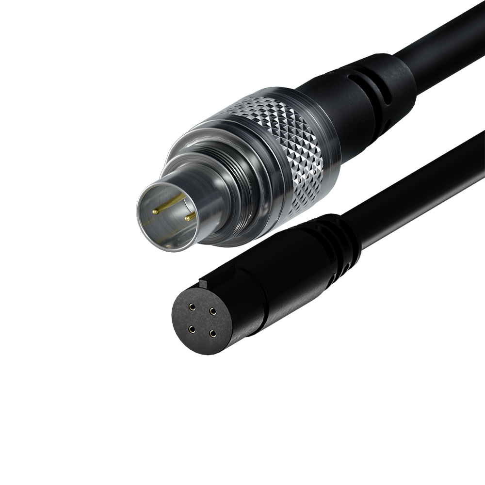

  • Channel 1, 2, 3, 4: 4 pin Binder 712 Female connector
  • EXP: 5 pin Binder 712 Female connector

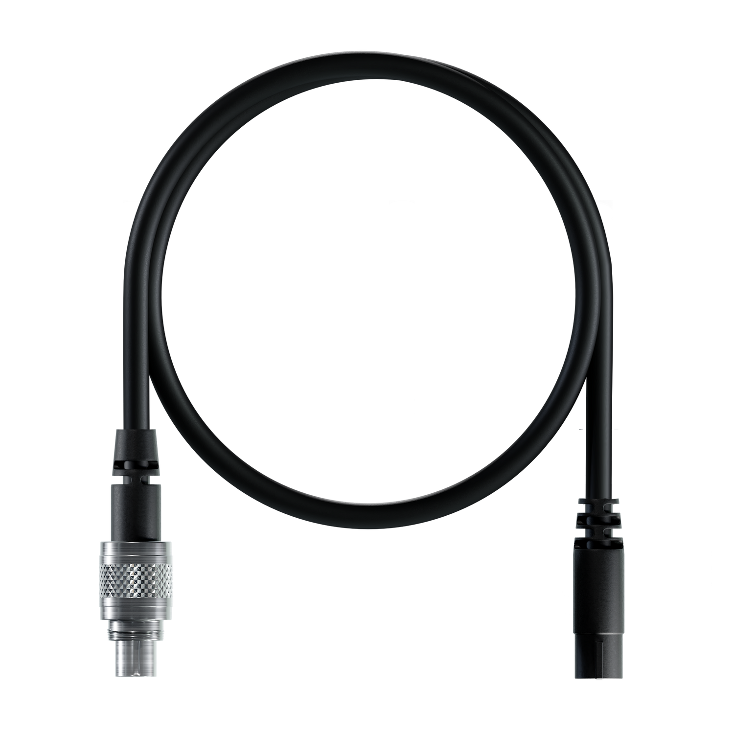

  • Patch Lead

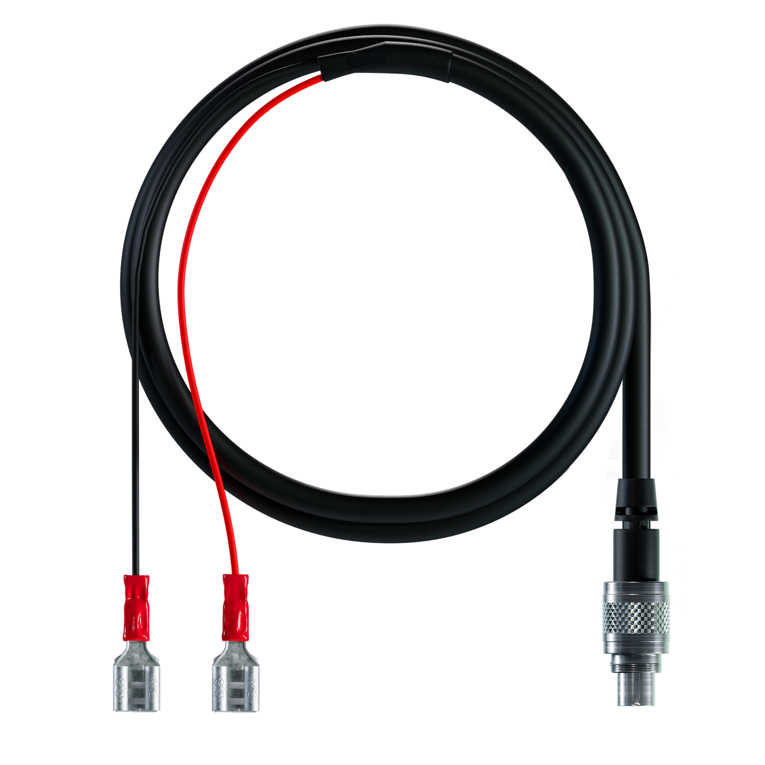

  • External Power Lead
