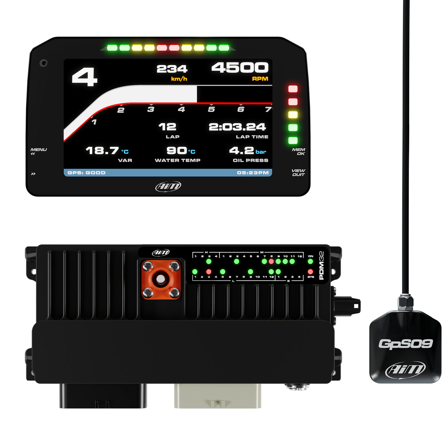

AiM PDM32 With 6" Race Icons Display GPS Data Logging Kit
The AiM PDM32 is a 32 channel advanced power distribution module designed to power a multitude of vehicle circuits, removing the need for traditional fuse boxes and relays. The 6" TFT display with race icons features a fully configurable display with a range of layouts to choose from and a GPS Module providing easy lap timing and lap position for track mapping.
32 RGB LEDs | Eight analogue digital inputs |
GPS lap timing | Four digital inputs |
Data logging facility | Two-speed inputs |
28 High side outputs | 4 Half-bridge outputs |
Power Distribution Module
The AiM PDM32 is a 32 channel advanced power distribution module designed to power a multitude of vehicle circuits, removing the need for traditional fuse boxes and relays. It allows for a simplified wiring harness with increased reliability and control functions.
The PDM32 can receive data from the vehicle ECU and even includes a data logger and GPS Module for lap timing and track mapping. The GPS Module is available with cables from 50cm up to 4m. There is also a GPS roof version available in 2m or 4m.
PDM32 Power Outputs
The PDM32 features 28 high sided outputs and four half-bridge outputs: 4 x rated up to 20A (high power), 12 x rated up to 15A (mid-power), 12 x rated up to 10A (low power), 4 x rated up to 35A (half-bridge). Total continuous max current 120A.
Each output provides feedback to the data logger to provide vital information such as open circuits, short circuits, high/low voltage, the number of fault retires, and the time between the reties is user-definable.
PDM32 Inputs
The PDM32 features 8 x analogue/digital inputs, 4 x digital-only inputs and 2 x speed inputs.
PDM32 Data Management
The PDM32 can receive and record data from the following sources, ECU - Over 1000 protocols available. Digital/analogue inputs. Internal nine-axis EMU. GPS - Lap time and position.
Dash Display 6" Race Icons
6" TFT display | Race Icons |
Five - Status LEDs | Ten - Shift light LEDs |
Configurable display | Range of layouts |
Suitable for replacing all of the dashboard gauges and warning lamps, the TFT dash display is available in 6" or 10" versions and with "Race" or "Road" icons. Both versions have full user-configurable displays and offer a range of layouts.
The display also doubles up as a reversing mirror using a separately available camera—ideal for cars with limited rear vision. You can add up to 2 cameras for both front and rear views. You can find the optional Reversing Mirror Camera in the Accessories Tab.
- Inputs:
- 14 Fully Configurable, max 500 Hz each:
- 8 analogue/digital
- 4 digital inputs
- 2-speed input
- Power Outputs:
- 4 rated up to 20 A (high power)
- 12 rated up to 15 A (mild power)
- 12 rated up to 10 A (low bridge)
- 4 rated up to 35 A (half-bridge)
- Protected for: over voltage, under voltage, over current, over temperature
- Total max current: 120 A
- LEDs: 32 RGB LEDs + 1 PDM ON + 1 PDM STS (Status)
- Lin Bus: 1
- CAN Connections: 3
- Internal platform: 3 axis ±5G accelerometer + 3 axis gyro + 3 axis magnetometer
- Remote Display Connection: 1 AiM stream output
- Connectors: 2 AMP connectors + 2 Binder connectors + 1 Amphenol Surlok connector + 1 Rosenberger connector
- Internal memory: 4 GB
- External modules: GPS Module, Channel Expansion, TC Hub, Lambda Controller, SmartyCam HD, Formula Steering Wheel, Remote I/O Pushbutton Module
- External Analogue Camera input: 2
- Body: Anodised Aluminium
- Waterproof: IP65
- Dimensions: 234.5 x 94.6 x 49.5mm
