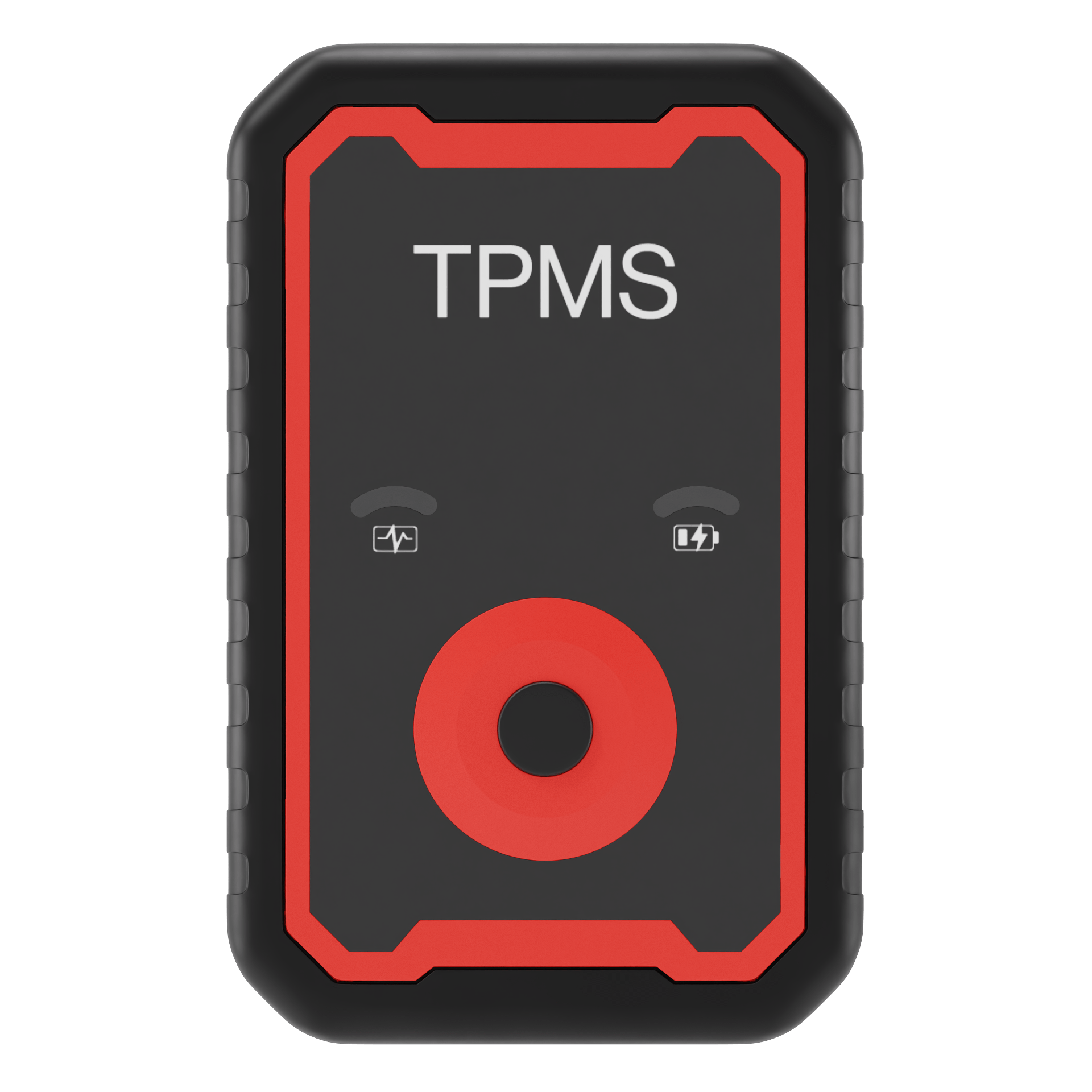

You can add a Handheld Reader / Programmer.
The handheld reader can read each wheel individually, It reads by close proximity whereas the CAN receiver uses a radio link to the sensors with the address of each sensor pre-defined as to which wheel is being measured.
