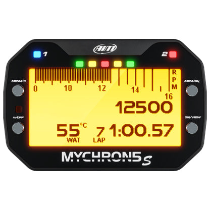

The MyChron 5S Kart lap timer features a high-resolution graphical display with built-in 25Hz GPS to sample and record lap times. The MyChron 5S combined with a choice of water temperature sensor and RPM connection makes it the ultimate karting lap timer.
The MyChron 5S logs and stores speed, lap times (including split and predictive), gear, temperature, RPM as well as data from the optional sensors when connected to the MyChron Expansion Box, such as throttle position sensors, brake position and pressure sensors, steering angle sensors and the LCU-One Lambda Controller and SmaryCam which are available in our accessories tab.
With this kit choose between an M5 or M10 Water Temperature Sensor only one supplied.
The MyChron 5S has seven display colours to choose from. This will enable you to have a clear view and easily read numerical readouts on the track such as your lap times and lap number, RPM and one temperature value. When your back at the paddock you can scroll through all your data on the display.
The Nylon chassis and metallic pushbuttons guarantee even more resistance to shock and water, while the anti-scratch non-reflecting polycarbonate screen and wider display offer great readability.
The MyChron 5S also features an ambient light sensor providing optimum viewing in diverse lighting conditions, the display brightness is automatically adjusted according to the environment light.
Shift Light & Alarm LEDs
The MyChron 5S features five RGB LED shift lights that can be configured for each gear. You can choose the colour and value threshold for the activation. Or configure them to show your best lap time/split time, monitor the RPM level.
The alarm LEDs are also easily configurable to the engine parameters you require, such as exhaust gas temperature (EGT) and water temperature.
