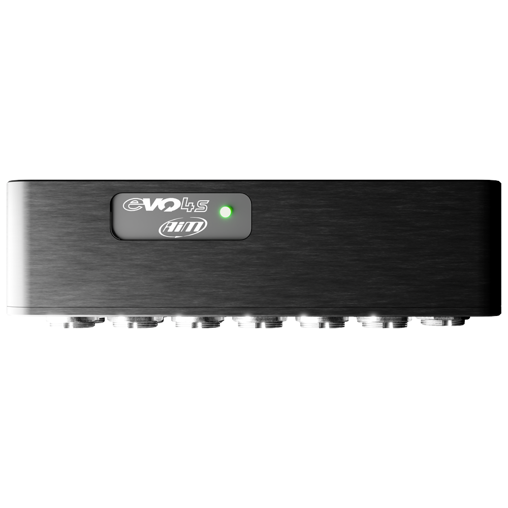

AiM EVO4S World SSP300 FiM Kit
AiM has developed a specific connection cable to the World SSP300 bikes ECU for the EVO4S. The connection cable allows you to read transmitted data from the ECU via CAN and at the same time powers up the system.
Many options for ECU GPS included
5 fully configurable analogue inputs 2-speed outputs
13 binder connections 1 LED system status
AiM has designed a specific connection cable to the World SSP 300 bikes ECU for EVO4s.
This cable will allow you to read transmitted data from the ECU via CAN, while at the same time power up the system.
  • ECU Connection: EVO4S connection cable for World SSP300 bikes (V02589100)
  • CAN Connections: 2
  • ECU Compatibility: + 1,000 industry leading ECUs
  • Expansion CAN Connection: GPS, Channel Expansions, Thermocouple Expansions, Lambda Controller, SmartyCan HD
  • Analogue Inputs: 5 fully configurable, max 1,00 Hz each
  • Digital Inputs: 2-speed inputs, lap signal, coil RPM input
  • Accelerometer: Internal Three-axial +5G + Three-axial Gyroscope
  • Internal Memory: 4GB
  • Body: Anodized Aluminium
  • Connectors: 12 Binder Connectors
  • Dimensions: 130 x 35 x 46.6mm
  • Weight: 330g
  • Power Consumption: 350 mA
  • Waterproof: IP65
