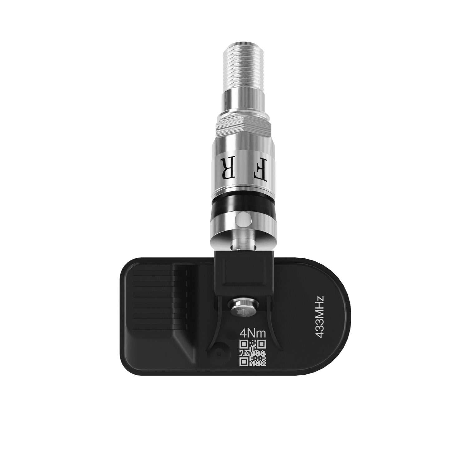

Tyre Pressure Monitoring System Single Sensor
This sensor has been specifically designed for use with our Tyre Pressure Monitoring System. Ideal to fit to spare wheels ready for mid-race tyre changes.
Ideal for spare wheelsets Lightweight rugged design
One sensor Suitable for Motorsport
This sensor has been designed for use with the AiM tyre pressure monitoring system. It is ideal if you want to add a spare set of wheels for testing purposes or mid-race tyre changes.
The whole purpose of using a Tyre Pressure Monitoring Sensor within each tyre helps to monitor specific pressure levels such as temperature readings. All the data is sent to the monitoring system where it can be analyzed and interpreted.
With this technology, each sensor has lots own serial number. And this is how the system not only distinguishes between itself and systems on other vehicles. Changes can then be made to improve the performance of your vehicle on the track.
AiM Dashes and Loggers will require a CAN Protocol which can be obtained from AiM Technologies to interface with the unit.
Please Note: The Tyre Pressure Monitoring System can be used with all of our dash loggers (Except SOLO 2).
Sensor Features
Spare sensors can be programmed with any of the serial numbers that have been allocated to the receiver.
Sensor IDs of two unmounted wheels can be swapped.
Sensors are supplied with an 11mm valve stem.
Automatic Assignment of Sensor Location (AASL)
When sensors are located in a different position of your vehicle, you can  reassign them to their new position using the TPMS handheld receiver (sold separately).
If the front wheels are swapped this operation enables you to reallocate the sensor data in the receiver so that the valves for the front left sensor are now transmitted on the CAN ID for the front right. Consequently, the sensor data that is viewed on the dashboard and logged is correct and will appear as the front right.
  • Sensor pressure range: 0-8000 mbar
  • High-frequency mode: FSK
  • Sensor temperature range: -40°C to 125°C
  • Sensor temperature resolution: 1°C
  • Sealing: IP67
  • Battery lifespan: >2.5 Million transmissions
  • RF frequency: 433.92MHz
  • High-frequency emission power: <8dBm (50ohms)
  • One Spare Sensor
