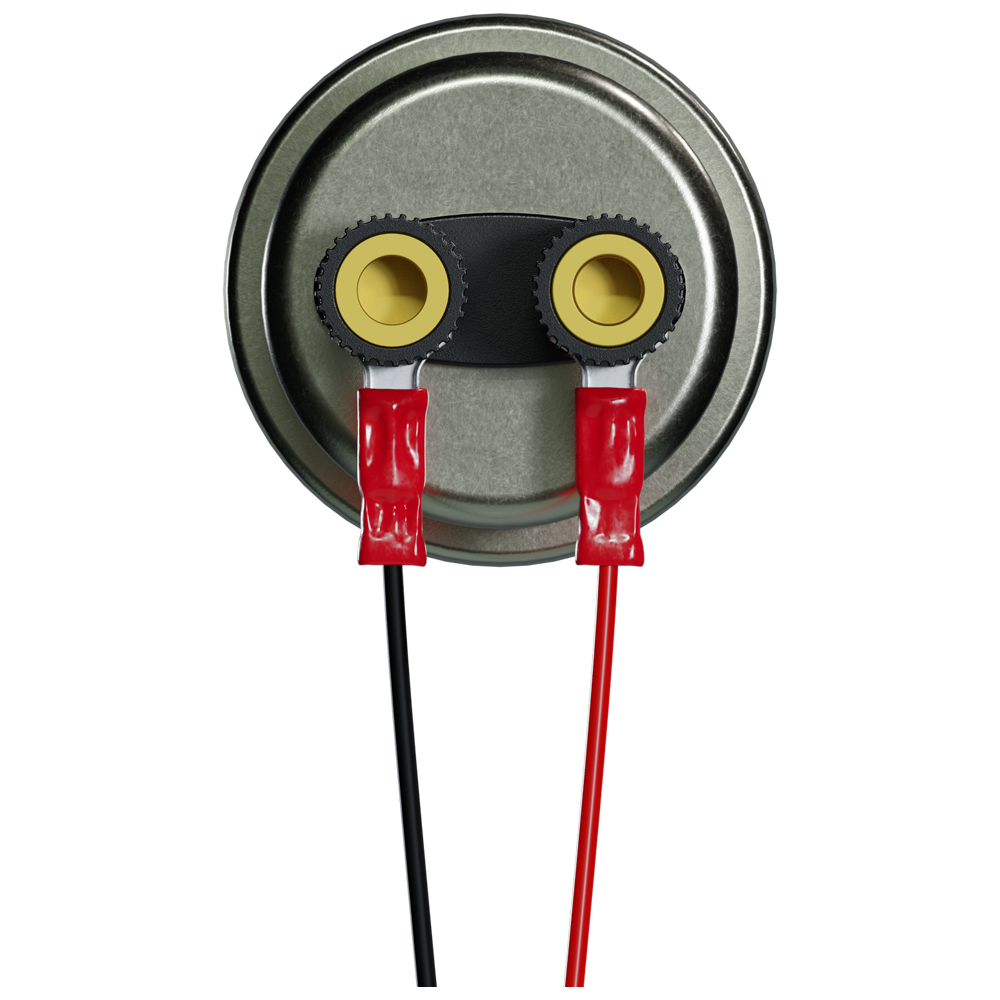

The 0-10 bar sensor is made of a cylinder – with M10*1 thread that has to be fixed directly to the engine block – and two connectors that are for GND and pressure signals. If the engine thread is more significant than the cylinder thread, Aim suggests using joints. Aim recommends you tightly screw the sensor to the engine so that vibrations do not loosen it.

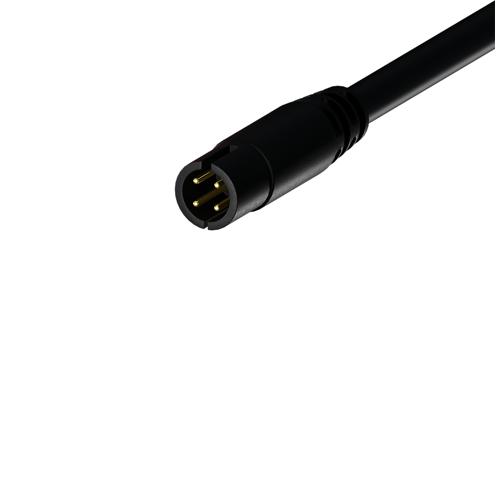

The VDO sensor cable ends with a four pins Binder 719 male connector. Between pins 1 and 4 of the connector is mounted a 1,8 kΩ resistor. Aim recommends not to tamper with the sensor, or it will not work.

The sensor comes with a 45cm cable as standard. You will most likely need a custom patch lead to suit your wiring specifications.
EVO4 / EVO4S logger / Channel Expansion are fitted with 712 connections and requires a 712 - 719 patch lead to connect these sensors.

  • Connection: 4 pins 719 male Binder

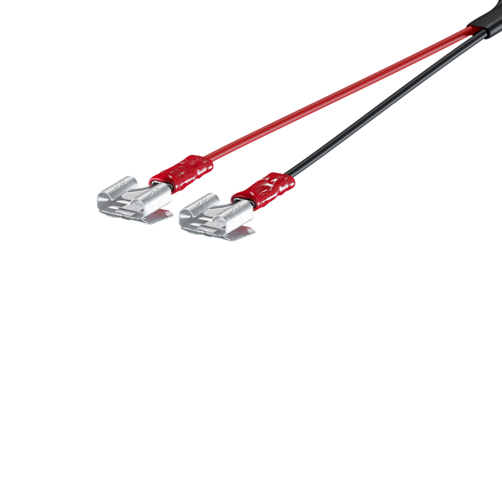

  • Two flying cables
