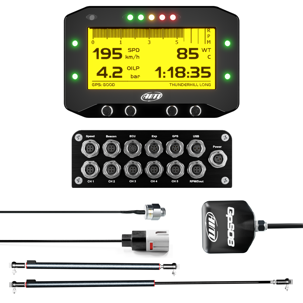

AiM Ultimate GS Dash & EVO4S Motorcycle Data Logging Kit
We have put together the ultimate motorcycle data logging kit to help improve your racing performance.
LCD screen | 7 configurable RGB colours |
5 configurable RGB LED shift lights | 4 configurable RGB alarm LEDs |
5 pin 712 male spiral cable | Many options for ECU connection |
Built-in accelerometer & gyro sensor | CAN output |
5 fully configurable analogue channels | 2-speed inputs |
75mm & 150mm potentiometers | Two 712-719 patch leads |
Brake pressure sensor M10-0-100 bar | One 712-719 patch lead |
GPS module 1.3m | |

The GS Dash
The AiM GS-Dash is a compact, flexible and fully configurable graphical display showing data sampled by our EVO4S.
This dash is small in dimension, which makes it particularly suitable for motorbikes. It features a five-pin binder 712 male spiral cable, which will enable you to connect your EVO4S with minimum effort.
The GS-Dash can be backlit in one of seven available colours. It also features an ambient light sensor that makes brightness and contrast ideal in all light conditions.
The GS-Dash is compact in structure and features a wide 268x128 pixel display to maximise readability.

The EVO4S Data Logger
The AiM EVO4S is a powerful and flexible data logger equipped with a 1.3m GPS Module. Offering one connector per channel, the EVO4S samples all the information you need, data coming from your bike ECU via the specific bike cable you have selected, from the internal accelerometers and gyro and the GPS Module included in the kit.
From analogue/digital inputs, external expansions as well as predefined math channels. Sensors connect to 5 configurable analogue channels, to the RPM input and two-wheel speed inputs.

The Sensors In The Kit
Suspension Potentiometer with pop end fitting: The AiM suspension sensor (linear potentiometer) is a type of position sensor. They are used to measure displacement along a single axis, either up and down or right & left, and suitable linear potentiometers are a contacting type of sensor which means that the moving parts contact each other during use.
This kit comes with two potentiometers a 75mm and 150mm, both also come with a 712-719 1 meter patch lead.
Brake Pressure Sensor M10 0-100 Bar: The AiM M10 - 0-100 Bar brake pressure sensors have a male four pins black 719 binder plug connections to suit all AIM loggers and dash display/loggers.
Whether your bike is equipped with single, dual, fixed or adjustable master cylinders, adding brake pressure sensors allow you to monitor brake performance, make fundamental changes and identify issues quickly and precisely.
This kit comes with an M10 0-100 bar brake pressure sensor and a 712-719 1 meter patch lead.
GPS Module: The AiM GPS technology represents a true revolution in data acquisition. With our GPS software, you can immediately get lap times and all the data needed for improving your driving performance and technique.
The GPS module connects via a CAN cable which makes it quick and simple to install.
The GPS09 Module guarantees precision and reliability, working with almost twenty satellites to improve its performance.
An average of less than one-meter tolerance will determine the position when the finish line is close to another track segment.
The satellite signal is rapidly locked, meaning that the GPS Module is ready to operate after switching on.
No risk of missing signals anymore due to noise or interferences on the system.
On the track
GPS technology represents a true revolution in data acquisition. Thanks to the lightweight and waterproof GPS Module and its GPS Manager software, you can immediately get lap times and all data needed for engine tuning and improve driving technique.
The GPS Module is fast in satellite signal acquisition and reliable in adverse situations. GPS Manager allows you to track start/finish lines and splits and download a comprehensive track database. With the GPS Module, you get essential information, i.e. chassis analysis, track position, position, speed, cornering in-line and lateral G and automatic lap times.
This kit comes with a 1.3 meter GPS module.
- GS Dash:
- Display Resolution: 268 x 128 pixels
- Backlight: 7 configurable RGB colours
- Ambient light sensor: Yes
- Shift lights: 5 configurable RGB LEDs
- Alarm LEDs: 4 configurable RGB LEDs
- Display pages: Fully configurable
- Body: Aluminium
- Pushbuttons: Metallic
- Dimensions: 127.8 x 82 x 22.2mm
- Weight: 380g
- Waterproof: IP65
- EVO4S Data Logger:
- ECU connection: CAN, RS232 or K-Line to 1,000 industry leading ECUs
- External modules: GS Module, Channel Expansion, TC Hub, Lambda Controller, SmartyCam HD
- Anolog inouts: 5 fully configurable, max 1,000 Hz each
- Digital inputs: 1 ( 1 Amp max)
- Internal platform: Internal 3 axis ±5G accelerometer + 3 axis gyro
- Internal memory: 4 GB
- Connectors: 13 Binder connectors
- Body: Anodized Aluminium
- LEDs: 1 system status
- Dimensions: 130 x 35 x 46.6mm
- Weight: 330g
- Waterproof: IP65
- GPS Module:
- Dimensions: 64.8 x 53.2 x 19.7mm
- Weight: 60.5g
- Brake Pressure Sensor M10 0-100 Bar:
- Supply: 8-16V
- Accuracy: < +/- 0.5% FS (CLNH – combined non-linearity and hysteresis)
- Output signal: From 0.5V to 4.5V
- Characterisation: 500mV/ O bar 4500mV/ 100 bar
- Temperature working range: from -20°C to 135°C
- Sealing: IP65
- Housing: 316 stainless steel
- Weight: 30g
- Cable length: 400mm
- Tread: M10
- For all other technical information please refer to the Technical Sheets in the Download Tab.
- EVO4S Data Logger
- GPS09 Module 1.3m
- GS Dash
- Potentiomter 75mm & 150mm
- Brake Pressure Sesnor M10 0-100 Bar
- 3 x 712-719 Patch Leads
