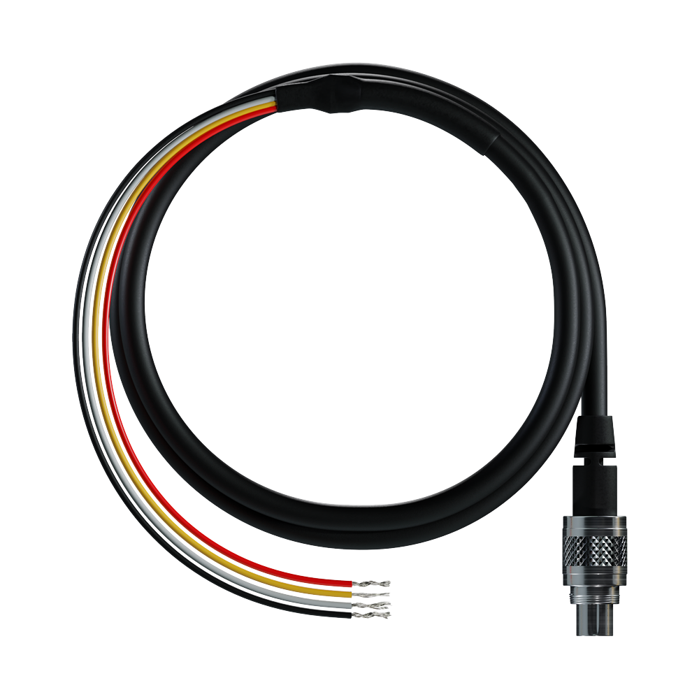

    This Aim adaptor has been designed to supply RPM signals to an Aim EVO4 data logger on vehicles without an ECU.
    Suitable for EVO4 logger For older vehicles
    Aim RPM Coil Adaptor For EVO4 - ARP04
    This Aim adaptor has been designed to supply RPM signals to an Aim EVO4 data logger on vehicles without an ECU. It connects to the coil and filters the signal, reducing noise and generating the correct square compatible with the EVO4 logger.

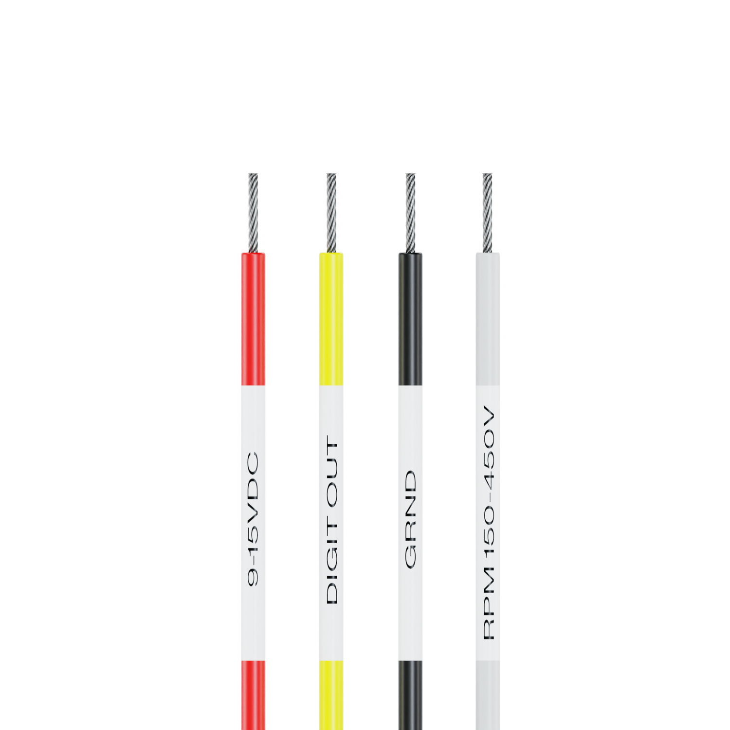

    Connecting The RPM Coil Adaptor
    Connect the cable that ends with a five-pin binder 712 male connectors to RPM input of EVO4
    Connect the black cable labelled GND to vehicle reference ground
    Connect the red cable labelled 9-15 VDC to a switched 12V power supply
    Connect the white cable labelled RPM 150-450V to the coil earth trigger
    The yellow cable labelled DIGIT OUT is EVO4 digital output
