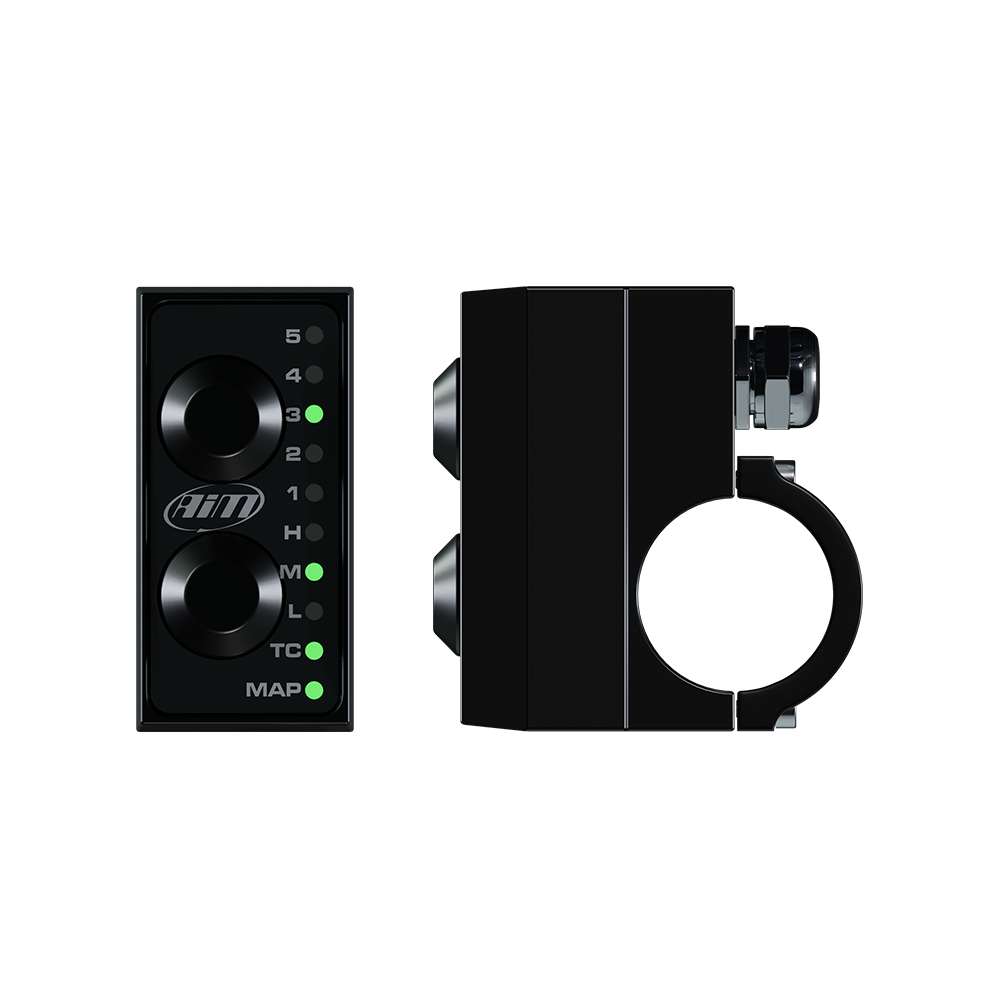

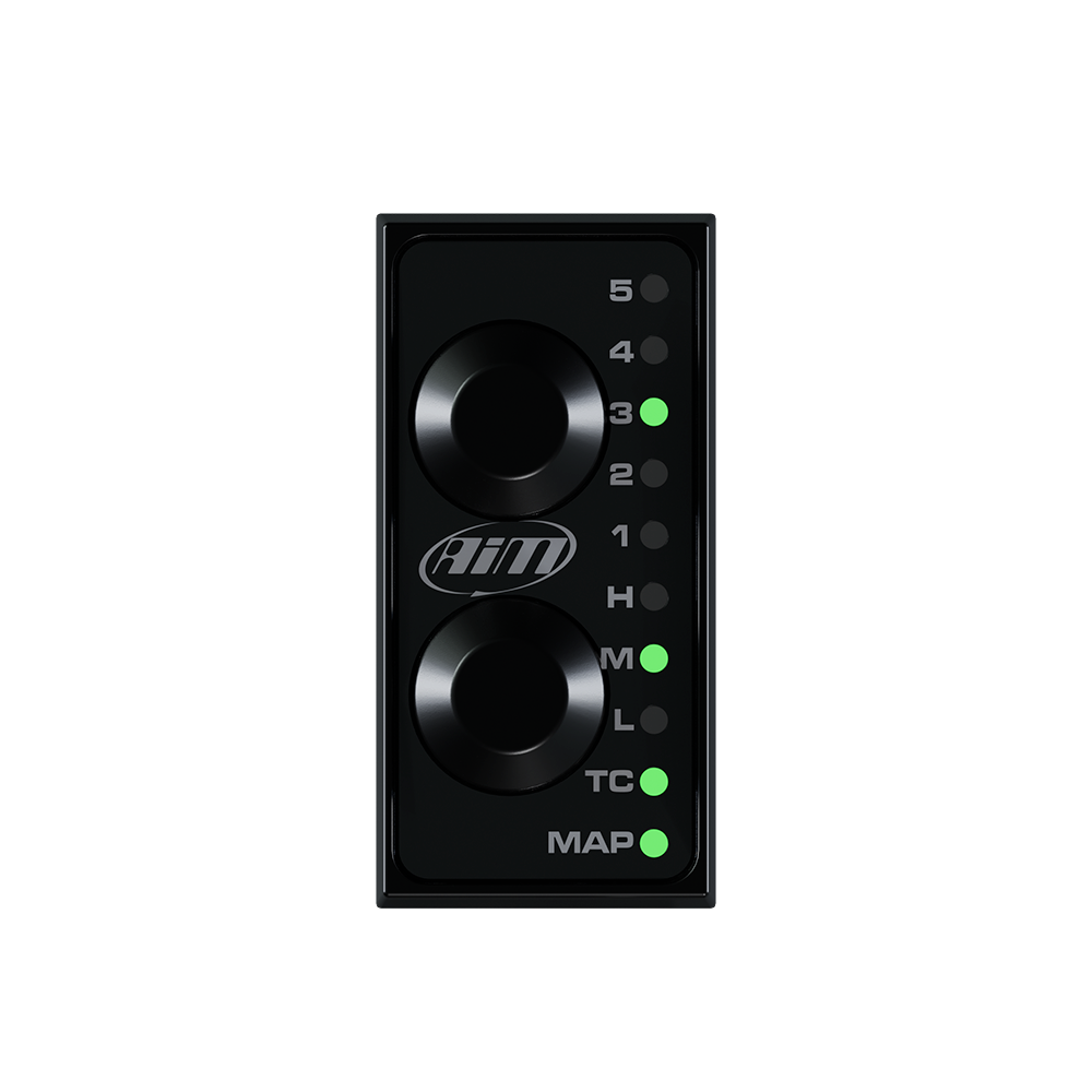

Aim Handlebar Switch
The Aim Handlebar Switch is the best way for changing the behaviour of your bike; it features 2 pushbuttons, 10 LEDs and manages the following settings :
