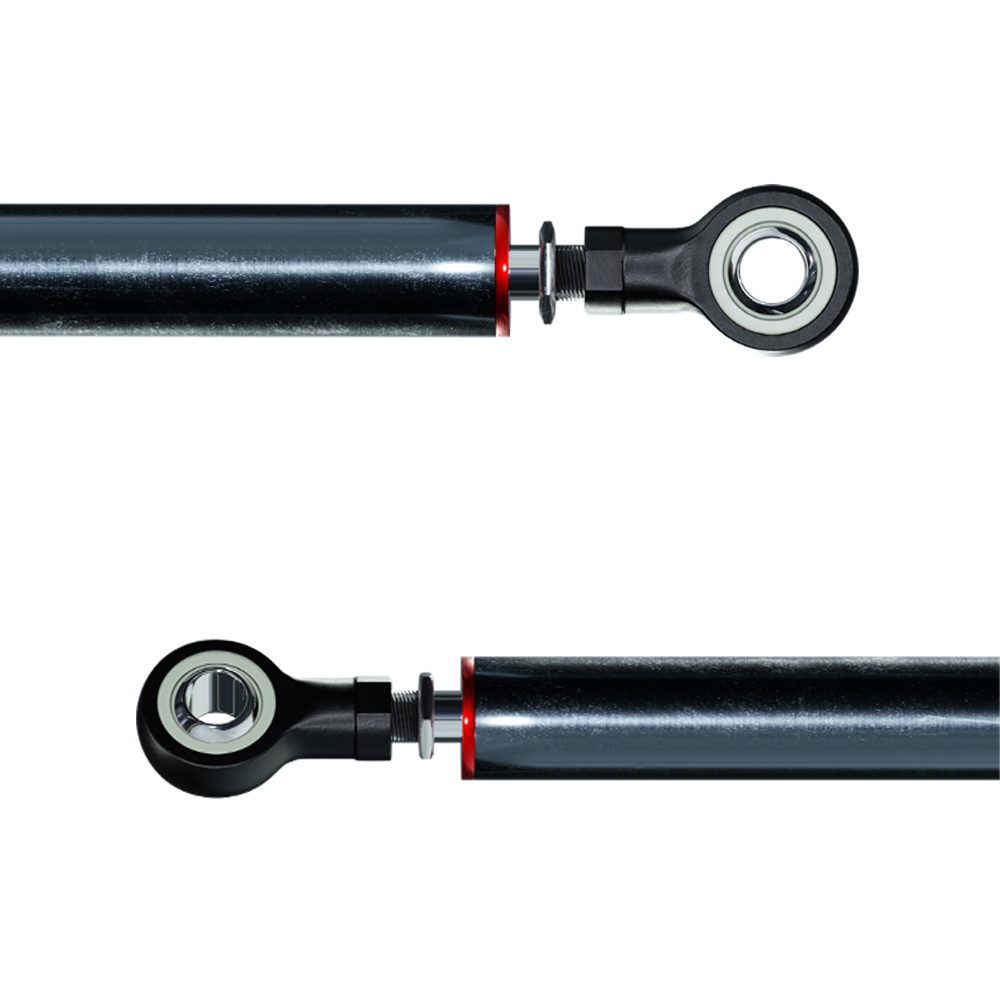

The potentiometer is required to measure the displacement between two points using a sensor ( linear potentiometer) directly connected to the points of measure.
Ideal for logging suspension or steering 719 connection plug
Large selection available
Suspension Potentiometer Rose Joint Fitting
It suits all AiM loggers and dashes display loggers.
We offer a range of sizes for the potentiometer: 50mm, 75mm, 100mm, 150mm
This potentiometer can be used to measure linear displacements like:
Suspensions and spring cushions compression or extension.
Steering column rotation measured through the rack displacement.
Shock and suspension travel.
Ride height.
Wing or spoiler deflection at speed.
As a simple guide, most bikes use 150mm on the front fork, 75mm on the rear shock and 50mm on the steering damper.
Most cars use 100mm on both the front and rear suspension.
