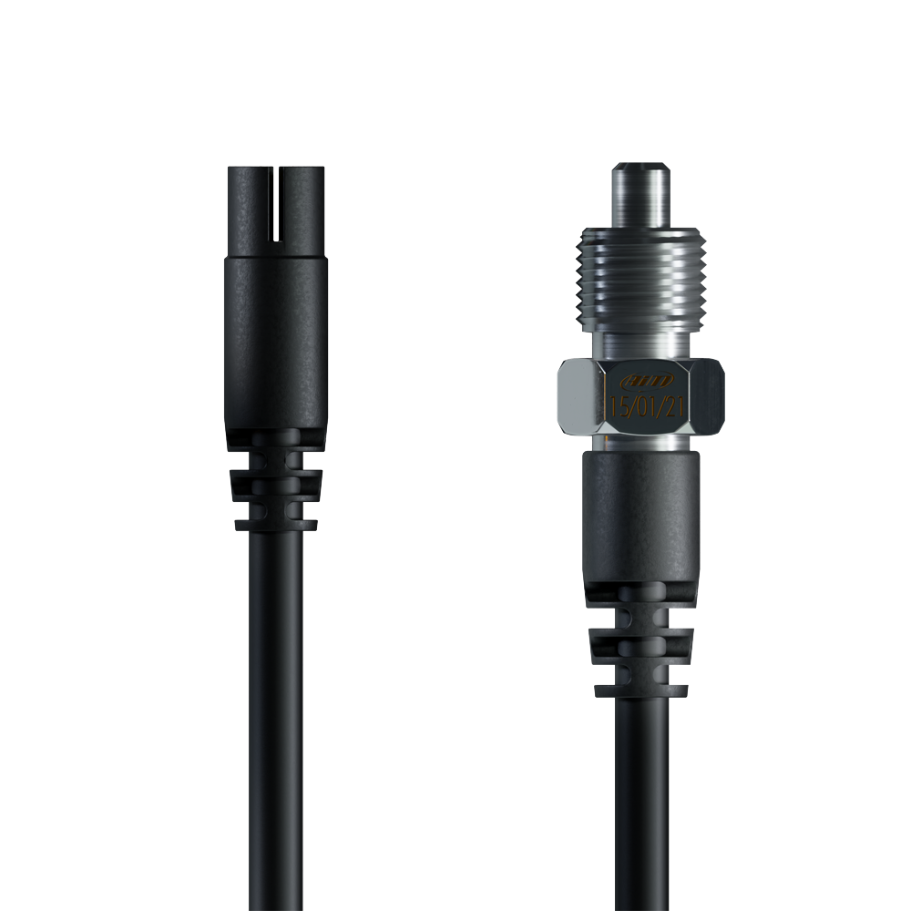

The AiM 1/8th NPT Thermo resistor temperature sensor is suitable for reading water and oil temperatures.
Suitable for water/oil temperature 4 pins 719 male binder
1/8th NPT
AiM Water Temperature Sensor Thermo Resistor 1/8th NPT Thread
The AiM oil/water (coolant) temperature sensor is fitted with a male four pins black 719 binder plug connections to suit all AIM loggers and dash display/loggers. Failure to operate engine or gearbox oil within the correct temperature range can reduce efficiency, reduce power transmitted to your wheels and drastically reduce longevity.
The Thermo resistor must put in the cooling system/oil sump.
It is recommended to install the sensor from heat and electromagnetic interference sources (like RPM cable or lap receiver cables).
The sensor ends with four pins male 719 Binder connector that features a 2kΩ 1% resistor between pins 1 and 4.
Temperature range of 0 - 150 Degrees C
Sensor cable length 25cm
Connections
  • Temperature working range: 0-150°C (32-302°F)
  • Cable sensor length: 25cm
  • 1/8th Thermo resistor
  • 4 pins male 719 Binder connection
  • 2kΩ 1% resistor between pins 1 and 4
