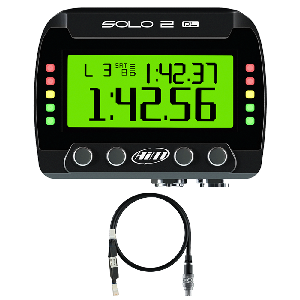

AiM Solo 2 DL is the most precise and simple way to get lap times. Specifically designed for Motocross bikes this aftermarket ECU kit will ensure an improvement in your driving performance.
Direct ECU data logging | Predictive lap timing |
Up to 8 configurable display pages | Integrated GPS & GLONASS receiver |
Automatic track recognition | Internal 4 GB memory |
Wi-Fi connection | 10 configurable RGB LEDs |
Database with more than 4,000 tracks worldwide | Microtec ECU connection cable |
Multiple-use modes: speed, Time, performance | 7 different colour backlights |
This kit has been specifically designed for Motocross bikes. The kit comes with a cable for your bike. Connecting the Solo 2 DL to your bike's ECU will give you all the engine performance information you need to help improve your driving performance.
Plug & Play

- Display: Graphical
- Display Resolution : 238 x 99 pixels
- Display Pages: Up to 8 freely configurable
- Backlight: 7 configurable RGB colours
- Shift lights/alarm LEDs : 10 configurable RGB LEDs
- Integrated track database: Yes
- Inertial platform : Internal 3 axis +5G accelerometer + 3 axis gyro +3 axis magnetometer
- Wi-Fi connection: Yes
- GPS: 10 Hz
- ECU connection: CAN, RS232 or K-Line to thousands of industry-leading ECUs
- External power: 12 V

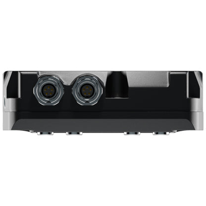

- Connectors : 1 socket (binder) 712, 5 pins, 1 socket (binder) 712, 8 pins
- Memory: 4 GB
- Battery type: Rechargeable Lithium
- Pushbuttons: Metallic
- Dimensions : 98.0 x 73.7 x 30.2mm
- Weight: 249g, battery included
- Waterproof: IP67
