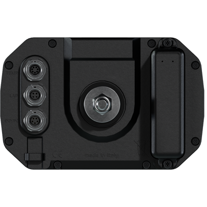

With this kit, the MyChron 5 S 2T features 2 temperature sensor inputs, which can be used to measure the following, water temperature, "under spark plug" cylinder head temperature (CHT) or exhaust gas temperature (EGT). The number of temperature inputs is the only difference between the MyChron 5S and the MyChron5 S 2T.
The MyChron5 S 2T is supplied with one sensor, choose between M10 Water Temperature Sensor, M5 Water Temperature Sensor, Cylinder Head Temperature Sensor (CHT) (Underplug), M5 Exhaust Gas Temperature Sensor or T12 Exhaust Gas Temperature Sensor (Rotex, X30, OK).
The optional second temperature sensor is connected directly to the dash using the supplied dual/splitter patch lead. This patch lead is suitable for fitting 1 x Exhaust Gas Temperature Sensor (EGT) or 1 x Cylinder Head Temperature Sensor (CHT) and 1 x Water Temperature Sensor.
Please Note: For other sensor configurations you will need to purchase an alternative patch lead. If you require further sensors these can be added using our MyChron Expansion Module - See the accessories tab.

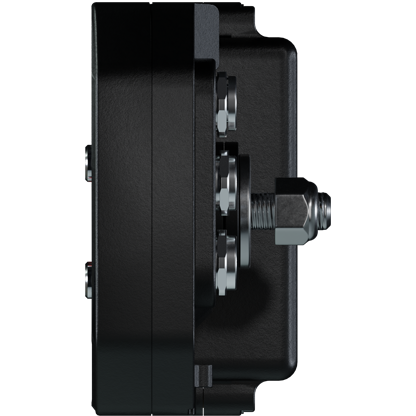

- GPS: 25HZ
- Inertial Platform: Included
- Display Resolution: 268 x 128 pixels
- Backlight: 8 configurable RGB colours
- Ambient Light Sensor: Yes
- Multifunctional LEDs: 5 RGB LEDs
- Alarm LEDs: 2 configurable
- RPM Sampling Frequency: 50 HZ
- Body: Glass fibre reinforced nylon
- Pushbuttons: Metallic
- Battery: Rechargeable Lithium
- Memory: 4 GB
- Dimensions: 137 x 88 x 30mm
- Weight: 390g
- Waterproof: IP67
