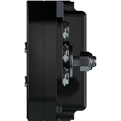

The AiM MyChron5 S 2T Data Logger with two temperature inputs is our game-changing piece of kit for thrill-seekers and competitive kart racers, on scaled-down circuits and professional tracks, all you need to do is arrive and drive.
Integrated 25Hz GPS | Two temperature inputs |
8 configurable RGB backlights | 2 configurable Alarm LEDs |
Integrated GPS | 5 RGB LEDs configure for each gear |
Fully configurable | Choice of sensors |
MyChron5 S 2T x2 Thermocouple Sensor Inputs
The latest version of the AiM Mychron5 S 2T has landed. Our game-changing datalogger has been specifically designed for Kart racing whether you're on a scaled-down circuit or a professional full-sized motorsport circuit for thrill-seekers and competitive races this is the datalogger for you.
With this kit, the MyChron 5 S 2T features 2 temperature sensor inputs, which can measure the following, Cylinder Head Temperature (CHT) and Exhaust Gas Temperature (EGT). The number of temperature inputs is the only difference between the MuChron 5S and the MyChron5 S 2T.
The optional second temperature sensor is connected directly to the dash using the supplied dual/splitter patch lead. This patch lead is suitable for fitting two thermocouple sensors, Cylinder Head Temperature Sensor (under plug), M5 Gas Exhaust Temperature sensor, T12 Exhaust Gas Temperature Sensor.
Please Note: For other sensor configurations you will need to purchase an alternative patch lead. If you require further sensors these can be added using our MyChron Expansion Module - See the accessories tab.
The GPS frequency has improved from 10 to 25Hz and the precision and accuracy have been improved from about 5 feet to 2.
With integrated GPS this system takes advantage of our global track database, to automatically understand which track you're at. When you get to the track switch on your MyChron 5 S 2T and it will determine its position, identify the track and start/finish line coordinates. Even the predictive time is much more reliable. Thanks to the GPS you will know the exact time gap vs your best lap.
The MyChron5 S 2T kart lap timer features a high-resolution graphical display with a built-in 25Hz GPS to sample and record lap times. The MyChron5 S 2T combined with a choice of water temperature sensor and RPM connection makes it the ultimate karting lap timer.
The MyChron5 S 2T logs and stores speed, lap times (including split and predictive), gear, temperature, RPM as well as data coming from the optional sensors when connected to the MyChron Expansion Box, such as throttle position sensors, brake and position sensors, steering angle sensors and the LCU-One Lambda Controller and SmartyCam which are available in our accessories tab.
With this kit, you can choose a cylinder head temperature sensor (CHT), M5 exhaust gas temperature sensor or a T12 exhaust gas temperature sensor. Only one supplied.
The MyChron5 S 2T has seven display colours to choose from. This will enable you to have a clear view and easily read numerical readouts on the track such as your lap times and lap timer, RPM and two temperature values. When you're back at the paddock you can scroll through all your data on the display.
The Nylon chassis and metallic pushbuttons guarantee even more resistance to shock and water, while the anti-scratch non-reflecting polycarbonate screen and wider display offer great readability.
The MyChron5 S 2T also features an ambient light sensor providing optimum viewing in diverse lighting conditions, the display brightness is automatically adjusted according to the environment light.

- GPS: 25HZ
- Inertial Platform: Included
- Display Resolution: 268 x 128 pixels
- Backlight: 8 configurable RGB colours
- Ambient Light Sensor: Yes
- Multifunctional LEDs: 5 RGB LEDs
- Alarm LEDs: 2 configurable
- RPM Sampling Frequency: 50 HZ
- Body: Glass fibre reinforced nylon
- Pushbuttons: Metallic
- Battery: Rechargeable Lithium
- Memory: 4 GB
- Dimensions: 137 x 88 x 30mm
- Weight: 390g
- Waterproof: IP67
