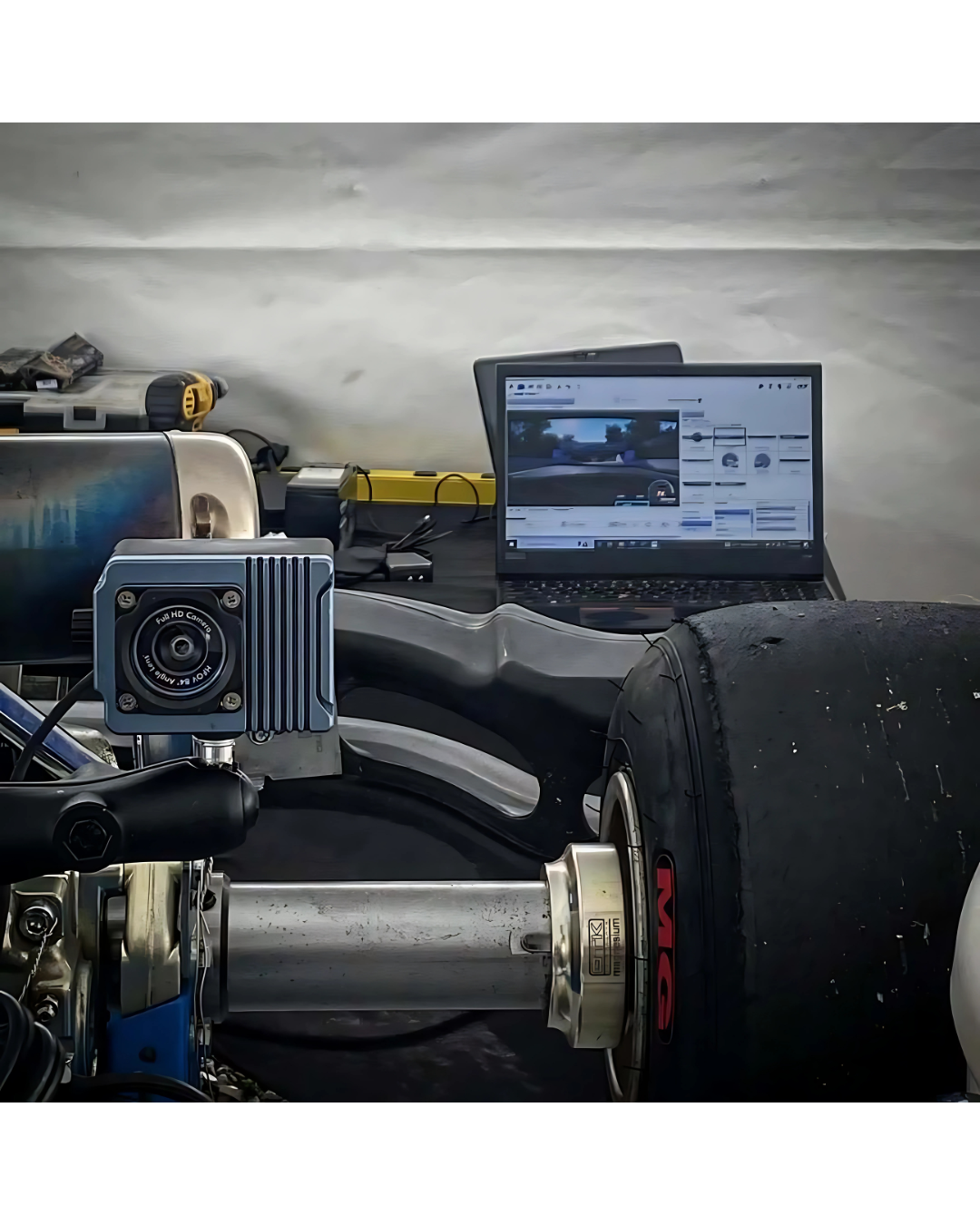

Setting up your SmartyCam is straightforward, and this quick guide will walk you through each step; highlighting the small differences between our models to make sure you're fully prepared for your next session.

Step 2: Open Race Studio 3
Next, insert the SD card into your PC and open Race Studio 3. Your device will appear under the connected hardware list - labelled according to the model you own (e.g. SmartyCam 3 Corsa). From here, you’ll be able to carry out three key tasks:

In the overlay editor, you can reposition display elements like RPM, speed, gear, lap times, and predictive delta. You can also add custom elements such as team logos, throttle position bars, or engine temperature, all from the available CAN data stream.
When you're finished, click Save, then make sure to click Transmit to send the configuration to your SD card.
