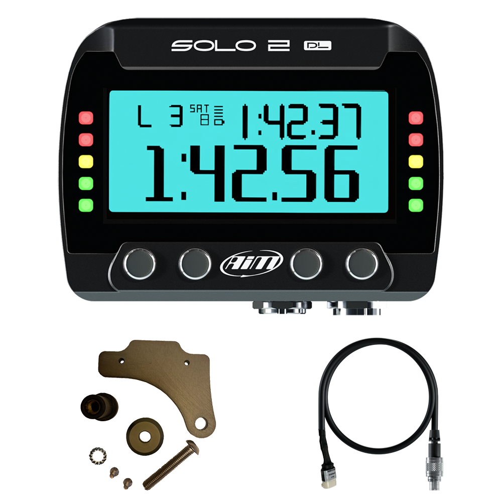

  • Solo 2 DL: A data logging lap timer that handles an ECU input with a CAN expansion port that you can connect a SmartyCam to.
  • Bike Plug & Play Cable: The kit comes with a specific cable to connect the Solo 2 DL to the bike model that you have selected to relay all vital ECU information.
  • Brake Pressure Sensor: Brake pressure sensors are used to measure how much force is applied by the rider to the brake. When combined with suspension potentiometers, you can get a greater understanding of your bike setup.
  • Suspension Potentiometer: Measures the travel of the suspension forks on your motorbike to understand your suspension setup.
  • ACC (Analogue CAN Converter): Adds four freely configurable analogue/digital channels without occupying or modifying the existing system channels.

The Solo 2 DL has a sharp, high-contrast display which helps sailors easily identify the data displayed on screen, as well as 8 different backlight colours.
The Solo 2 DL allows you to create a new temporary or permanent track layout too. Even if there is no map already, the device will create one for you.

The Solo 2 DL calculates, displays, and records lap times, sector times, position & vehicle speed, with a sampling rate of up to 25Hz, and 3D acceleration & gyro. This allows you to see your exact racing line, compare it to optimal lines for faster lap times, track the motorcycle's movements and provide detailed data on acceleration, braking, and cornering forces.

  • Display: Graphical LCD
Integrated Track Database
  • Over 4,000 worldwide
  • Wi-Fi Connection: Yes
  • GPS: 25Hz
  • External Power: 9-15V
  • Memory: 4GB
  • IP67
