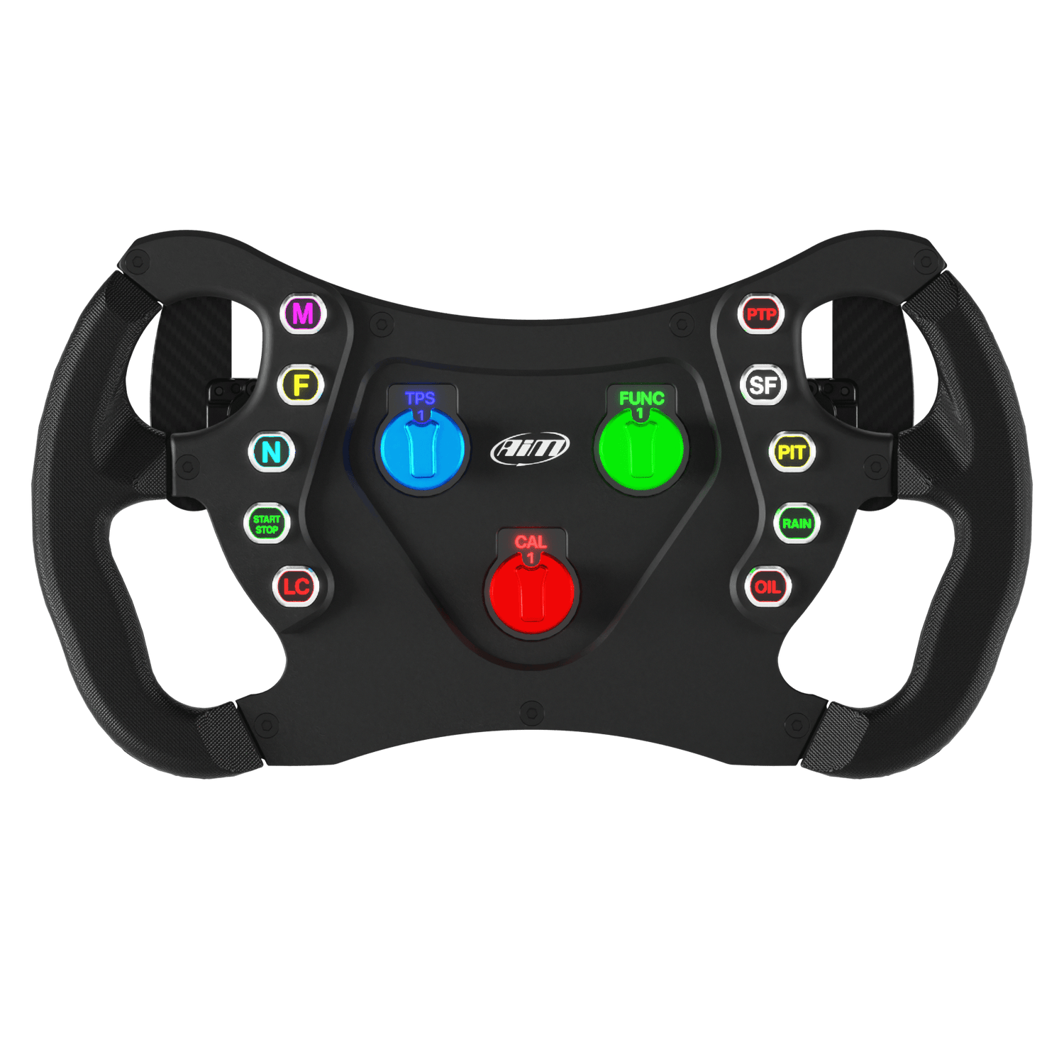

 GT32 Steering Wheel
Electronic Steering Wheel
Main Features
GT32 steering wheels transmit in a freely configurable CAN connection the status of 8 pushbuttons and 3 rotary switches plus more 2 pushbuttons in free contacts connections. It features also 2 (optional) carbon fiber paddle shifters with a precise magnetic system.
Highlights
Buttons and rotary switches
  • Reconfigurable
  • Momentary, toggle and multi-status
  • 2 pushbuttons in free contacts
RGB LEDs
  • Programmable
  • Frames and icons backlighted
  • Continuous + 2 blinking mode
Other Features
  • Paddle shifters (optional):CAN messages and free contacts
  • Connection: ECU CAN
  • ON/OFF feature: Status restore option
Choose your GT32 version
EXPANSION
GT32 steering wheel is available as expansion for PDM32/08 Power Distribution Module, another effective device for a complete AiM electronic system.
STANDALONE
GT32 is also available in completely standalone version that can be connected via CAN to every EVU and masters.
Custom backlighting
RGB LEDs can be managed through math channels according to the status of the pushbuttons and/or the feedback coming from external devices. They can be solid or blinking at a desired frequency and at the preferred light level.
Pushbuttons configuration
The RGB LEDs behind all 10 pushbuttons plus back-lit multi-position switches are designed to instantly find the right input in the heat of competition.
Every single LED can be fully programmed via Race Studio 3; they can work as momentary, toggle or multistatus and each option can be configured depending on the length of time the button is pressed or on other conditions according to specific needs.
Every single LED can be fully programmed via RaceStudio 3; they can work as momentary, toggle or multi-status and each option can be configured depending on the length of time the button is pressed or on other user-predetermined conditions according to specific needs.

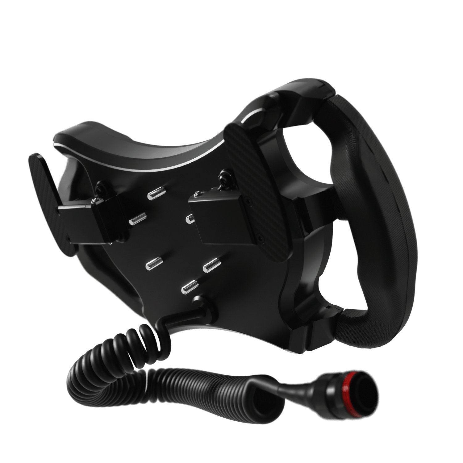

CAN Output
The data stream of each button can be managed in the CAN output. Through this function you can customize once more your own configuration setting up each detail:
  • Number of bytes allocated
  • Data length code
  • Byte order
  • Frequency from 1 Hz to 100 Hz
CAN messages configuration
The status of the pushbuttons is transmitted at fixed frequency or/and when it changes. The CAN messages as frequency, IDs, baud rate, endian and contents can be freely configured. The status of every pushbutton at the power OFF can be hold at the next power ON. GT32 Standalone can manage a CAN INPUT protocol, in order to give a feedback, trough the color LEDs, based upon the information received.

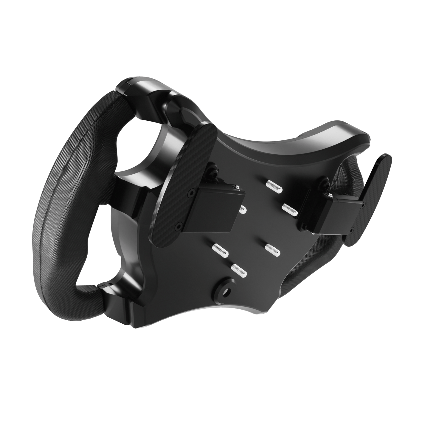

Precise and solid shifting
The new (optional) magnetic carbon fiber paddle shifters guarantee high accuracy and a strong feedback for the shifting, allow downshifting and upshifting with great confidence. Paddle shifters feature free contacts on dedicated pins of the Autosport connector and/or CAN messages communication.

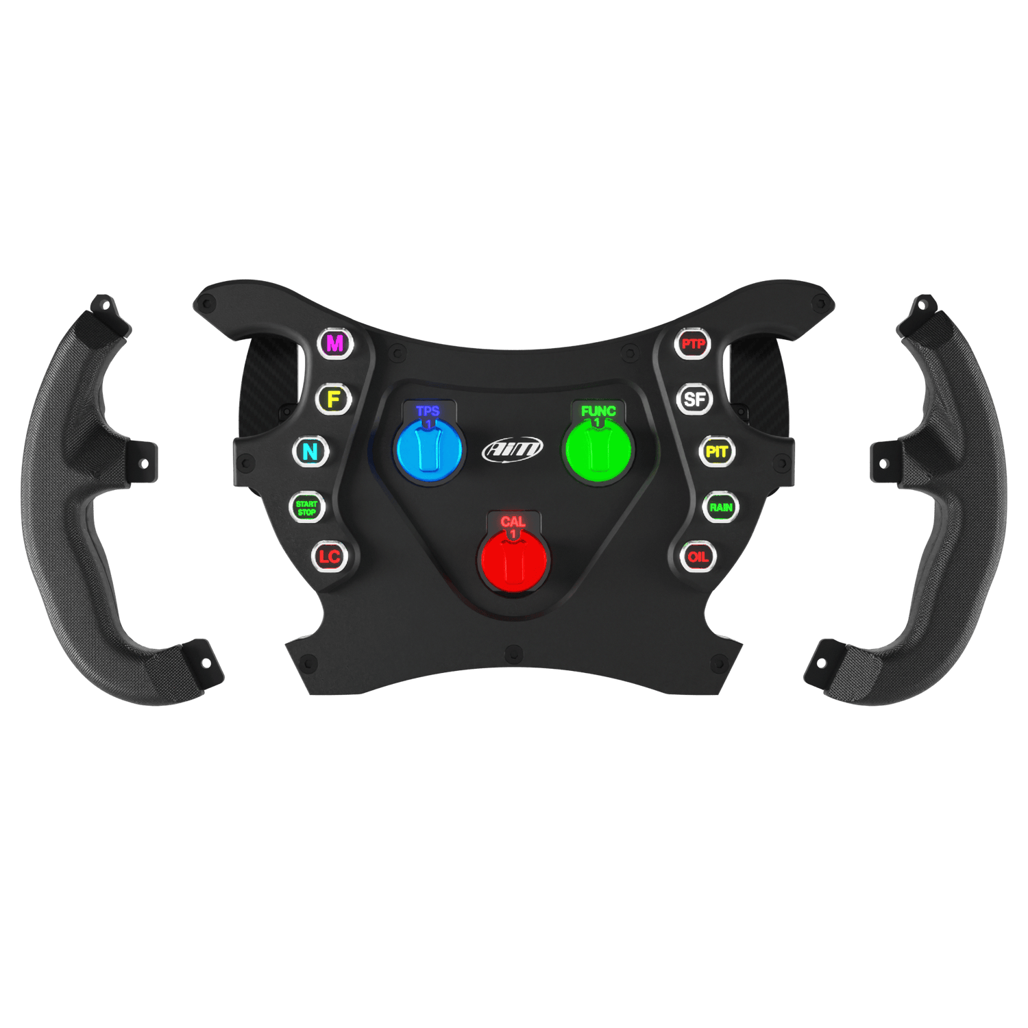

Maximum grip and comfort
The ergonomic handle grips are composed of high-density polyurethane, designed for the best grip and comfort in any situation, and they're fully replaceable.

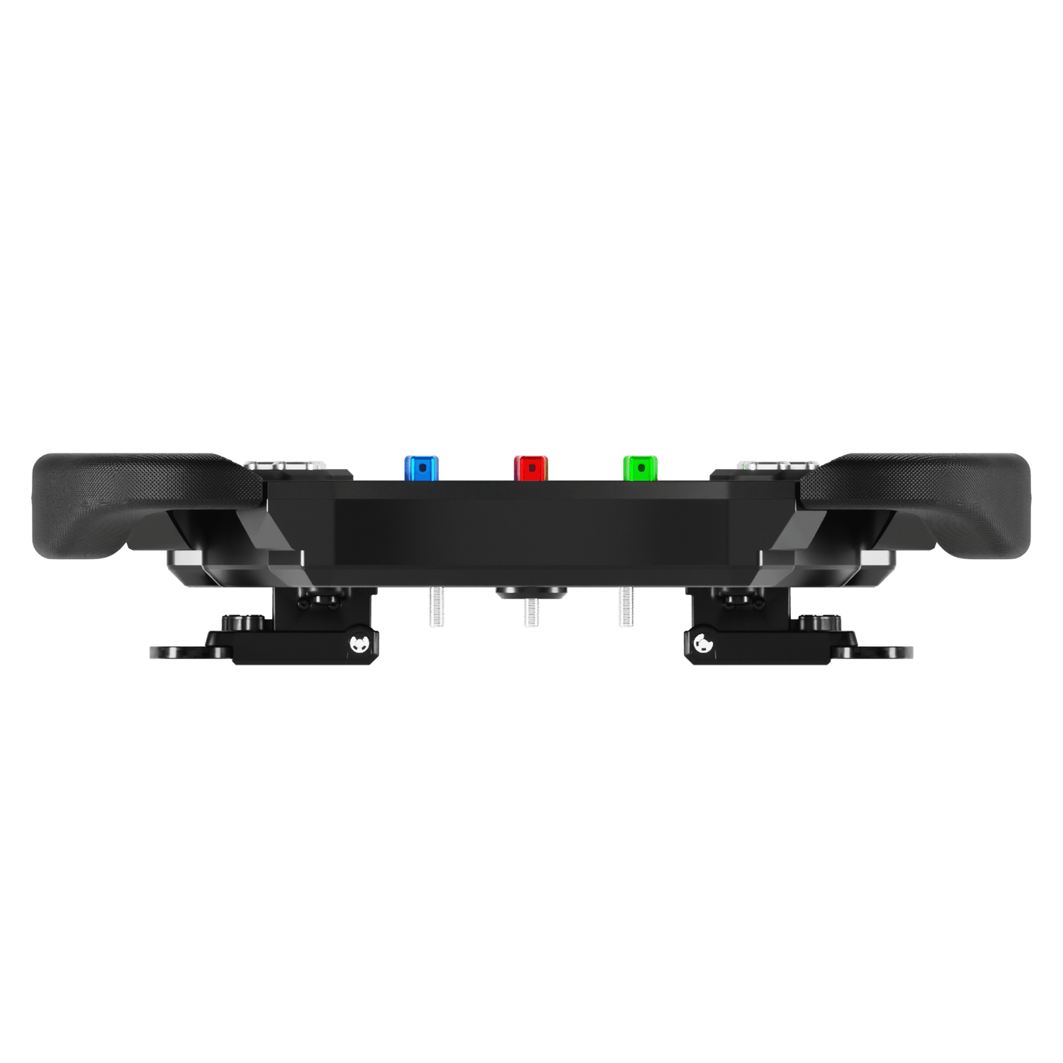

Technical specifications
  • Diameter: 320mm
  • CAN connections: 1
  • Body: Anodized Aluminium
  • Pushbuttons: 8 pushbuttons in CAN + 2 pushbuttons free contacts
  • Rotary switches: 3 rotary switches with RGB backlights
  • Connectors: 1 Autosport 22 pins male connector
  • Dimensions: 320 x 176 x 43 mm
  • Configuration: Standalone: Via USB-C, Expansion: In CAN THrough PDM32/PDM08
  • Paddle shifters: CAN Messages and free contacts (optional)
  • Weight: 2,600g
  • Power consumption: 500mA
  • Waterproof: IP65
