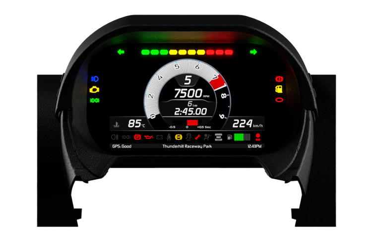

MX2E Lotus dash showing customisable  display and LEDs
The MX2E dash has 2 types of displays, both available with analogue or digital: road or track. There are 16 display layouts to choose from with 4 different colour options, which can be customised to suit your preferences.
There is also a wide range of icons available on the display, allowing you to easily see important information whilst you’re driving: rear fog light, position lights on, ABS on/malfunctioning, ABS off, hand brake, engine off, pressure low, seat belt not fastened, airbag off.
The MX2E dash features a total of 18 solid LEDs: left or right direction indicators, 10 shift lights LEDs and 6 status information LEDs showing hand brake on, fuel level low, immobiliser on, position lights on, high beam on and engine problems.
تحميل الفيديو: Delta times LED display feedback on the MX2E Display
تحميل الفيديو: Integrated shift light array interface and customisable alarms for the MX2E Lotus Dash

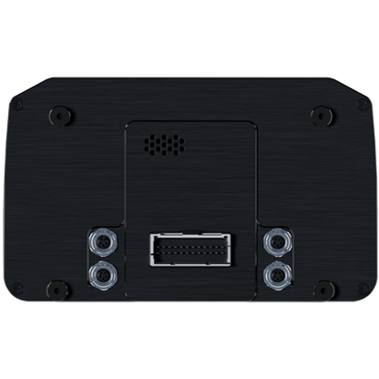

  • Connectors: 1 Delphi 12040722 connector & 4 binder 712 connectors
  • Power Consumption: 400mA
  • Adapter Harness: Elise/Exige model years 2004-2007 (version with airbag only)
  • Dimensions: 191 x 114.2 x 26.4mm
  • Weight: 640g
  • Waterproof: IP65
