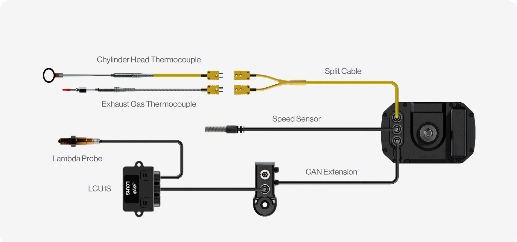

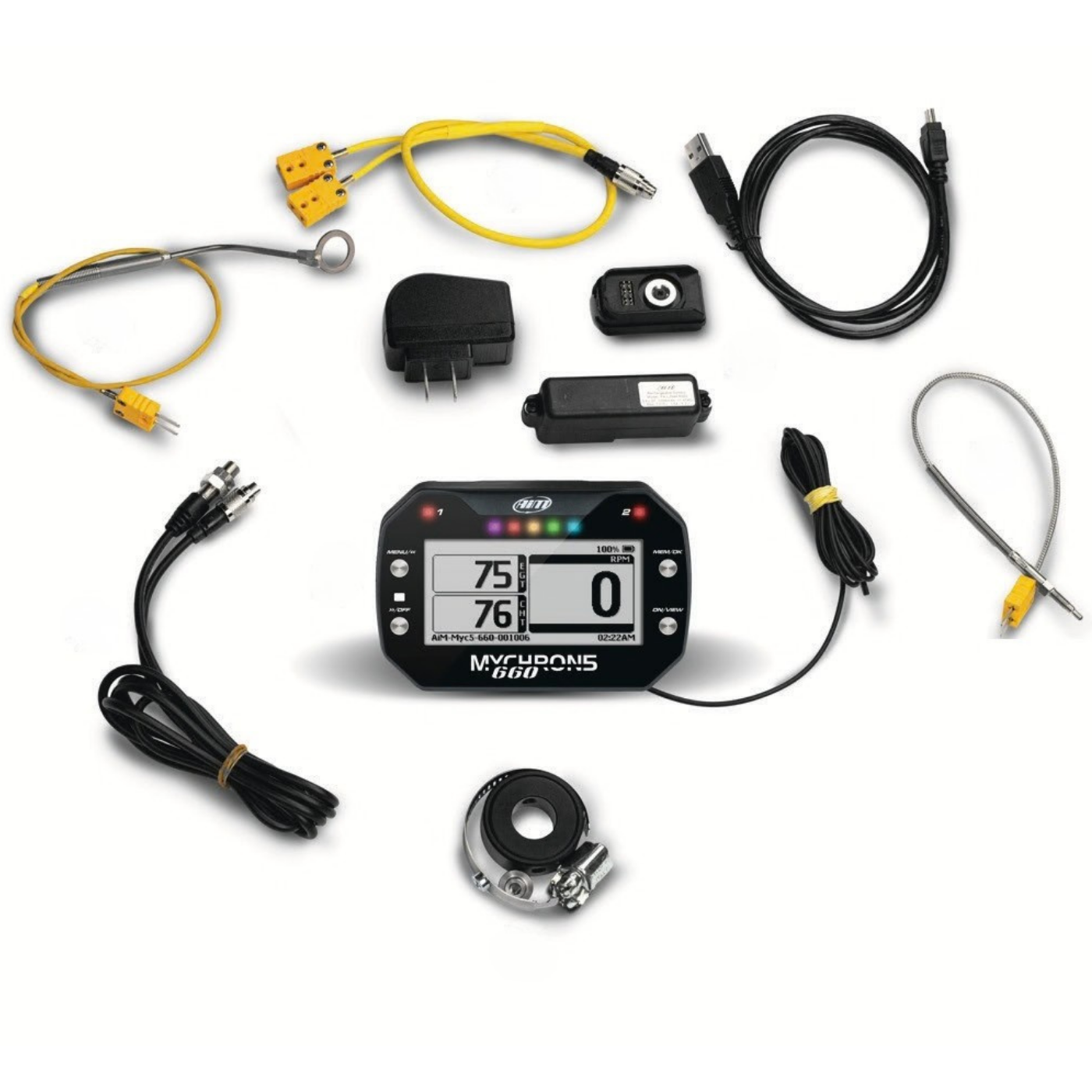

Included Sensors
The MyChron5 660 kit contains 3 sensors to help improve performance:
  • A cylinder head temperature (CHT) thermocouple and an exhaust gas temperature (EGT) thermocouple to accurately measure the EGT, which can both be fitted to the provided dragster thermocouple split cable.
  • A phonic wheel kit and a speed sensor that connects straight into the rear of the logger.

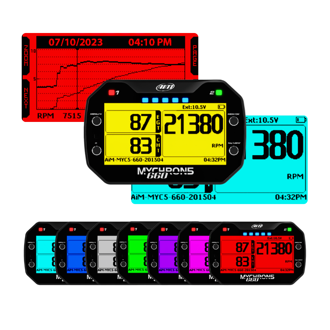

MyChron5 660 8 configurable RGB backlight colours
Configurable Backlight & Alarm LEDs

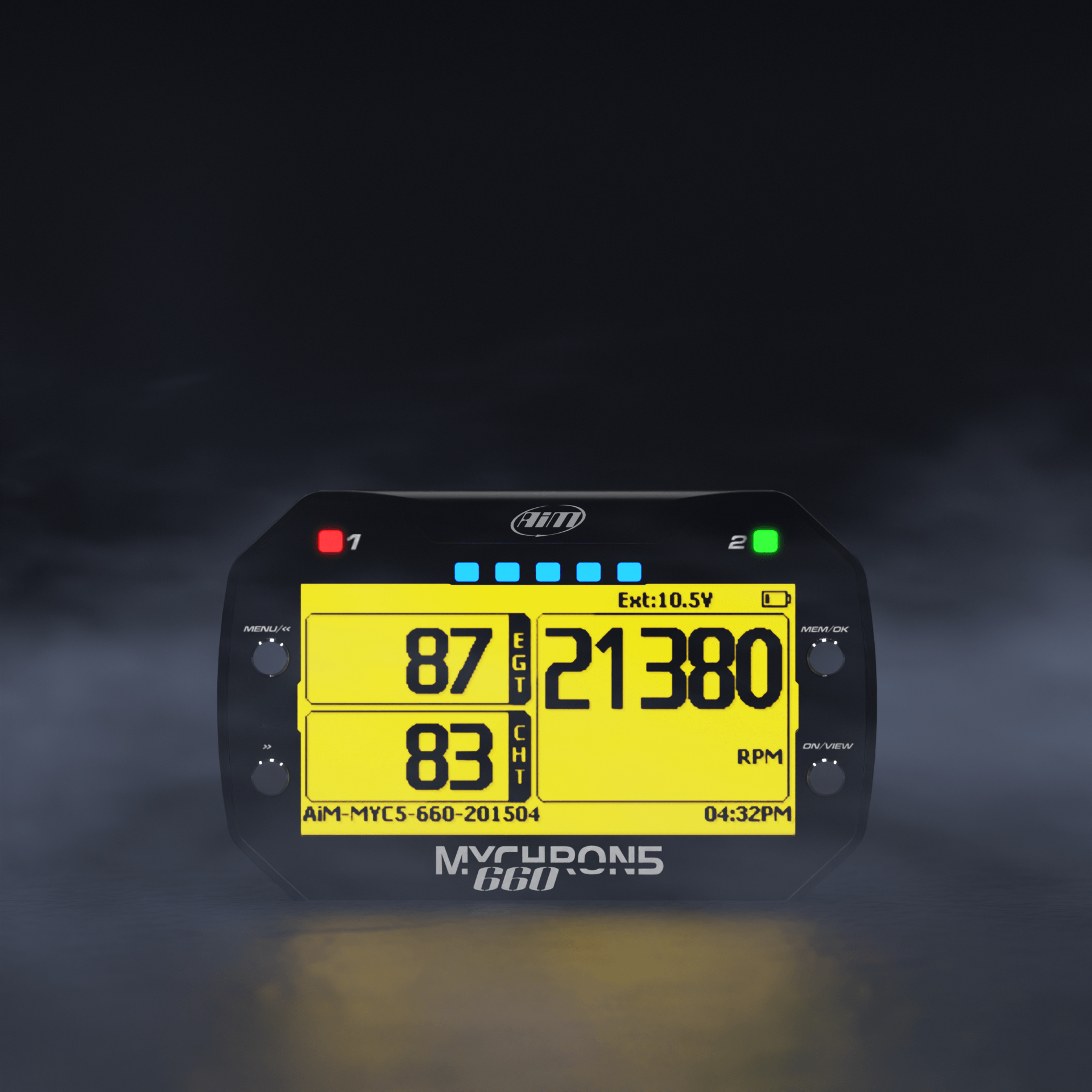

The MyChron5 660 features a high-contrast LCD screen, offering great flexibility and readability while you drive. Choose from 8 configurable RGB backlight colours to suit your requirements. The ambient light sensor switches the backlight ON/OFF according to the ambient light conditions. The MyChron5 660 has 2 RGB alarm LEDs. You can set these to work as a temperature alarm.

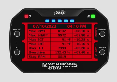

Data Recall
After a test session, it is possible to recall sampled data. Check your test sessions, test summary, selected test values eg, RPM, CHT, EGT, overdrive, or you can view in graph mode.

The LCU-One S allows you to perfectly tune the carburetion of your engine to keep it at its best and improve the engine's performance. Alongside the Analogue CAN Converter, you can choose among 5 different split harnesses. Up to 4 thermocouples or 4 analogue channels 0-5V/0-12V are available.
