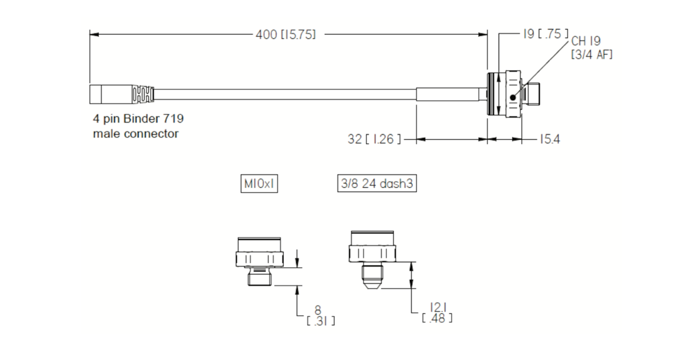

The Aim 0-5 Bar Pressure Sensor is available in M10 and -3 JIC (3/8-24 UNF) thread options and is fitted with a 4-pin 719 male binder connector to suit Aim loggers, dash loggers, lap timers and dash displays. Many aspects affect various engine pressures, so knowing your engine has the correct amount of pressure is paramount to longevity and performance.

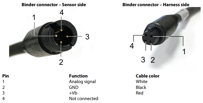

To extend the length between your dash display/logger and the analogue sensor, you will need a 719-719 patch lead, available in various sizes from 0.5m to 4m. For most installations, you will likely need one of these patch leads. However, a 719-719 patch lead is also available for use with the EVO4, EVO4S and Channel Expansion.
  • Supply: 8-16V
  • Consumption: < 10 mA
  • Temperature Working Range: -20°C to 135°C
  • Waterproof Rating: IP66
  • Housing: 316 stainless steel
  • Weight: 30g
  • Cable Length: 400mm
  • Thread: M10 or 3/8-24

Pressure sensor pinout
