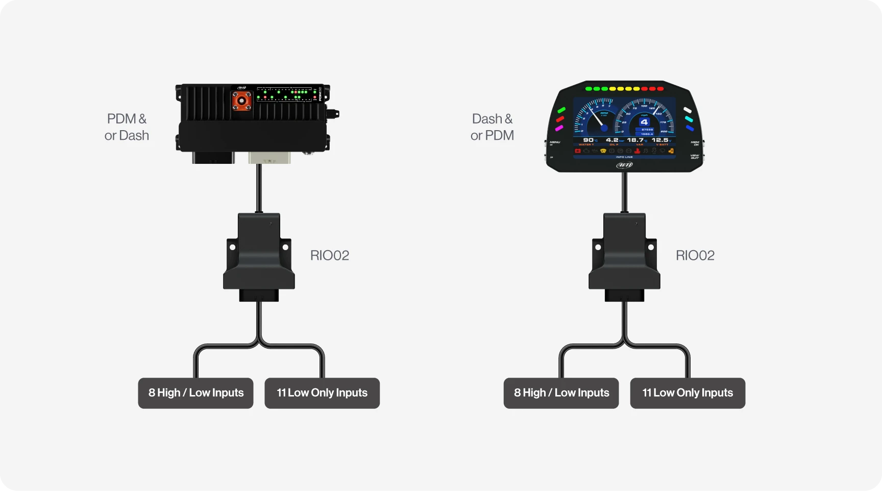

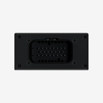

The Aim RIO02 Module enhances control capabilities by providing 19 inputs. It seamlessly integrates with Aim CAN networks for efficient communication and enhanced compatibility.

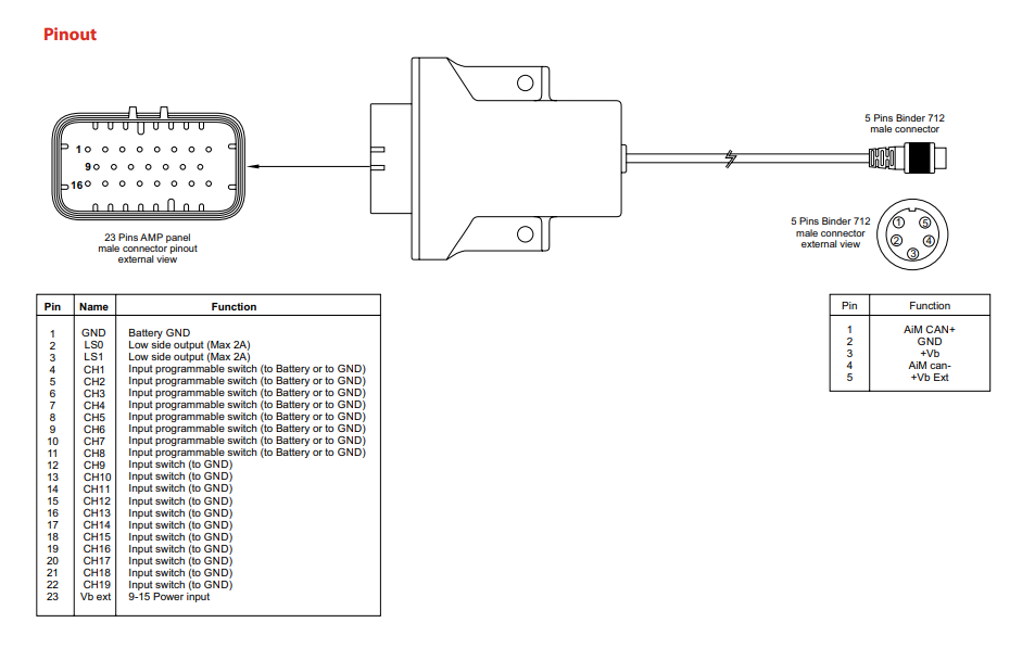

Gain access to 11 dedicated switch-to-ground inputs that provide extensive control options for your system's operation, utilise 2 low-side outputs to expand functionality and offer flexibility in controlling external devices or components, and configure 8 inputs to switch-to-ground or switch-to-battery, tailoring control to your needs with precision and versatility.

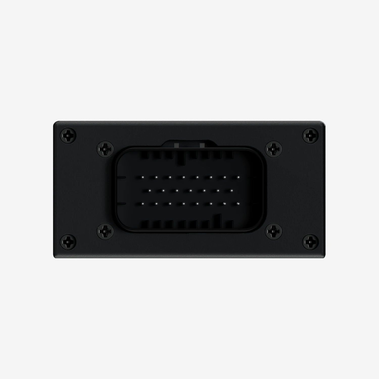

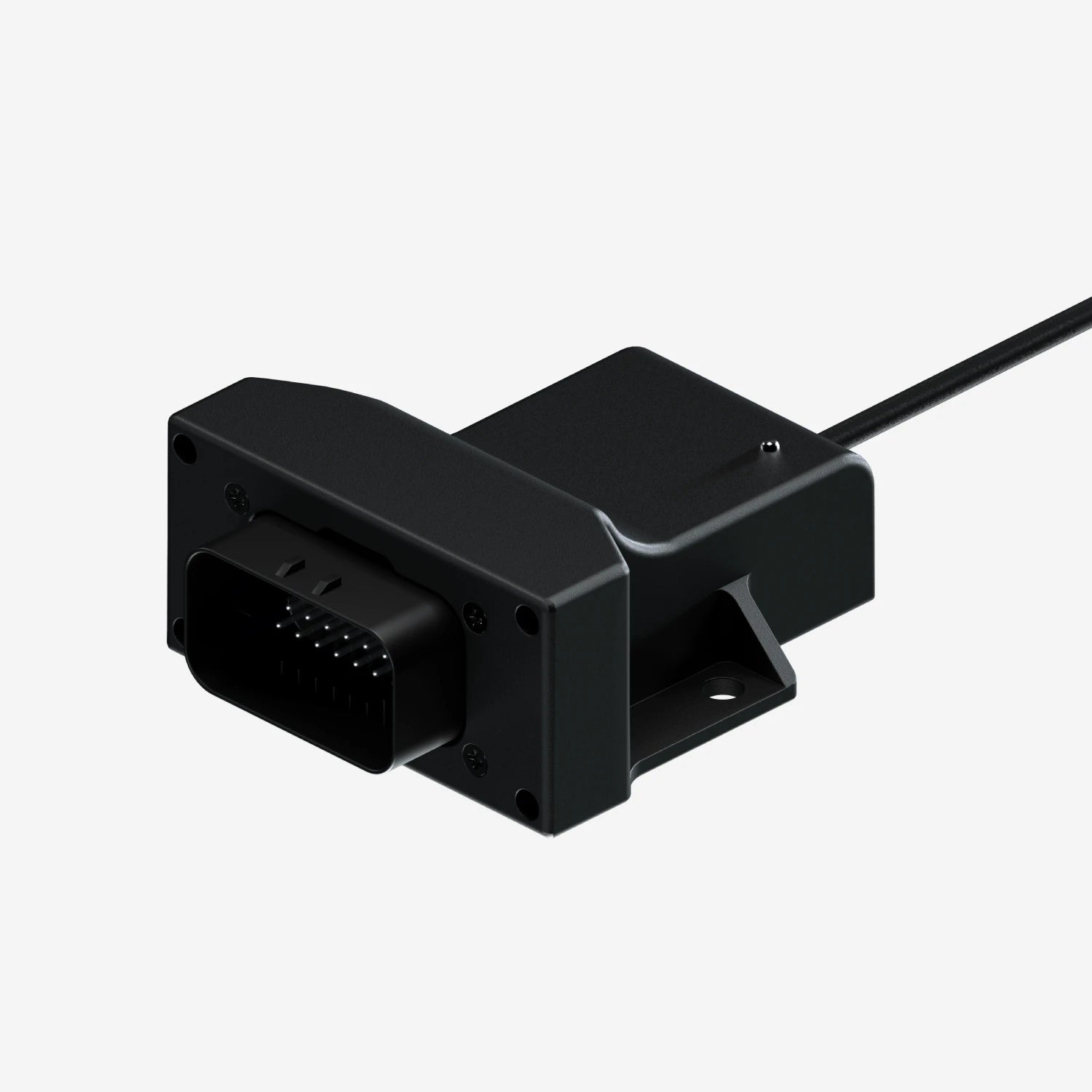

  • CAN Connections: 1
  • 19 Inputs: 8 prog: Switch to Batt, Switch to Ground & 11 Switch to Ground
  • Dig Outs: 2 low side (2A max)
  • Body: Plastic
  • Connectors: 1 AMP 776087-1 connector
  • Dimensions: 99.2 x 80 x 40.1mm
  • Weight: 120g
